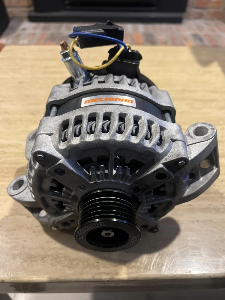

So let me hear about the options, currently the truck is equipped with what may actually be an OEM Motorcraft 95 Amp alternator.
Here's what I've been considering:
Alternator:
My first instinct is to purchase this BBB Remanufactured unit from Rock Auto, it's basically the best deal I can find on a new 130 amp alternator. It's 100 bucks, add 50 for shipping, taxes, and duties, and it's still the cheapest at 153. There's options for 115 Amp units, but with future additions to the truck it'll be important to have some breathing room.
I could also pull an alternator form the nearest junkyard would be 80-90 dollars, it's pretty easy to identify the 115-130 amp units from their design and size, but I'll be honest I've never had any luck with used alternators, still just by going to look I could maybe find an upgraded unit, or at least one of the 130-135 amp units for a bit less money.
The evil little monkey in my brain says to buy this 320 AMP Mechman alternator that someone is selling used in an Ontario group, they want 700$ for it though, and its overkill, AND it'll probably increase drag on the motor impacting fuel economy, but frankly if I do end up successfully adding an electric AC compressor, and electric power steering, among other goodies it might actually come in handy. I could maybe talk the guy down to 600$ CAD, still a big ask.

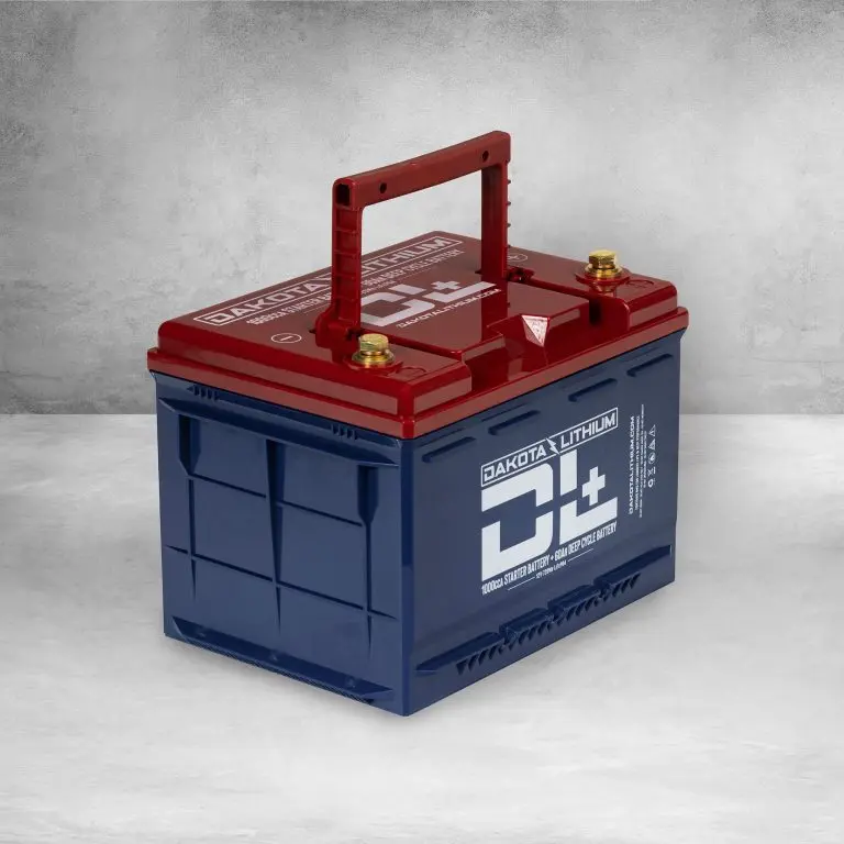

Battery:
Option 1, I could maybe get away by attempting to recondition this one, I've never really done it before, but who knows maybe I can get some more life out of it yet. Still, I would like to have the assurance of more capacity and overall battery health.
Option 2, buy whatever cheap new battery is around. This is gonna cost 175$ on the light end, up to 250-300 on the heavy. When it comes to lead acid, I've rarely if ever noticed a difference between manufacturers. That being said, getting a solid deep cycle/AGM unit with a higher capacity could be a good idea.
Option 3, I do what the evil little monkey says and I spend 640$ CAD one of these: https://dakotalithium.com/product/d...r-starter-deep-cycle-lifepo4-battery-1000cca/
These are slick units, and 641$ Canadian for one is a good deal. Still, it's a 600$ car battery. However, it would shed 20lbs off the truck which is always a plus, have ultra consistent power, 1000 CCA, and basically triple usable power compared to a normal lead acid unit thanks to a better depth of discharge, and a 60AH Capacity. They also say they last up to 11 years. This is one of those "End Game" parts for the build that I would like to buy no matter what, but it'll be underutilized right now. Still, I'm genuinely considering it.

i would go with the larger alternator, the 115 or 130 amp one.
and you can still rebuild that one you have. keep it as an emergency back up unit.
if you are bored, you can find some junkyard alternators that you just change a diode inside and you have an onboard welder. you could fix stuff that breaks on the side of the road with that.
I've never tried to rebuild an alternator before, would probably be a good thing to know how to do honestly.
I had heard about folks doing that trick in the way back but never considered doing it. I wonder if I change a diode inside that 320 Amp unit I'd have a plasma cutter lol
Well shit boys, doing my research we found that the Dakota Lithium may not be able to survive an upgraded alternator.
From the Dakota Lith. website:
"CHARGE VIA ALTERNATOR
Drop in replacement for lead acid and AGM starter batteries for vehicles. NOTE: THE DL+ 60Ah IS LIMITED TO AN ALTERNATOR CHARGING PROFILE OF 80 AMPS OR LESS."
There's also the matter of the batteries performance under -20F, in the depths of the winter months I'd either have to build a capacitor unit to start the truck. Or simply just switch to standard lead acid unit for the winter.
I was about to caution you on that. Lithium batteries require a compatible charger and unless they have a built in heater, don't like the cold all that much.
Even with a house battery, an AGM or deep cycle might be a better choice because of the cold. Lithium is lighter, supplies power better, lasts longer, and usually can be discharged lower, usually but like anything else, has their down sides you have to consider.
I wouldn't run a lithium battery in a cold climate.
I work in constriction, and our drill batteries flat out won't charge if it's much below 40°f. Our truck idles alllllll winter long to charge batteries in the cab off of an inverter.
I knew the Lithium batteries were gonna struggle in the cold to charge, I think the main thing making me decide against it is the fact that it can only take 20 amps of charging regardless of temperature.
I had the idea of basically having a summer and winter battery, but given the expense it's just not feasible to be honest.
