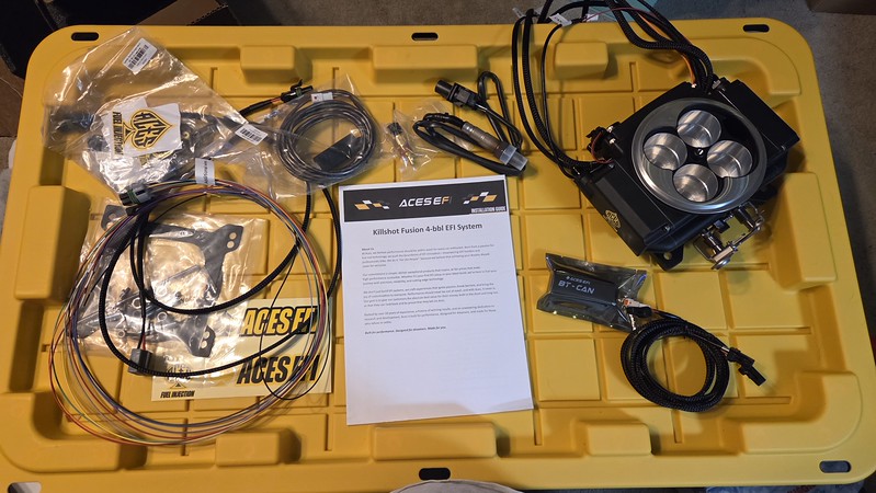

EFI kit is here!

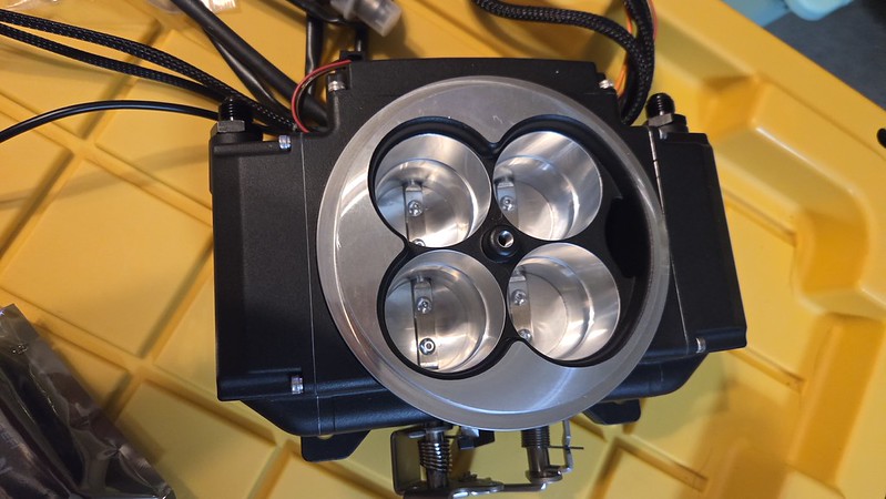

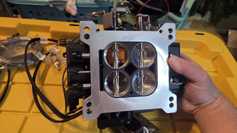

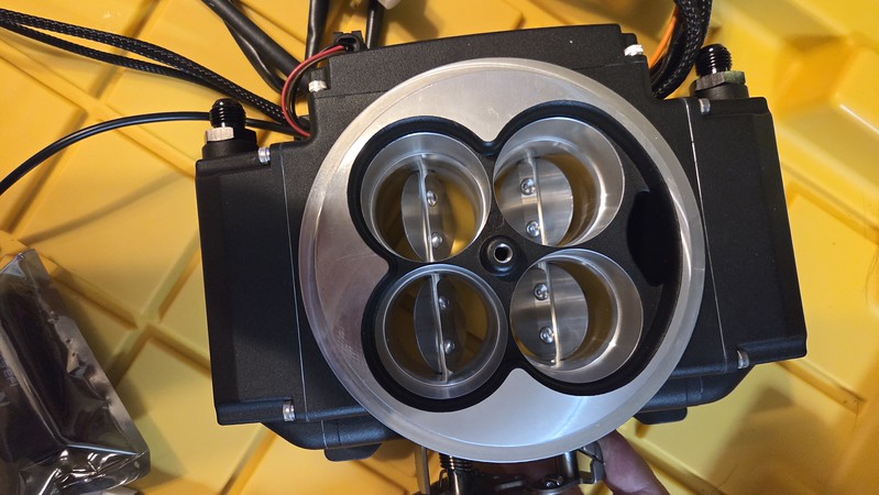

Machine work looks nice
Aces Killshot Fusion EFI Swap

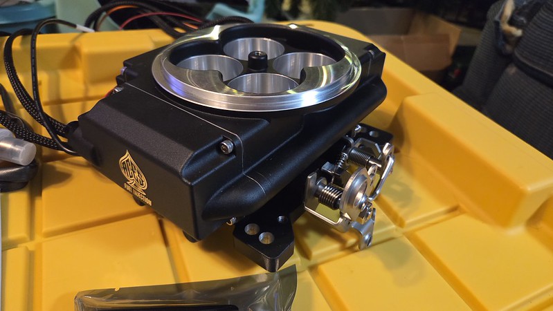

It has a progressive throttle. Kind of like my carb the fronts open first but they are more linked to the rears, having them both open opposite directions makes for a cool visual effect.

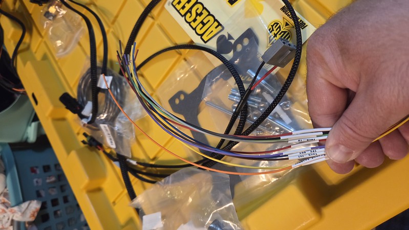

The wires that need attached to other things area all clearly marked

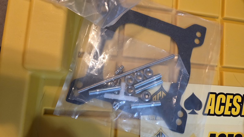

Has a baggie with the mounting gasket, I figured it would come with the air cleaner stud but I was mildly impressed it came with mounting studs. I don't think I need more of them but it was nice.

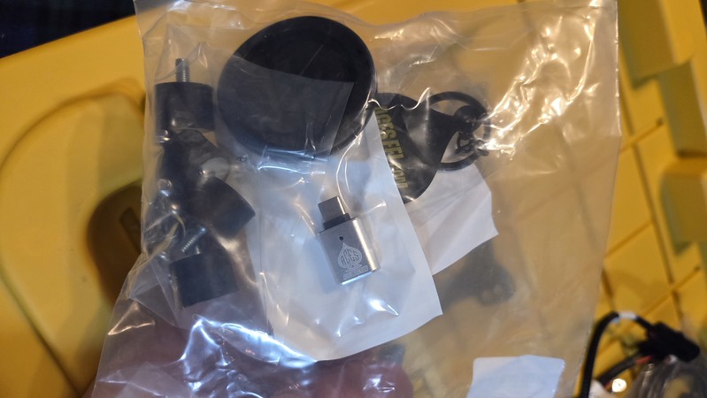

And another bag with a keychain, more stickers, small hardware, firewall grommet/mouse access hatch, and a USB adaptor.

The time is drawing near, I hope to get rolling on this process this weekend.
I think I have pretty much all the parts I will need, not sure how the fittings will play out but there is no way to know here for sure. And here I thought my tote was too big...
