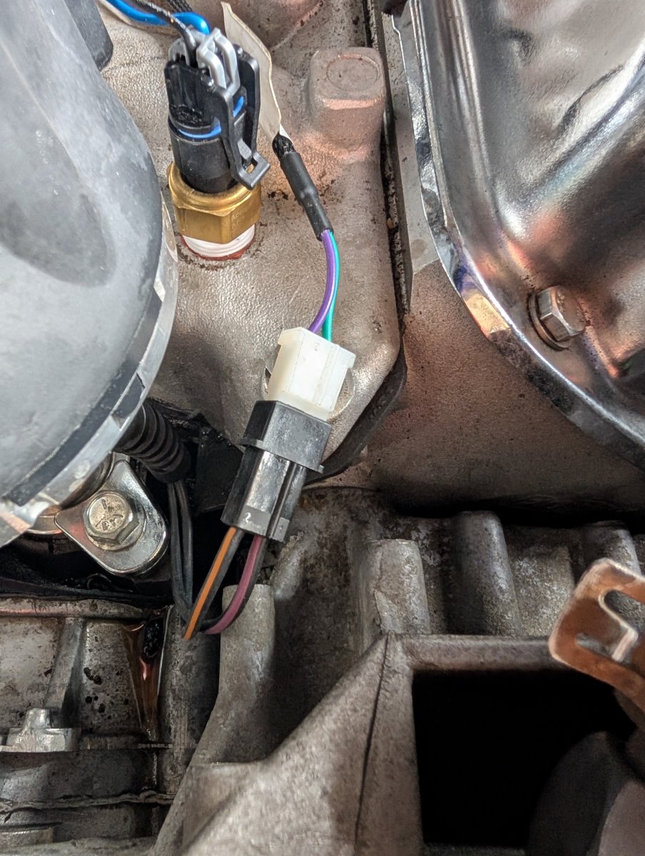

I originally started with an RTR distributor from Blueprint and converted it to bypass the internal ignition module. You can order connectors for mag pickups that plus into the Aces VR plug. I'm pretty sure it's just an MSD part.
Here is how mine is wired:

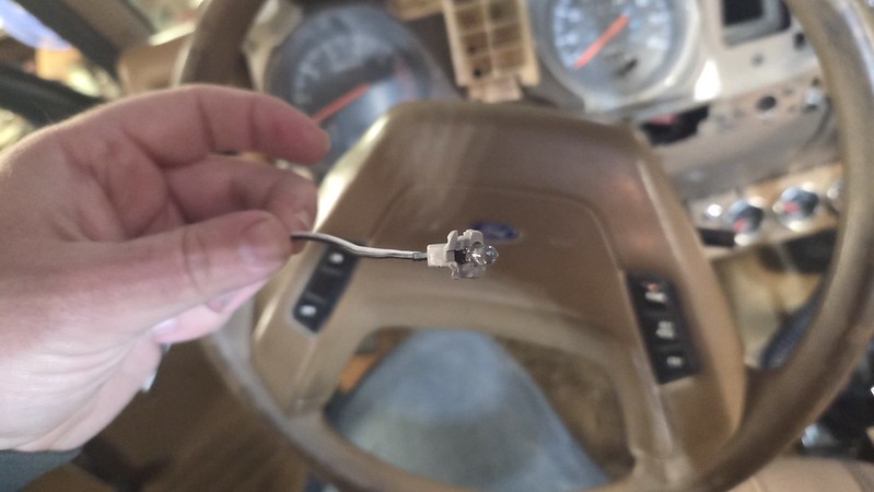

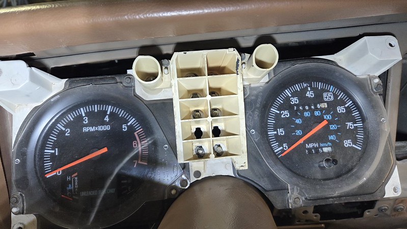

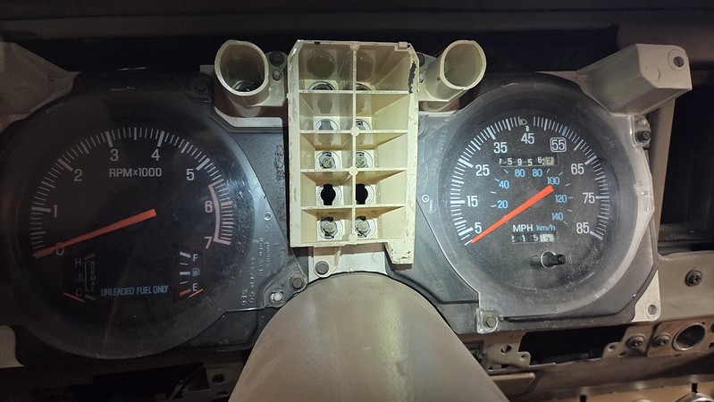

My message center is full of these little twist in bulbs that have a plastic base.
Aces Killshot Fusion EFI Swap
I gently crushed the glass out of the base with my bench vice then softly disemboweled the remains of the bulb and the brass contacts with my leatherman before I drilled a hole in the end of it... and basically converted it to a LED bulb that really does not care at all whatever the cluster circit board is doing. It came out very nicely.
One of these bulbs is not like the others...
It kinda has me curious wanting to get the 4wd lights to work, I might go ahead and make a couple more bulbs and at least get them staged in there for later.

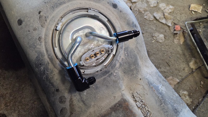

Next I dropped the tank out of it

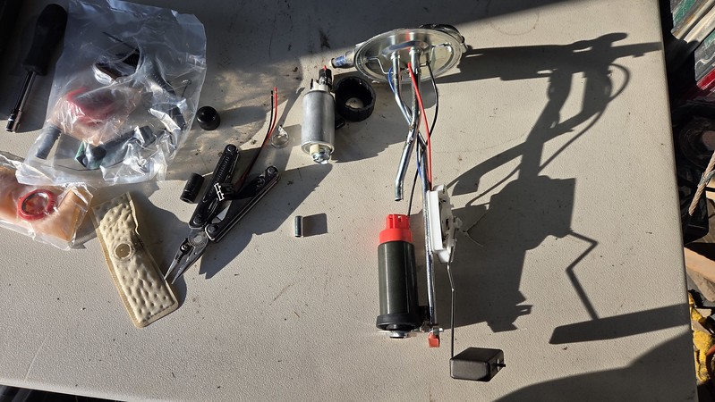

Ripped the fuel pump out of it and tore it apart
I did have to do some grinding and cutting on the pump hanger but I did get the pump to work. I also put power to it and it did move fuel and seemed to run pretty quiet.
Also Kudos to @Uncle Gump for helping get the correct quick adapt fuel fittings
And that is as far as I got...
What exactly did you have to do with the sending unit? I'm looking at the exact same setup soon.
The pump is taller so I had to trim the tube that mates to it. I also had to grind the stamped contour out of the bottom of the hanger bracket so the pickup screen would fit on.
Different brands of fuel pump hangers will probably vary of course.
Then cut and crimp two wires of course.

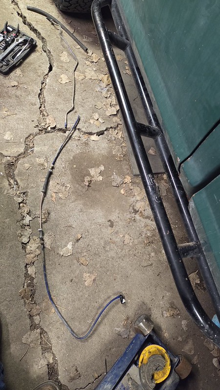

Old fuel line is out as is my spare onboard Holley fuel pump.
It will be nice to have all new fuel line and get rid of this hodge podge thing.
