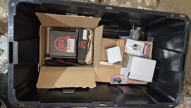

I think I have pretty much all the parts I will need, not sure how the fittings will play out but there is no way to know here for sure. And here I thought my tote was too big...

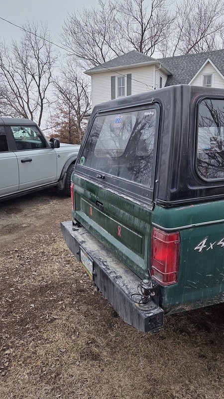

I was going to drive it into my garage and revamp the fuel system first. My door is against one wall so I only really have room on one side of the truck. And then we will have to use a feature I am getting rid of... and use the fuel in the bowls to back the truck out and turn it around and back it in so I have more room to get to the front of the truck for the rest of the conversion. To do aid in this I pulled the spare tire carrier off the back to make the truck almost a foot shorter. It is tempting to pull the grille guard/winch off but I am gong to try not to.

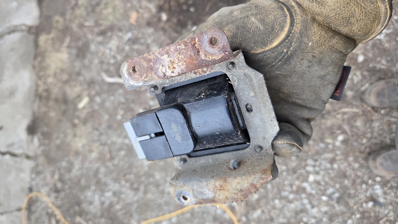

I was initially gong to retain the Duraspark igntion, I decided to just jump to using the built in coil driver that will use the OE style E coil. So I rooted around in the barn and found my bracket. I need to sandblast and paint that yet but we have time.
