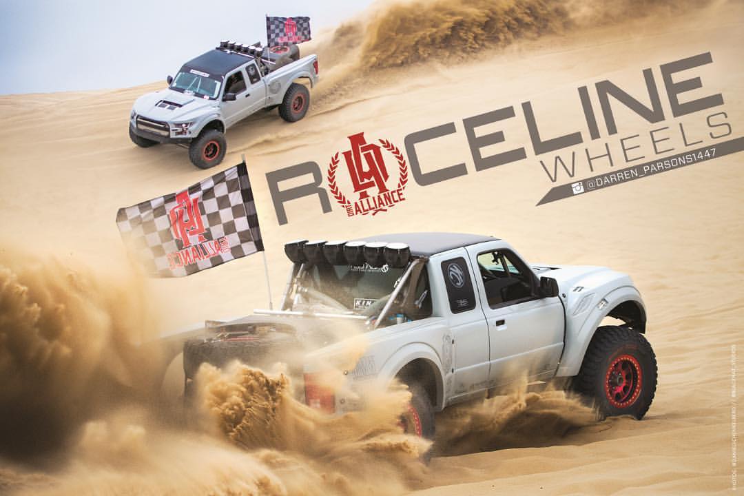

Darren Parsons Ranger Raptor
Darren Parsons posted his Ford Ranger project in our forum back in 2012. A lot has changed since then. Like many projects, they are always evolving.
Looking at this Ranger, it may be confusing as to what it really is. It started life as a 1993 Ford Ranger. It was updated with fiberglass body panels to give it a 2004 and newer look, and then eventually transformed into 2017 Ford Raptor thanks to a one-piece fiberglass front clip, and updated fiberglass bedsides. Note how the body lines from the 2017 Raptor and the Ford Ranger all come together in the new fiberglass. You can get your own fiberglass Raptor kit from companies like McNeil Racing and Fiberwerx, and basically convert your 1983-2011 Ford Ranger in to your own Raptor.
