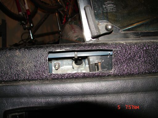

Recently I had been doing a lot of bodywork on the Bronco II in preparation for a paint job. The driver side door was fairly well mangled, and the backing hardware for the folding mirror was bent and I couldn’t get the bolts back in. To re-mount the mirror after the bodywork/paint job, I had to modify the backing bracket from inside the door. The easiest way to access the door interior at this height was to cut this access hole.
Cut hole in door

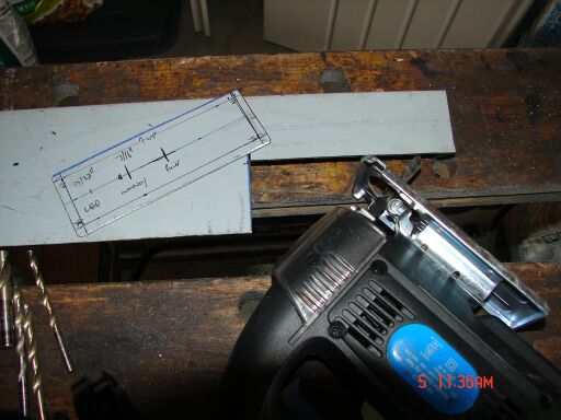

Step 1) First I cut the switch panel with a jigsaw. I used a piece of a scrap desktop PC housing for my metal.
template and jig saw

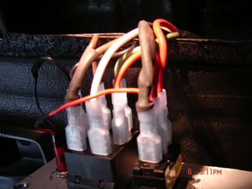

Step 3) I mounted the switches and LED and wired according to the diagram in the above references. I soldered and shrink-wrapped the pigtail splices, but otherwise just used crimp-on female spade connectors. Again, with the guarded power switch that I used, a separate LED indicator wasn’t necessary, but I used it anyway.
Wiring the switch and wiring

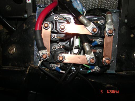

Step 4) At the winch end, I made short leads from the “in” wire (my winch = green), “out” wire (my winch = black), and solenoid ground wire (my winch = brown) and routed them to exit the solenoid pack. To avoid confusion with my black battery ground wire, I used white wire to route to the switch for battery out.
solenoid pack

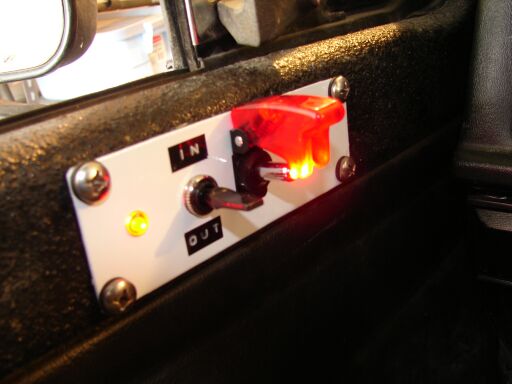

Step 7) I would have painted the panel black, but I was out of both gloss and semi-gloss black. So, I painted it white for now. I might think of more elegant fasteners than the big stainless sheet metal screws. Also, the old school dial-a-labels might get changed out for something a little more professional looking later on.

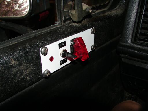

Activated And Ready To Winch
Completed installation
