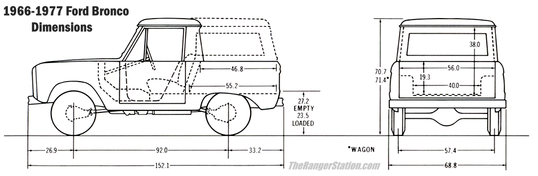

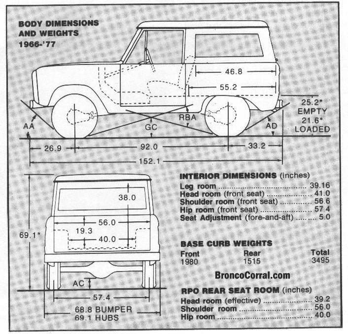

Bronco Size Comparison Chart
| Vehicle | Overall Width | Overall Length | Overall Height | Track Width | Wheelbase |
| 1966-1977 Ford Bronco | 68.5 in | 151.5 in | 71.6 in | 57.4 in | 92.0 in |

1966-1977 Ford Bronco vs 1984-1990 Ford Bronco II
It’s interesting how the 1966 Ford Bronco and the 1984-1990 Ford Bronco II are nearly identical in size.
Compared to the 1966-1977 Ford Bronco, The Bronco II is
- 0.5″ Narrower
- 6.8″ Longer
- 3.4″ Lower
- 0.5″ Narrower Track Width
- 2.0″ Longer Wheelbase

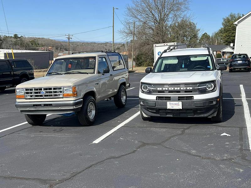

2021 Ford Bronco Sport vs 1984-1990 Ford Bronco II
Compared to the 2021 Ford Bronco Sport, The Bronco II is
- 6.3″ Narrower
- 11.8″ Shorter
- 0.3″ Lower
- 6.8″ Narrower Track Width
- 11.1″ Shorter Wheelbase
