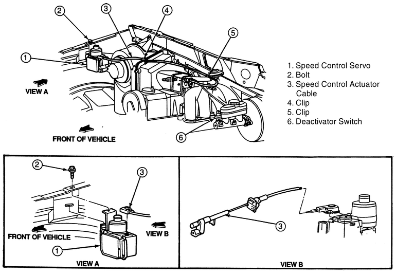

The throttle actuator is mounted in the engine compartment and is connected to the throttle linkage with an actuator cable. The speed control amplifier regulates the throttle actuator to keep the requested speed. When the brake pedal is depressed, an electrical signal from the stop lamp switch returns the system to stand-by mode. The vacuum dump valve also mechanically releases the vacuum in the throttle actuator, thus releasing the throttle independently of the amplifier control. This feature is used as a safety backup.
Fig. 1: Vacuum controlled cruise control system components

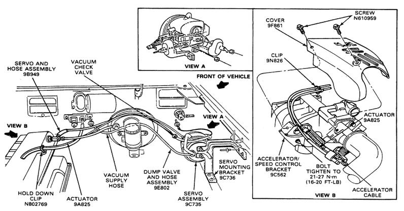

The throttle actuator/control unit is mounted in the engine compartment and is connected to the throttle linkage with an actuator cable. The control unit regulates the throttle actuator to keep the requested speed. When the brake pedal is depressed, an electrical signal from the stop lamp and deactivator switches return the system to stand-by mode. This system operates independently of engine vacuum; therefore, no vacuum lines are required.
Fig. 2: Electronic cruise control system components
Cruise control diagram

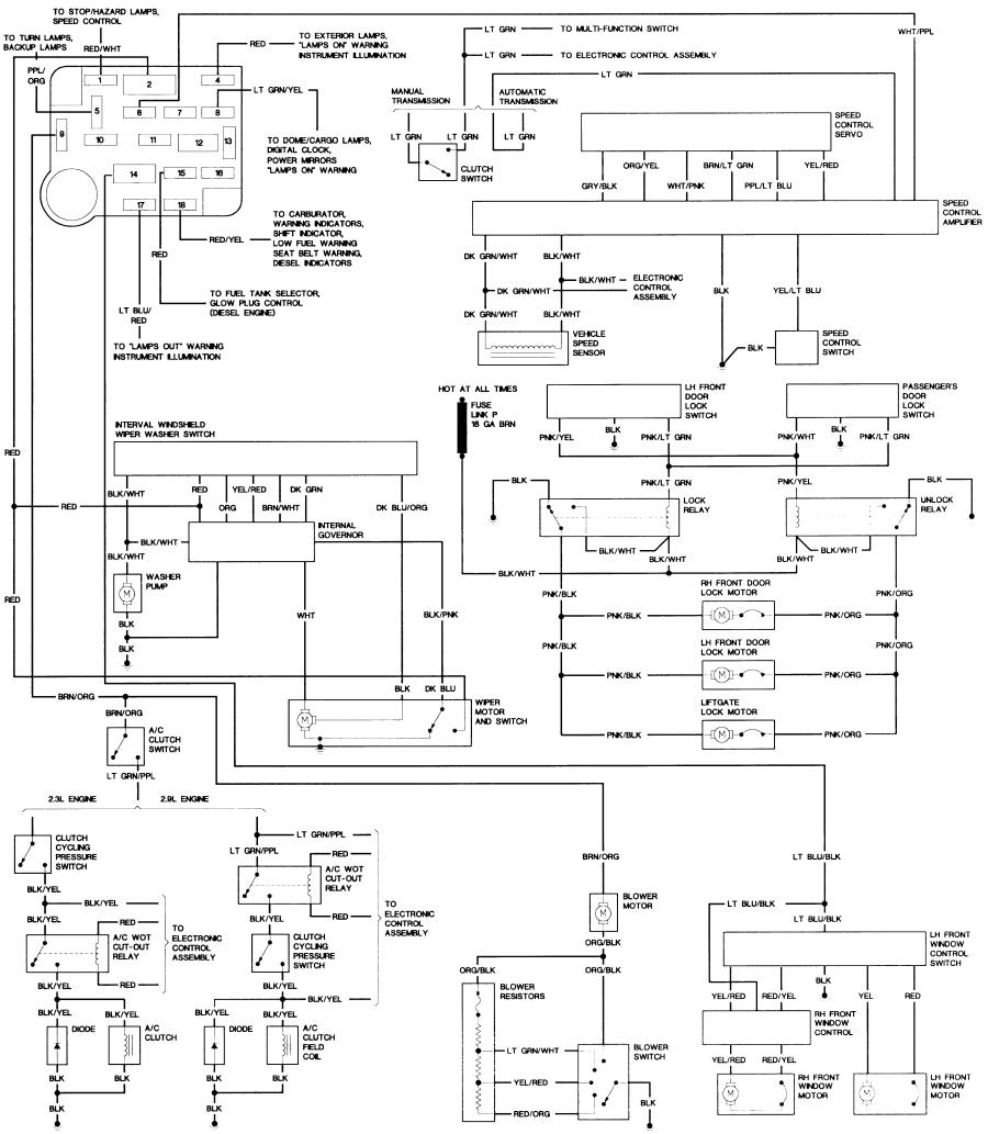

Wiring Diagrams:
Here are (2) wiring diagrams that may help as well:
Wiring Diagram – .pdf
