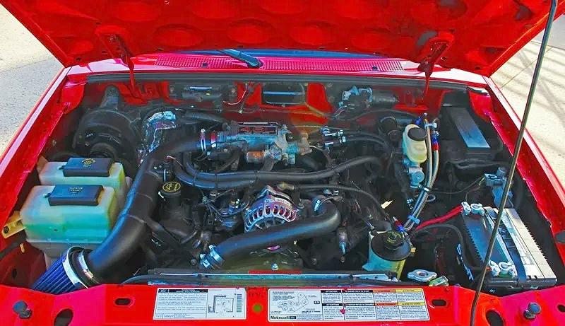

Here is my 1999 Ford Ranger that I swapped a 4.6L V8 into. My number one objective during this swap was to not mod the body or frame in any way. In other words, everything I did to bolt in the 4.6 was using brackets or off the shelf Ford parts so that I could theoretically unbolt this drivetrain and bolt it into another Ranger. When finished, I wanted it to look factory.

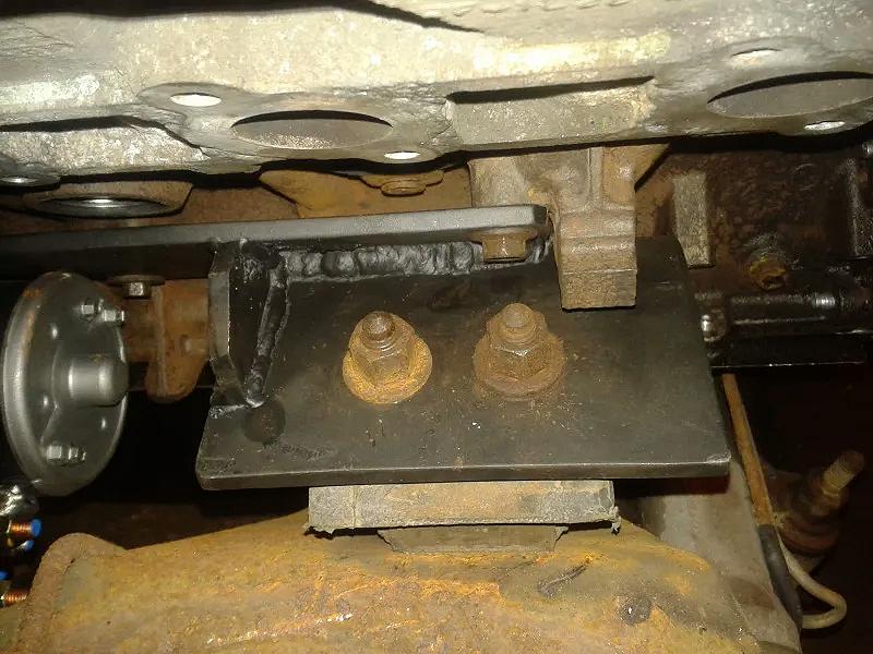

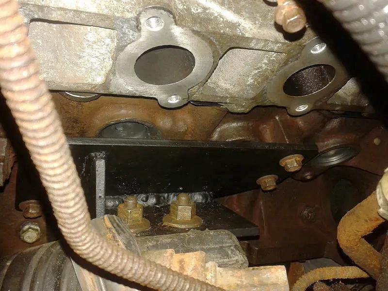

Next, I bolted the transmission to the crossmember using the stock transmission mount and then supported the engine with a cherry picker while I centered it and then used some steel plate to adapt the engine to the stock 4-cylinder engine mounts.

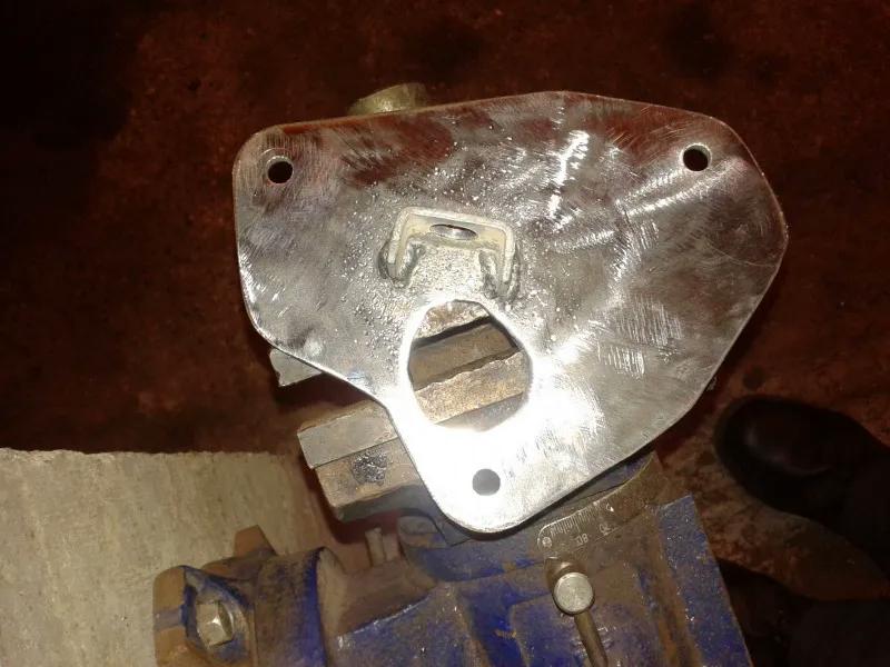

I made a steel plate to bolt to the firewall using the stock holes that the stock shaft boot bolted to in order to mount the Heim joint.

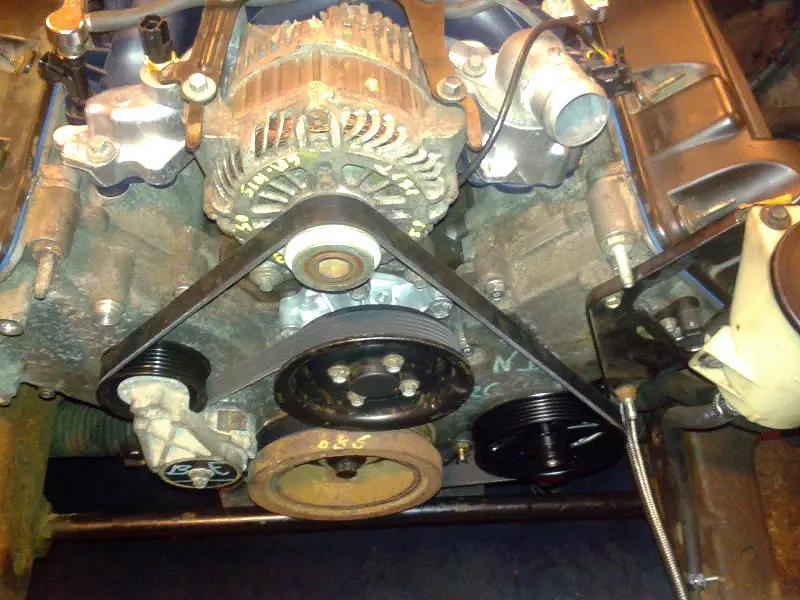

For the Front-End Accessory Drive (FEAD), I used a Crown Victoria power steering pump and bypassed the A/C compressor using a grooved pulley on the tensioner and a shorter belt. It’s a common mod in the Mustang world.

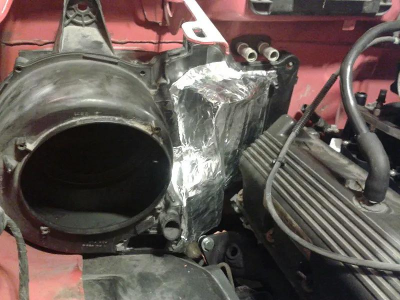

The heater box was an easy modification. I just cut it using a cut off wheel and built it up with duct steel and aluminum tape.

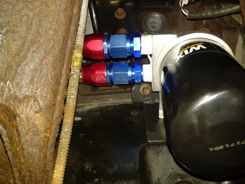

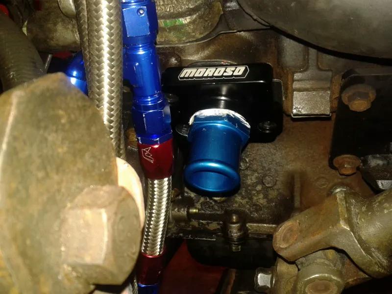

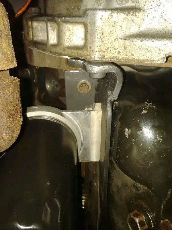

The oil filter situation was next. It was obvious that I could not fit a filter in where it was supposed to go. The first option was to use an aftermarket relocation kit. However, I remembered that certain F-150’s and Expeditions had a factory remote oil filter setup on them.
In keeping with using off the shelf Ford parts, I set out to find said setup, but Ford no longer makes that setup anymore, so I had to get it used. I got the filter adaptor and mount for $10 and the engine adaptor for $25. Dorman makes replacement hoses and I got a set for $130 from O’Reillys.
Well, that didn’t fit so I decided to go with a remote mount setup using AN fittings and braided stainless lines.
As a side note: I also tried the high mount setup for the power steering pump that the newer F-150s use where the pump mounts to the head. That didn’t work because the pump hit the left front forward control arm mount. This would have been nice if it had worked because it would have allowed me to use a forward pointing filter mount from a 3-valve 4.6L.
So, I put the Crown Victoria timing cover back on and bought a remote setup.

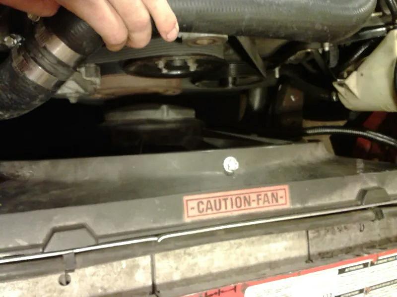

The radiator is from a 5.0L Ford Explorer and the fan is a combination of a Crown Vic fan and a 5.0 Explorer shroud.

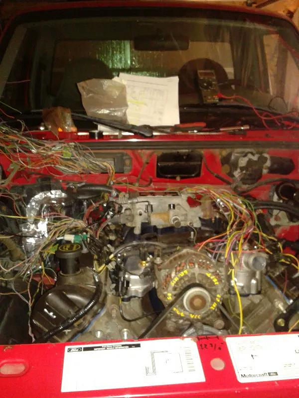

The engine wiring is a combination of a Crown Vic harness, an E-150 harness, and the Ford Rangers harness.
The remote oil filter setup is a combination of a Moroso adaptor plate, a generic remote filter mount, and some AN line. The bracket is custom.

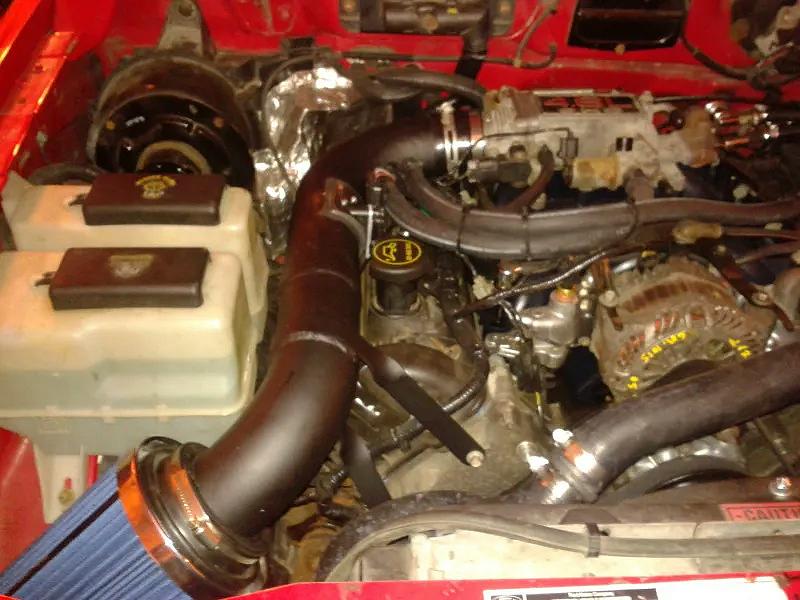

The intake is just some mandrel bent 3-inch exhaust tubing and part of a Ford MAF sensor mount.

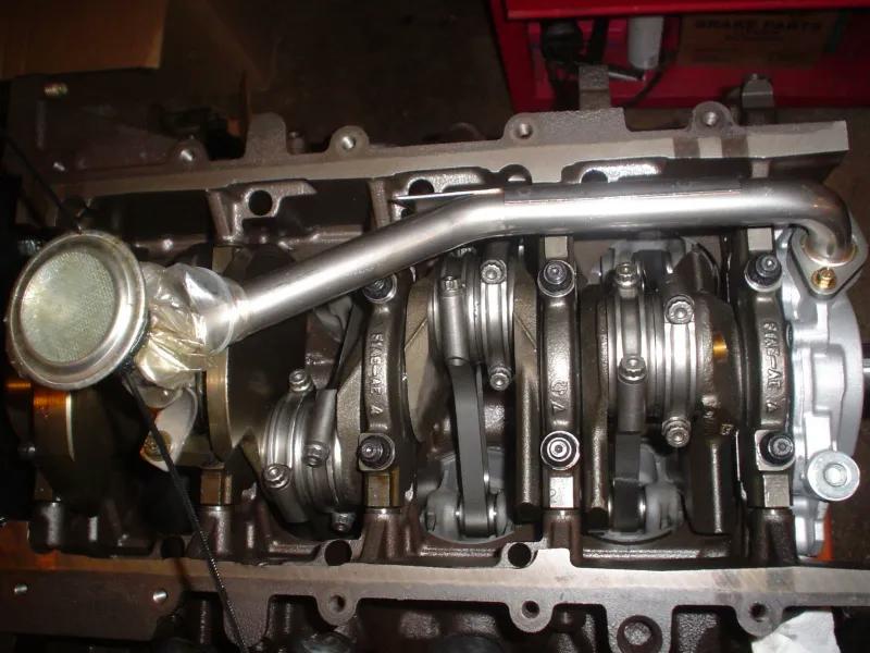

Here is a view of the bottom end after the engine rebuild:
4.6L built bottom end

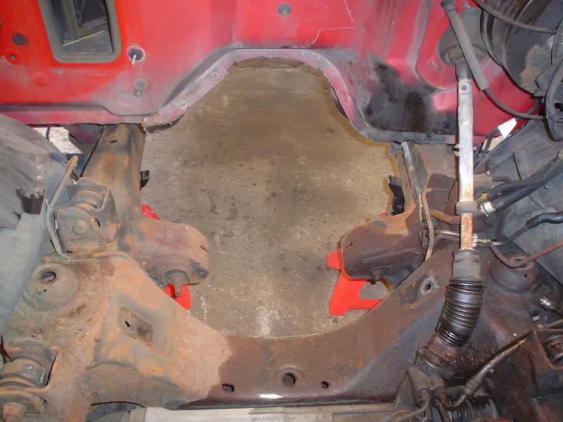

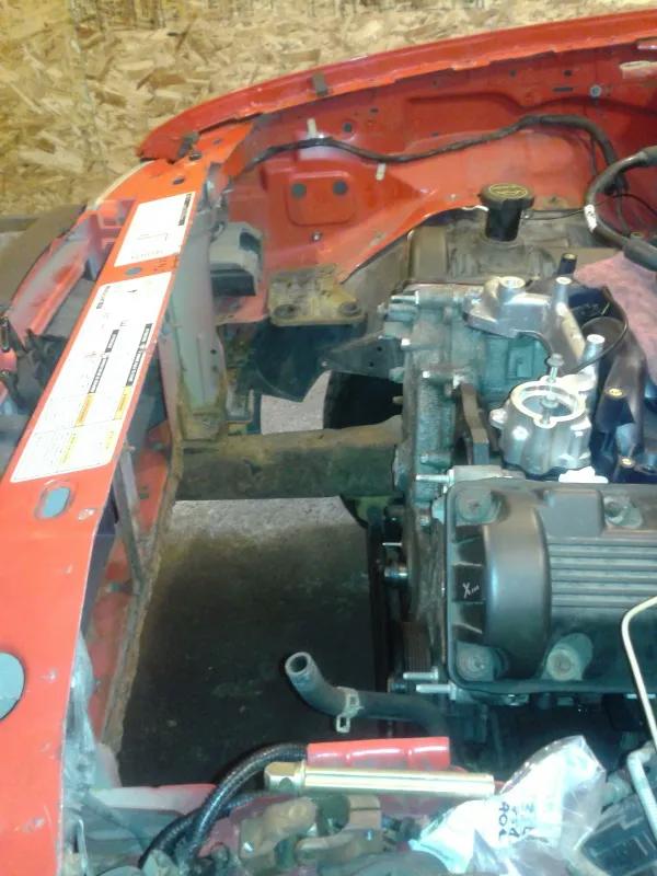

This is the engine bay minus the 2.5L 4-cylinder:
Engine bay minus the 2.5L 4-cylinder

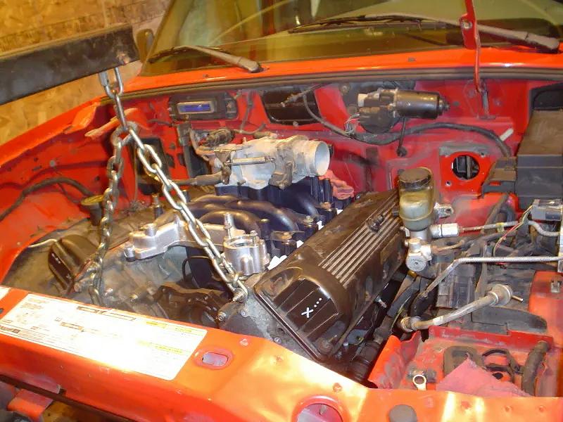

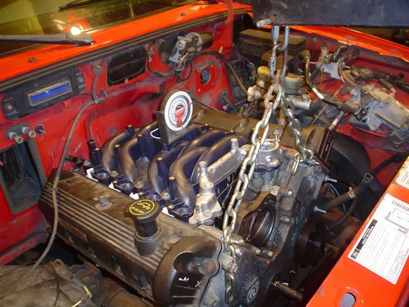

Once I got the engine built back up, I bolted it to the transmission using a stock F150 flywheel/clutch/slave and dropped it into the engine compartment to start building engine mounts:
Setting the 4.6L in the engine bay.
Ford Ranger 4.6 Swap Leveling The Engine
Ford Ranger 4.6L Engine Swap Motor Mount #1
Ford Ranger 4.6L Engine Swap Motor Mount #2

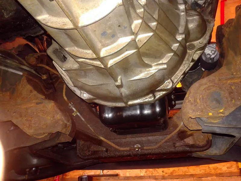

I used the stock M5OD trans mount from the rangers 4 cyl trans and it bolted right to the M5OD from the F150.

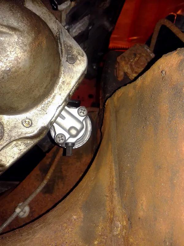

Stock F150 starter fits with plenty of clearance.
Ford F-150 starter clearance

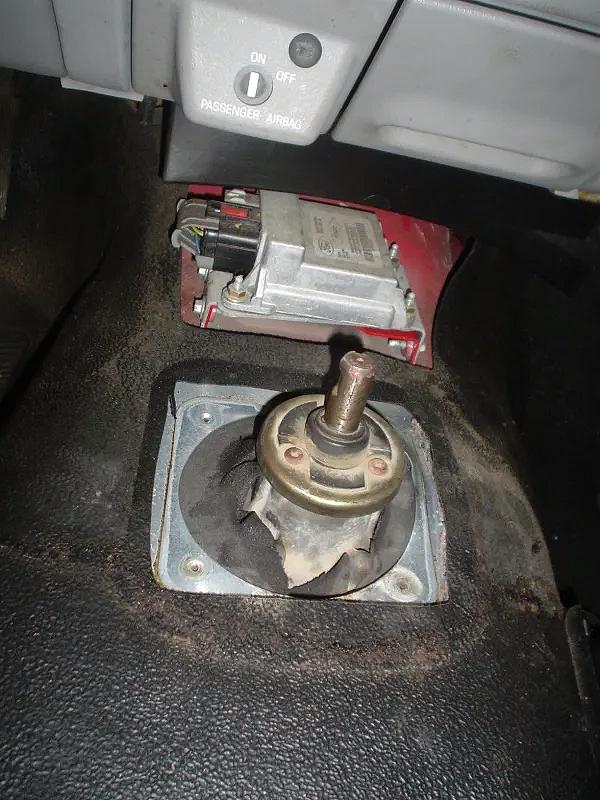

The shifter on the F150 transmission did not fit properly so I simply removed the top from the F150 Transmission and replaced it with one from a M5OD from a V6 F150 (its farther back due to the V6 being shorter).
Ford M5OD Shifter

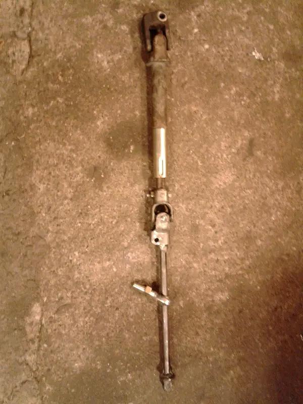

With then engine mounted next order of business was the steering… This is the finished product, but I will explain what I had to do to get it to this point. I got a bunch of steering shaft u-joints from a junkyard as well as a few complete shafts and some cold rolled 1/2-inch steel rod and a Heim joint. The lower shaft is from a Crown Vic with a conventional steering setup (not R&P).
Ford Ranger 4.6L V8 steering shaft
This is the plate I made to support the heim joint, this simply bolts to the firewall using the three stock bolts that held the rubber/plastic steering shaft seal/bearing.
Steering plate

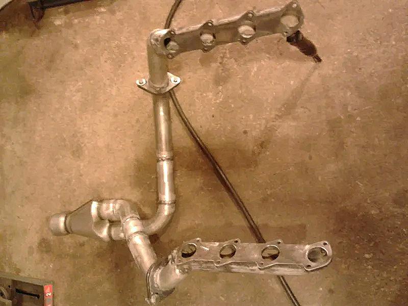

The exhaust was next, since there is little room for manifolds and no one makes headers to swap a 4.6 into a ranger I made my own setup. They are not headers and probably sacrifice a small amount of power, but they were easy to build and were cheap, they were made with SOHC 4.6 flanges and exhaust tubing. I them painted the pipe and wrapped most of the Y pipe with fiberglass header wrap.
Ford Ranger 4.6L V8 swap exhaust manifolds

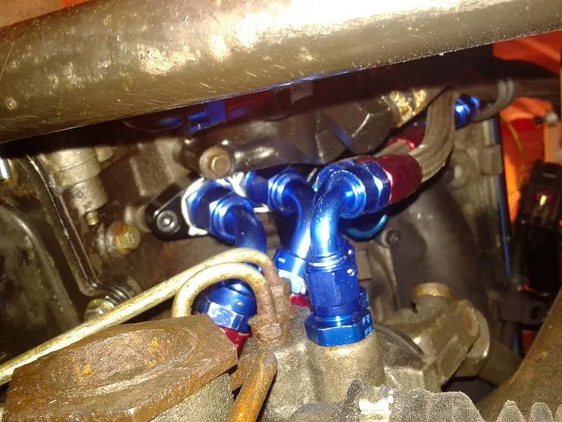

The oil filter would not fit in its normal location, so I bought a Moroso adaptor plate and some SS AN lines and fittings and a remote mount filter fixture. I had to fabricate a bracket to mount it too.
Moroso oil filter relocator
Ford Ranger 4.6 V8 swap Moroso oil filter relocator
Oil filter relocator bracket

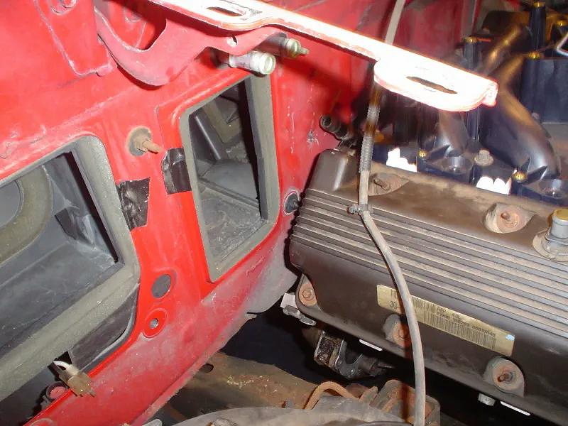

With the oil filter handled I had to modify the heater box, I just cut it up until it fit and used some sheet metal to build it back up and covered that with foil tape.
Heater box removed
Heater box sealed with aluminum tape.

The radiator is a stock unit meant for an Explorer with a 5.0. It bolted into the stock location using the stock mounts. The Fan is a combination of a Crown Vic fan and an Explorer shroud bolted together with washers as a spacer.
The hoses are actually 4 hoses that I cut and spliced together using galvanized pipe and clamps. I originally used regular clamps but then went back and used some heat shrink Gates power clamps for a cleaner look and better sealing. The heater hoses are just bulk hose that I inserted springs into so they would not kink.
Radiator and radiator hose
The wiring is a combination of a engine harness from an E150, Vic, and the ranger to body harness. I soldered all the connections and used heat shrink.
Ford Ranger 4.6L V8 wiring harness
The drive belt is simply a shorter belt to bypass the A/C compressor and I installed a grooved pulley in place of the smooth one on the tensioner.
Ford Ranger 4.6 V8 drive belt
After all was said and done I took it to get tuned and put down 247hp and 291Ft/Lbs or torque to the rear wheels, not too bad for a almost stock 4.6 burning E85!!
