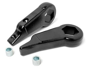

  • Torsion Bar “Crank”: The most cost-effective method involves tightening the factory adjustment bolt on the torsion keys. This increases the pre-load on the torsion bars to raise the front end but often results in a stiffer ride: Cranking Your Torsion Bars
  • Aftermarket Torsion Keys: Specialized “re-indexed” keys replace the factory ones, allowing for up to 3 inches of lift while maintaining more adjustment range: Torsion Key Lifts Explained
  • Pre-key modifications (2008–2011): Involves using the torsion bar keys from a 1998-2007 Ford Ranger 4×4 to lift a 2008-2011 Ford Ranger 4×4: Pre-Key Modification Guide
  • Rear Shackles or Blocks: To match the front lift, owners often install lift shackles (which lower the rear spring eye), lift blocks (spacers placed between the axle and leaf springs), or add-a-leaf’s (a small leaf spring that installs in your existing leaf pack).
First-hand note: I’m not a fan of cranking torsion bars. You gain height, but you lose downward travel, which hurts off-road performs and causes a harsher ride.
Pro Tip: If you cranked your torsion bars you’ll need longer front shocks. The Rancho RS5374 is the only shock I’m aware of that will fit with cranked torsion bars: Shocks For Your Torsion Cranked Ranger
1998-2011 Ford Ranger 4×4 Torsion Keys
These lifts usually retain factory control arms but require proper alignment and careful attention to CV angles.

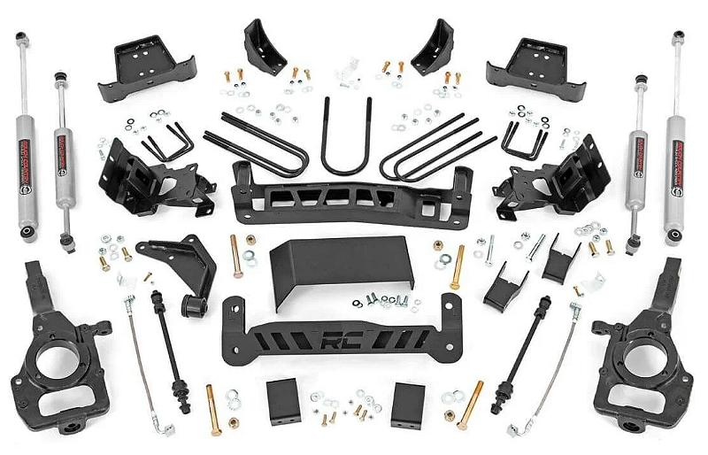

Once you go beyond 3 inches, you’re no longer “adjusting” the suspension — you’re re-engineering it.
  • Drop Brackets and Knuckles: Comprehensive kits, such as those from Rough Country, use heavy-duty crossmember drop brackets to lower the entire front differential and control arm mounting points: 1998–2011 4×4 Lift Kits Overview
  • Lifted Knuckles: These kits include new steering knuckles (spindles) to maintain proper steering geometry at the increased height.
  • Differential Drop: These kits drop the front differential, control arms, and steering to restore geometry and protect CV joints.
  • Rear Leaf Springs: I’m not aware of any companies offering springs in 1998-2011 Ford Ranger lift kits, but the 4-Inch rear leaf springs by Skyjacker and Deaver leaf springs will work.

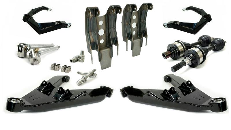

A long travel kit works by replacing the restrictive factory Short-Long Arm (SLA) components with a wider, high-performance suspension system designed for extreme articulation and wheel travel.
  • Increased Track Width: The kit uses longer upper and lower control arms, typically widening the truck by 4.5 to 5.5 inches per side. By extending the arms, the wheels travel in a much larger vertical arc, which dramatically increases wheel travel—often reaching 12 to 18 inches, roughly double the stock capacity.
  • Elimination of Torsion Bars: Standard long travel kits for this generation eliminate the factory torsion bars. They are replaced by coilover shocks (typically 2.5″ diameter) and often secondary bypass shocks, which provide significantly better damping control and a superior ride.
  • Extended 4WD Drivetrain: To maintain 4×4 functionality with wider arms, the kit includes extended axle shafts. Specialized high-angle CV joints (such as 930 CVs or RCV axles) are used to allow the axles to articulate at extreme angles without binding or breaking.
  • Geometry Correction: The kit repositions the front wheels roughly 1 to 1.5 inches forward. This provides better firewall clearance, allowing the use of larger tires (up to 35″ or 37″) during full suspension compression.
  • Torsion Bar Elimination: High-performance “long-travel” kits (e.g., from True Travel Dynamics or Blue Torch Fab) completely remove the torsion bars.
  • Coilovers: These kits replace the bars with coil-over shocks, providing significantly more wheel travel (up to 16 inches) and superior ride quality for off-roading.
  • Boxed Control Arms: Fabricated, internally braced lower and upper arms replace weak factory units and utilize high strength uniballs instead of standard ball joints for greater range of motion.
  • Rear Leaf Springs: These kits are usually used with Deaver rear leaf springs.
