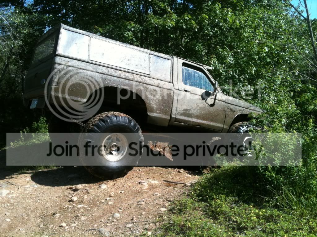

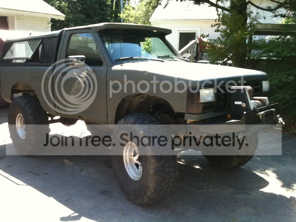

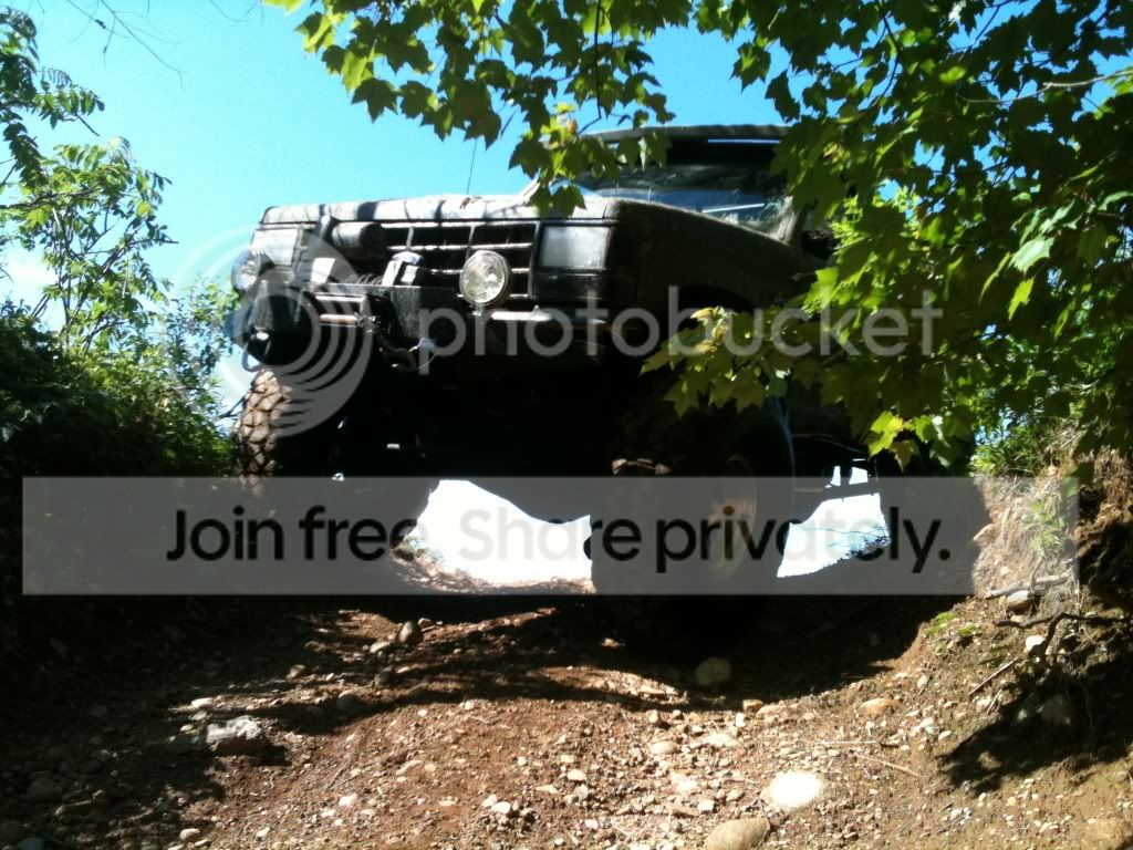

I just got my woods truck put back together for another season of wheeling. Put a new floor in, changed the motor for a newer better running 2.9, and regeared the front to match the Dana 44 rear end I picked up with 4.88s and a spool. I rebuilt the front shafts with Spicer 760 u-joints so hopefully the stock Dana 35 will hold up to the 40s.
*I have 3/4 ton axles to go in this fall with 4.88 gears and radius arm front suspension.*

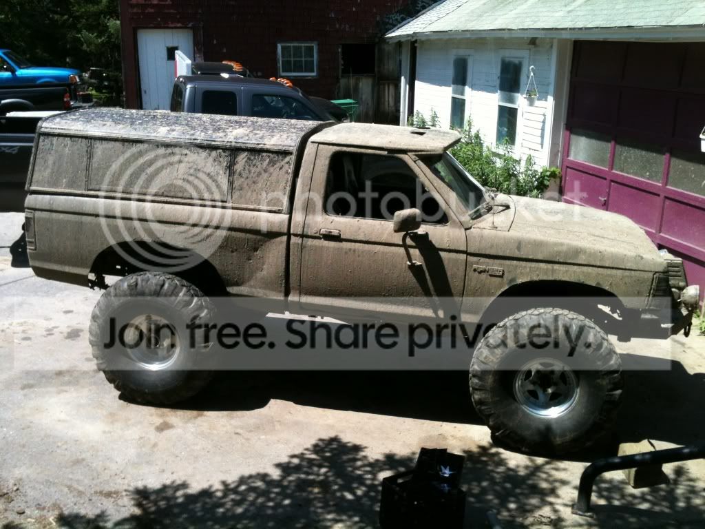

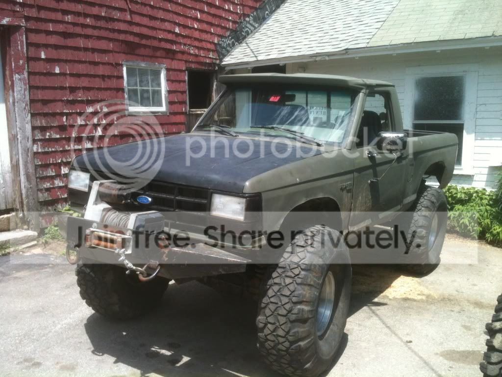

Here's what it looked like last fall the last time it was out. 4.56s, welded rear and 35" Mud Kings. 1" body lift and F150 coils, and hacked fenders.*
Rebuilt the 91 again, this time on 40s
and now with grooved 39.5 TSLs, 3" body lift, F150 coils and the same fenders.*

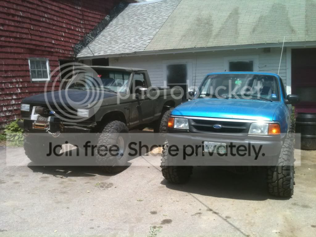

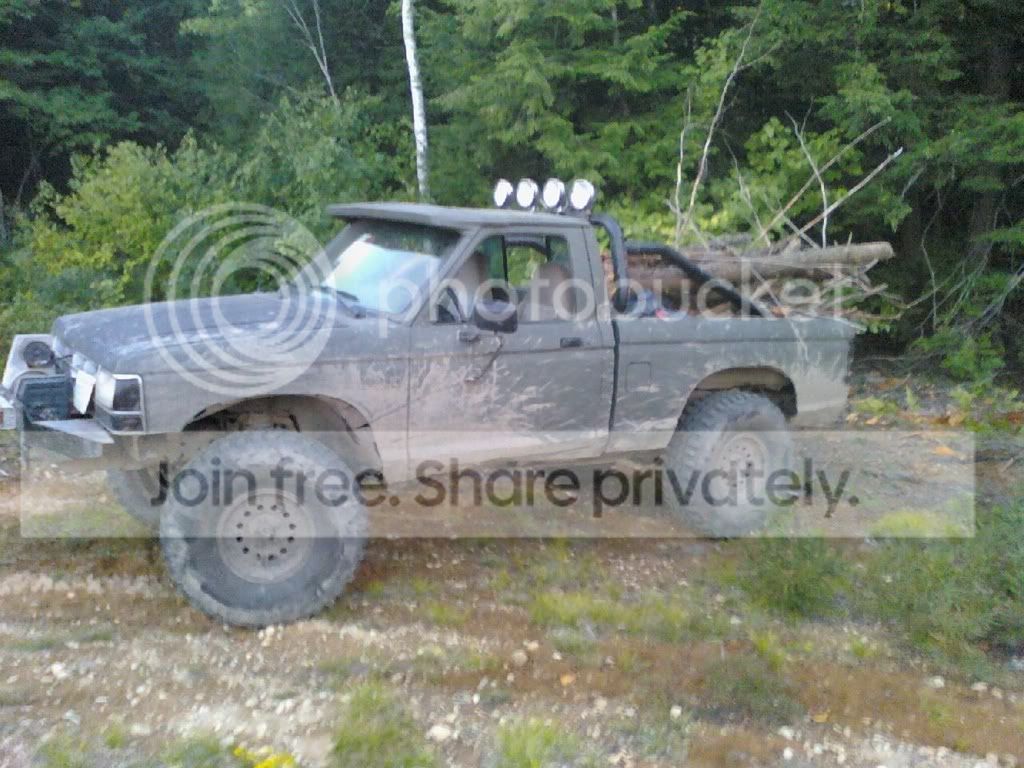

Next to my 94 6" Skyjacker and 35s
