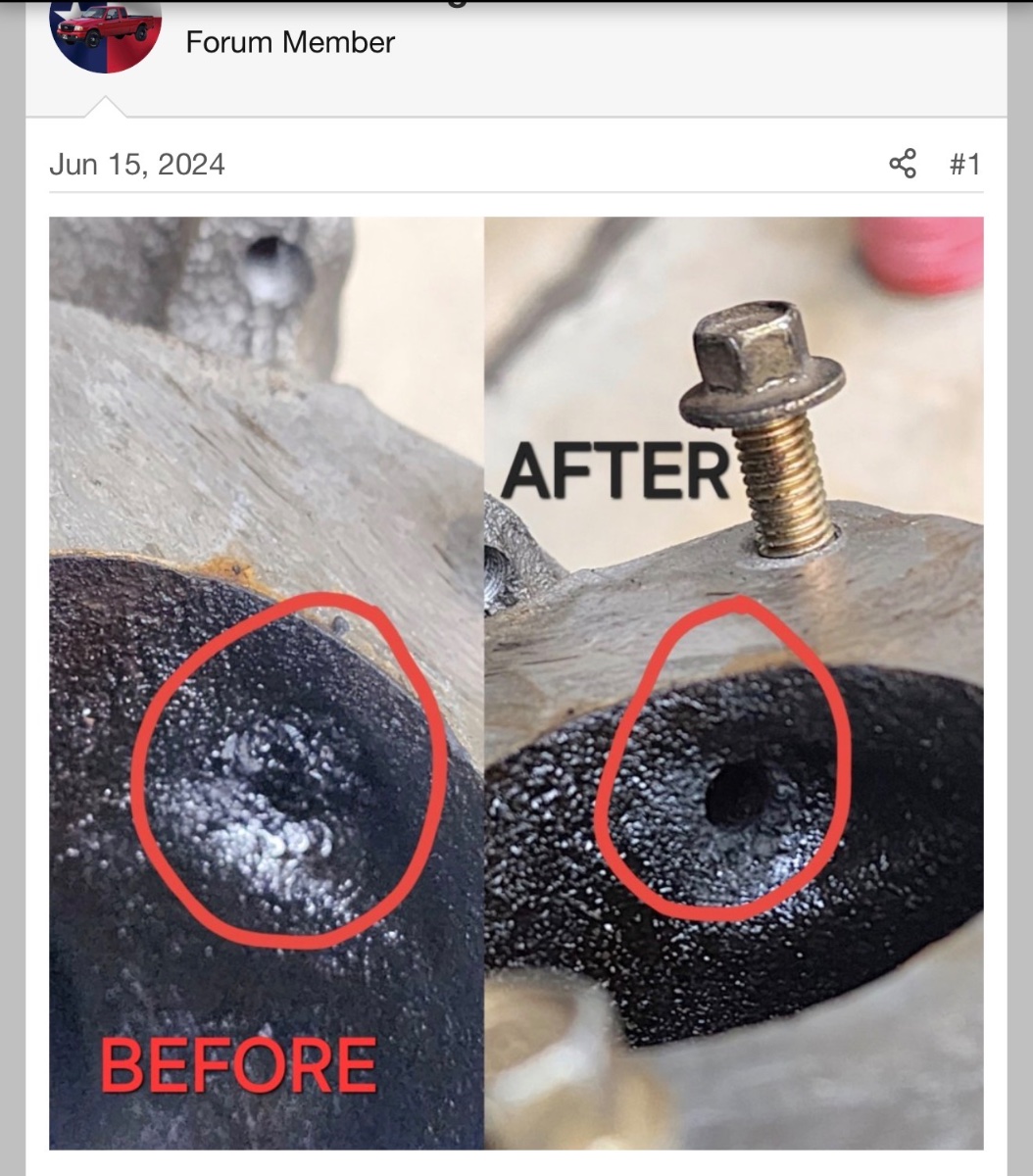

I tried sucking through the hose that goes to the top of the egr valve , no engine stumble so I’m assuming it’s a clogged passage somewhere even after getting it all cleaned professionally. I remember reading theirs a really tiny hole somewhere that commonly gets over looked? Can anyone explain where that is exactly? From what I understand I can’t access just by removing the egr valve correct?

I agree but I don’t think it’s anything with the actual egr tube /pipe as it’s brand new, I’m thinking it’s this because I’m sure it can’t be much else especially since a really good mechanic tools apart the entire intake manifold and throttle body and cleaned it. I’m thinking this? What do you think? The problem is I can’t find where this actual tiny hole is I think thats it though .
