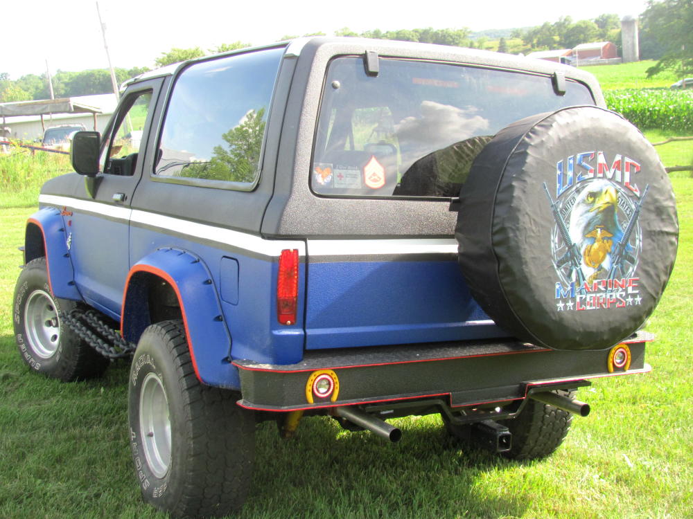

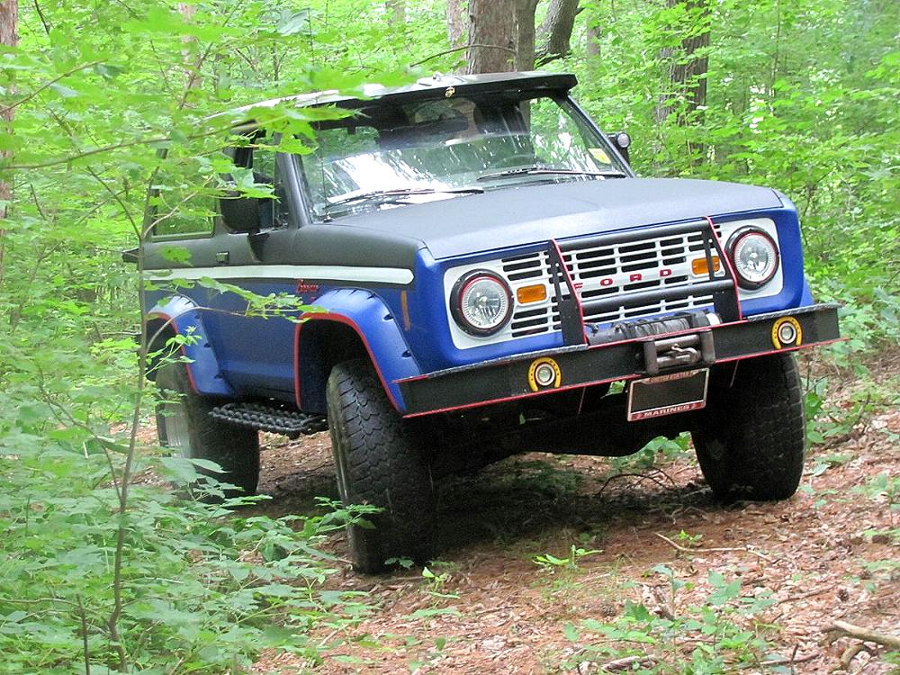

Ford Bronco II with early Bronco grill and round headlights
Dale dusted off the Bronco II and spent the last 2-years fabricating the bumpers from semi-trailer cross beams and adding a grill from a 1966 Ford Bronco. With that done he added taillights to match. The rock sliders were made from a logging chain he found on an in-law’s farm, and the mirrors came off of a Toyota FJ.

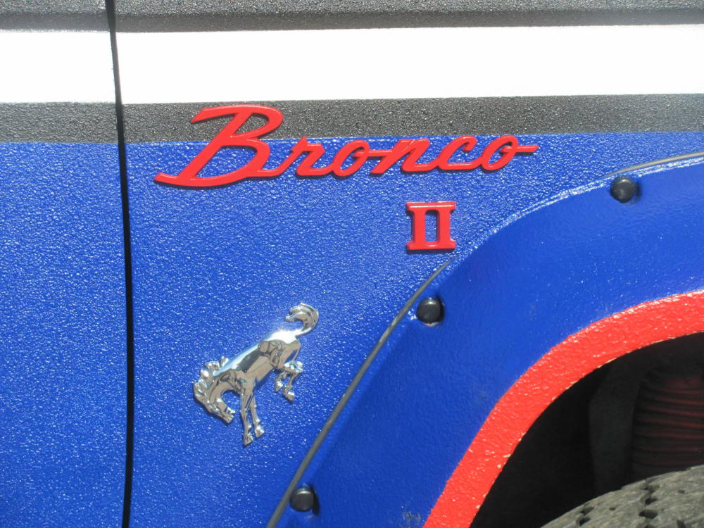

The second paint job looked bad, so Dale decided to Raptor Liner the whole vehicle. The color combination was easy to decide on. Since Dale was in the Marine Corps for 20 years, he used a color pattern similar to the Marine dress blue uniform.
Raptor lined Ford Bronco II
Close up view of Raptor lining and early Bronco logo

Ford Bronco II built to look like an early Bronco
Even the Bronco II taillights were converted to the early Bronco style
