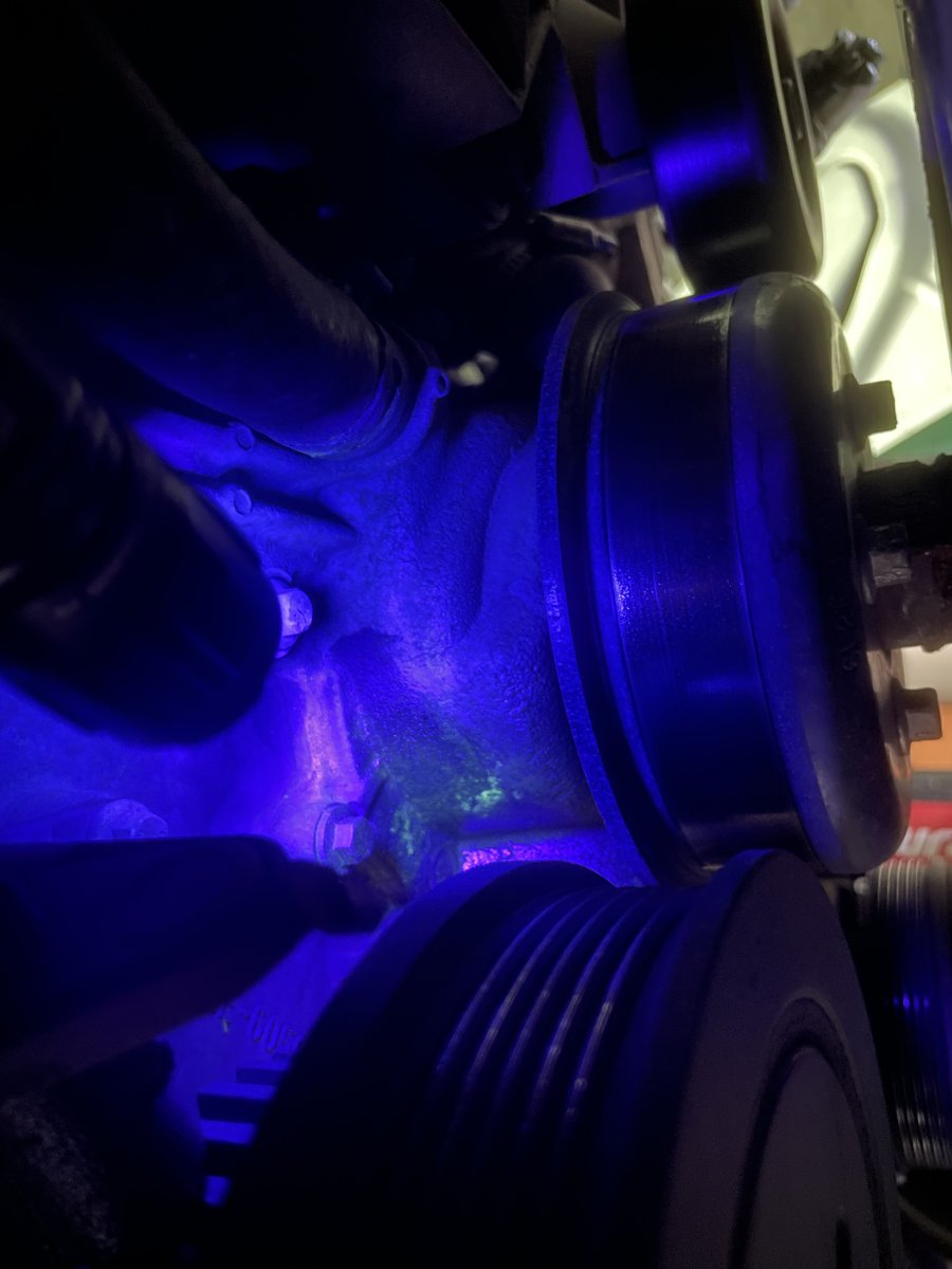

I have coolant dye in the system from that job, so that's making my life easier for sure. From my inspection so far, it appears that the coolant is leaking onto the crankshaft position sensor and dripping down from there. There is no play in the fan clutch pulley.

Alright little update. As you can see, coolant appears to be gathering on the bottomside of the water pump housing. It seems like it might be leaking out of behind the fan clutch pulley? The coolant residue is on the bottom of the actual water pump housing and not coming out of the mating surface.

Would this match with the leak stopping at a certain point and not continuing to leak past that point? And does this mean I need a new water pump.

It's not uncommon for a water pump to leak
And it sure looks like yours is leaking.
Sounds l8ke waterpump leak. Probably coming out of the weep hole which means shaft seal is leaking.

And it probably stops leaking after the level drops because it can't build pressure anymore because of the air in the system. Kinda like running with the cap off the radiator.

Okay ya'll. It's been a bit since I've replaced the water pump and unfortunately the issue has not been resolved. I honestly haven't got a dang clue why but it's doing the same thing, dumping the top of the radiator out and stopping after a bit less than an inch below the top of the rad.
The system still pressurizes and temps are still perfectly fine, just the same symptoms. Any ideas?
Since I put new coolant in I'll get new coolant dye in there and try to pinpoint the leak better. Thanks!
