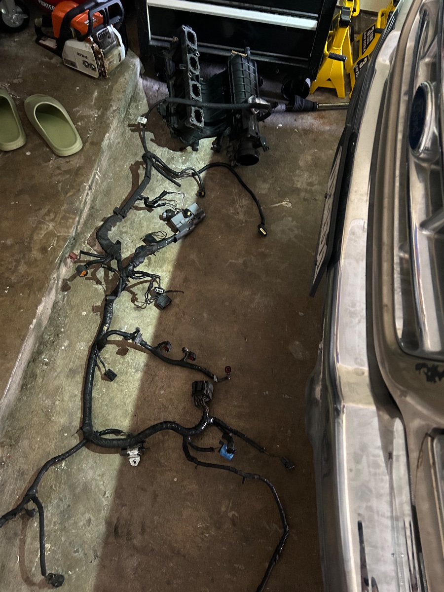

For the past couple months, when I get home from work and I’m parking the truck, it will randomly just shut off.
At first I thought it was bc I had 3 engine codes:
P1537- Intake Manifold Runner Control Stuck Open (Bank 1)
P0141-02 Sensor Heater Circuit (Bank 1 Sensor 2)
P0171-System Too Lean Bank 1

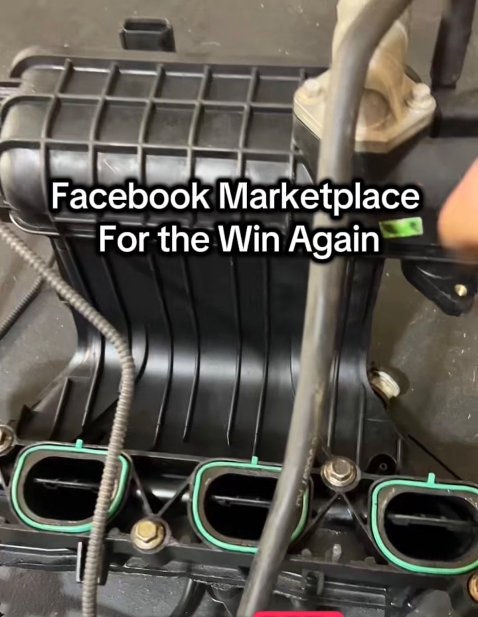

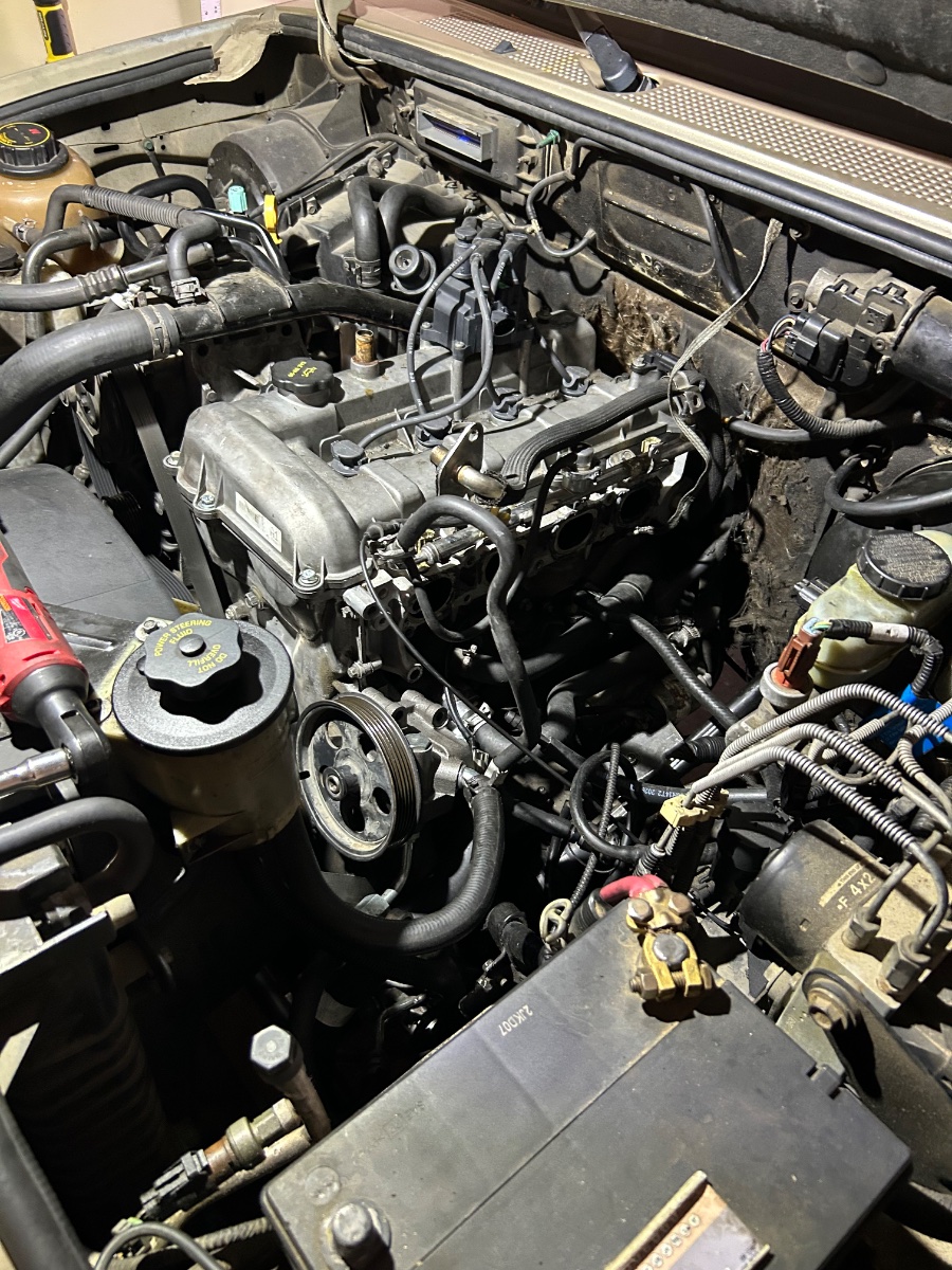

Long story short the truck had been tampered with before me so I decided to replaced the intake manifold with the originally IMRC valves, I replaced the whole engine harness since the wiring had also been messed with, and I installed an OEM catalytic converter from another Ranger.
Check engine lights went away and it’s been running good for the most part, BUT it still shuts down when I get home from work while I’m parking.
At this point I’m starting to think it’s temperature related, I live in TX and it’s currently summertime.
It’s strange because for my Morning commute, when I’m parking at work, it doesn’t shut off.
But when I go home (95+degF) it shuts off while I’m parking.
I have replaced every engine sensor along with purge valve and vacuum hoses. I even put a mechanical thermostat from TRQ because the electronic one was always getting stuck closed. I bypassed the CEL by bridging a 1.5kohm resister on the connector.
I’m just lost at this point and hoping someone can help.

What kinda engine temperature are you seeing when does it? Only while parking at home is odd. What if you pull up at a nearby store after work? Does it sputter a couple times first or just like you turned the key off? Will it start back? If so does it take longer than normal?
That all of the relevant questions I can think off...
As mentioned above, does it start right back up? Could you keep it running with throttle instead of letting it die?
Easiest way to figure out the issue is to use ForScan or another scanner to log some live data. IAC percentage and voltage, short and long fuel trims, coolant temp, timing, MAF. Something is pulling fuel or dumping timing
