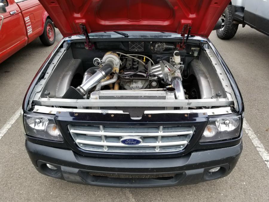

At first glance, you may simply think this is just another lowered Ford Ranger. When you look under the hood, you quickly realize that this is far from your normal engine compartment.

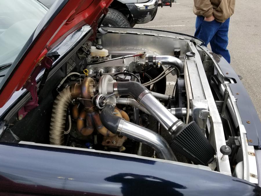

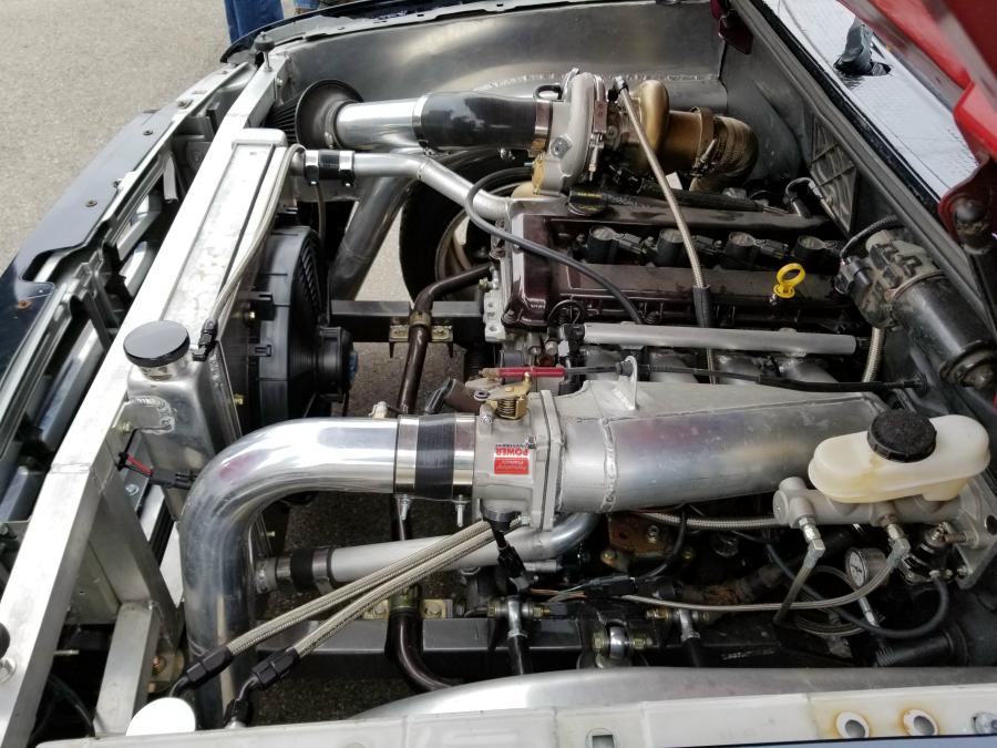

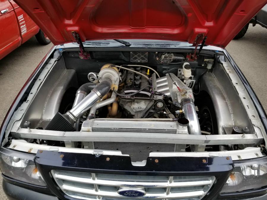

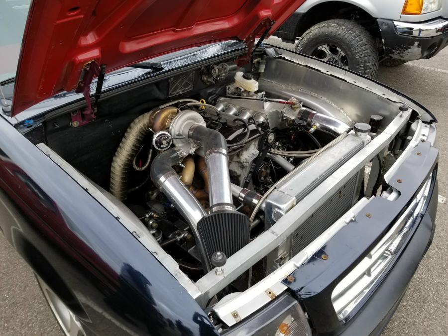

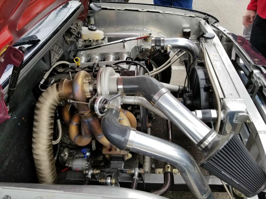

When you open the hood, you’re greeted by a 2.3L Duratec out of a 2006 Ford Focus that’s been treated to a custom turbo setup. All of the aluminum work under the hood was done by Jeff. Even the custom aluminum intake.
Jeff describes the powertrain as:
Powertrain: 2.3 Duratec out of an 06 focus st, untouched besides swapping a custom sheet metal oil pan and modified aluminum valve cover, I plan to build an engine this was just to get it going but has proven to work well. On the outside is a schedule 10 stainless header I built myself with a Borg Warner EFR 7163 turbo (what they use on Indy cars). A custom designed and built by me intake manifold, and a basic front mount intercooler. Fuel system is an Aeromotive Stealth A1000, -10 feed -8 return, Aeromotive regulator and filter, custom billet fuel rail and ID1000 injectors. The transmission is an 03-04 Cobra T56 with a quicktime SBF bellhousing and a custom (rangergt) duratec to small block adapter and flywheel.

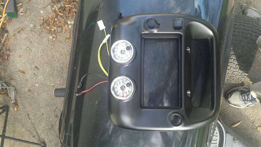

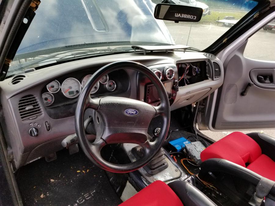

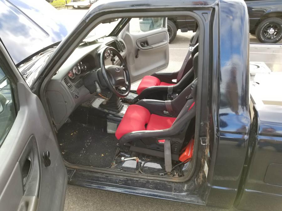

Looking inside of the Ranger, Jeff removed the airbag cover panel so we could see the Megasquirt system that controls the EFI with the turbo.
The interior also features a complete set of gauges mounted in custom panels.

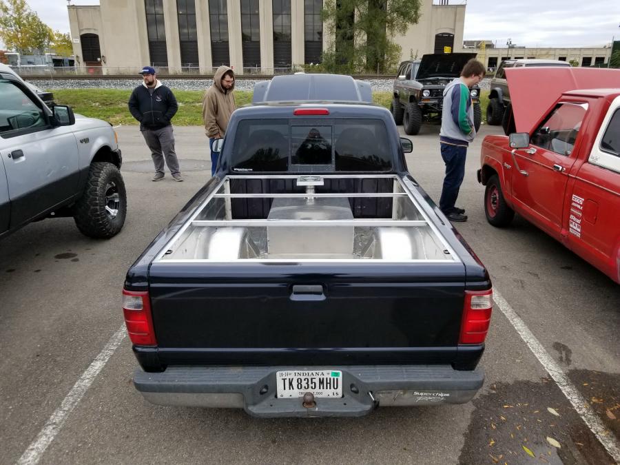

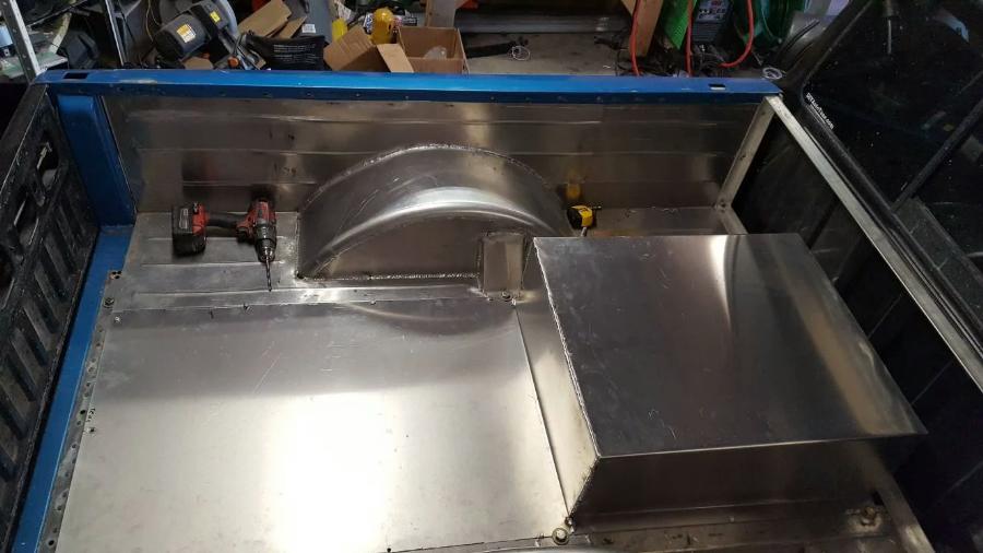

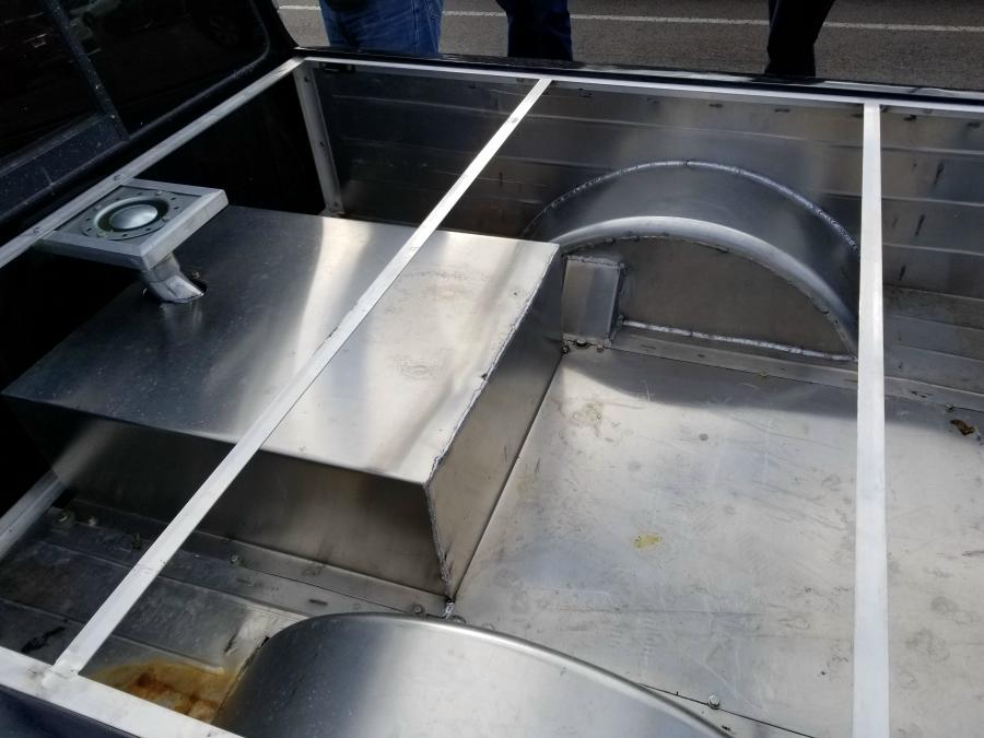

Even the bed was completely custom fabricated out of aluminum.
