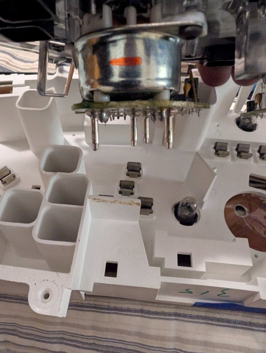

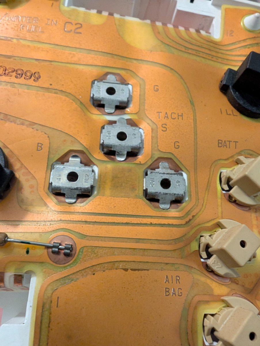

There is an electrical connector on the transmission that I believe also supply's a speed signal. I'd check for corrosion there. The speedometer could also just have a bad connection to the flexible circuit board on the back of the cluster.
This is why my tach stopped working. All the gages plug into these spring clips that connect to the flexible circuit board.

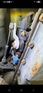

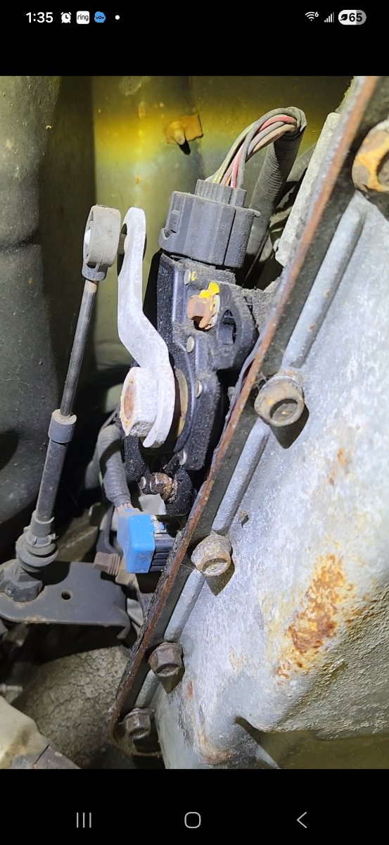

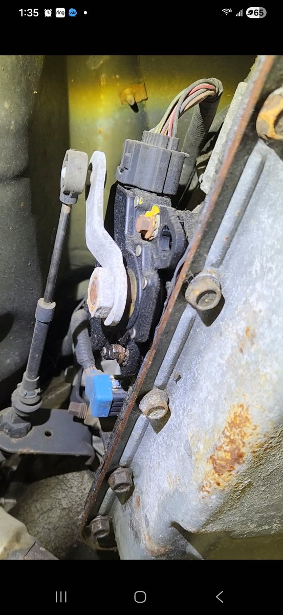

Thanks for the reply. Sorry for the delay but I have been dealing with another issue. I slipped in the shower the other day and snapped the plastic hot water cartridge/faucet at the wall. Also the incident this post relates to actually happened last August so I've been stuck at home since then and have sort of gotten used to it. The WD-40 specialist contact cleaner arrived today so I crawled under the truck and snapped some photos, the best which I have attached. So before I go disconnecting things are these the connections you suggest I disconnect and clean? Thanks very much.
It wouldn't hurt to clean those. But the speed sensor is toward the rear of the transmission, most likely in the driver side on the tailhousing.

I pulled the black plug loose and sprayed both the plug and the device. The blue one doesn't attach in any typical way that I have seen so I was a bit concerned about disconnecting that one. I could probably get a better look by putting it up on ramps. I've replaced the variable speed sensor on top of the differential. Are there more than one? Thanks.

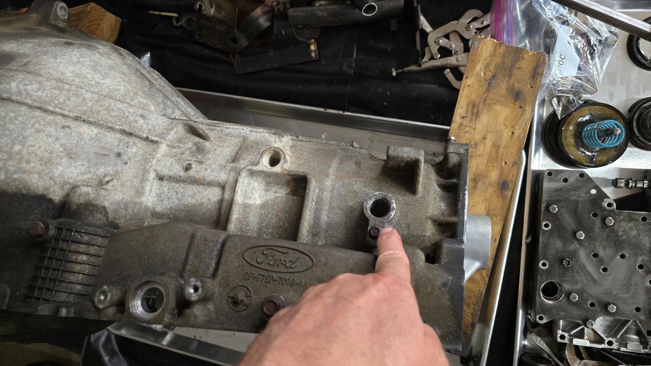

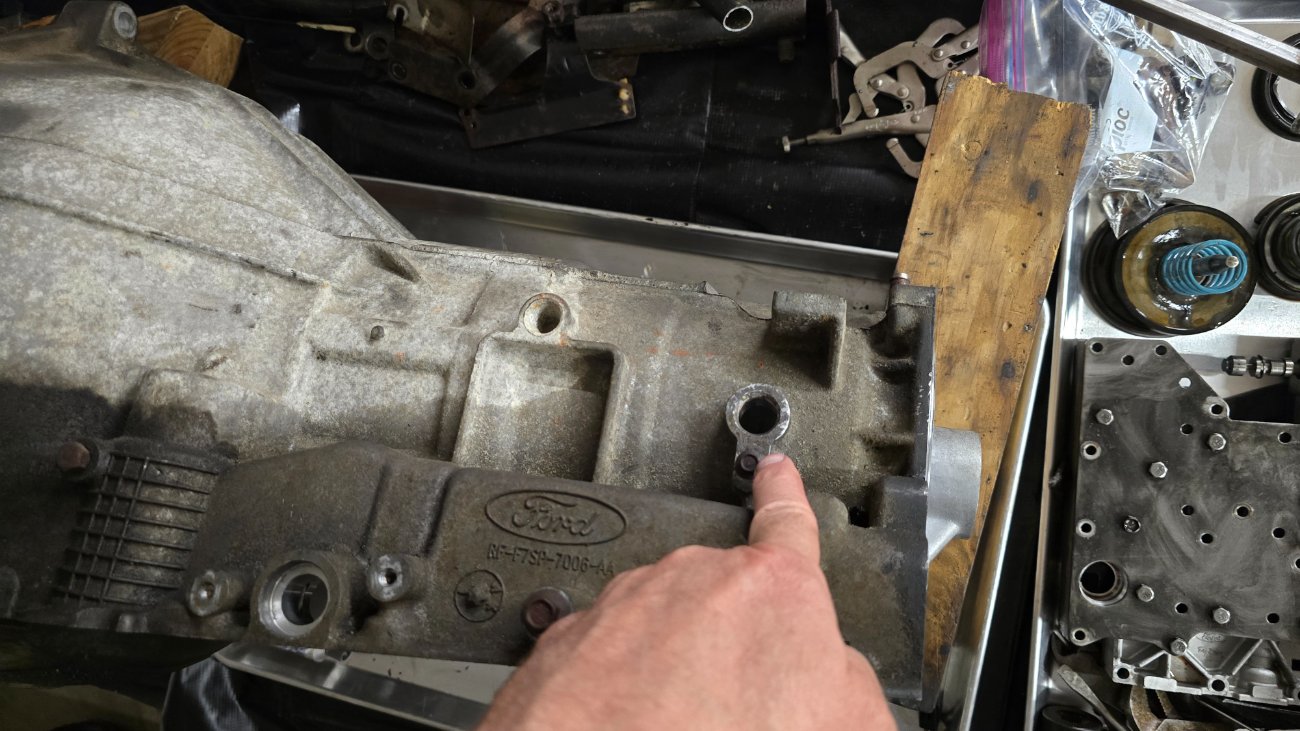

There may not be one in that transmission. If it had one, it would be in the area shown below so that it could read output shaft speed.
This is a different transmission. Just showing where tje speed sensor would be if yours had one.

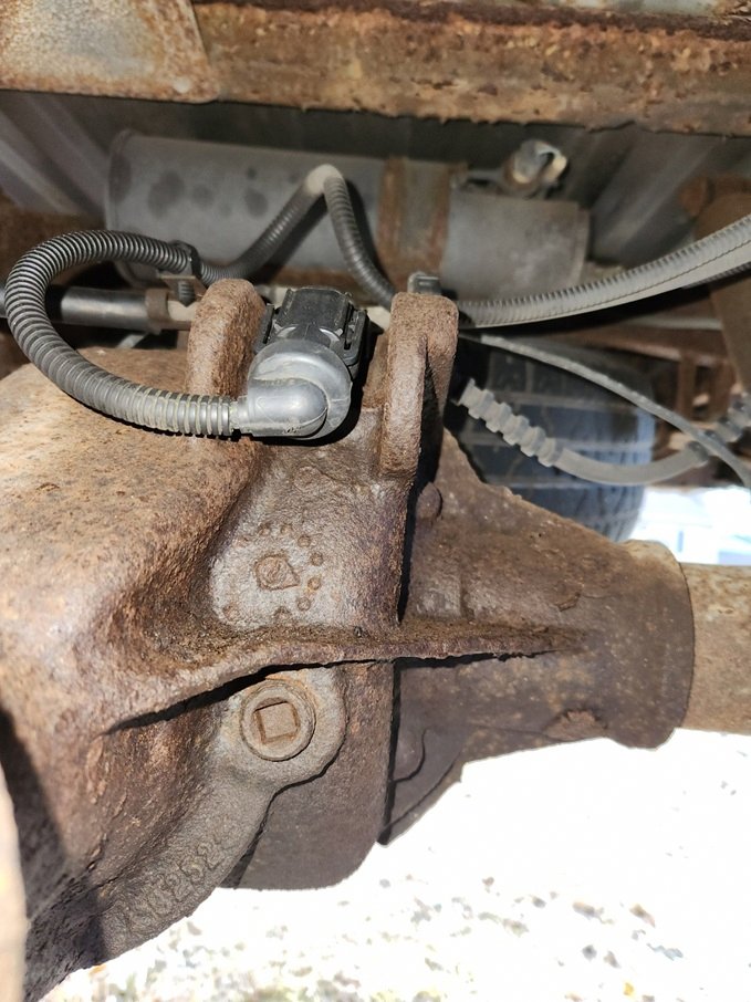

Mine has a similar stamped but uncut spot as well. Mine is on the differential. When the first replacement didn't result in a cure, a local mechanic suggested that maybe the new one was bad so I replaced it again with the same result.

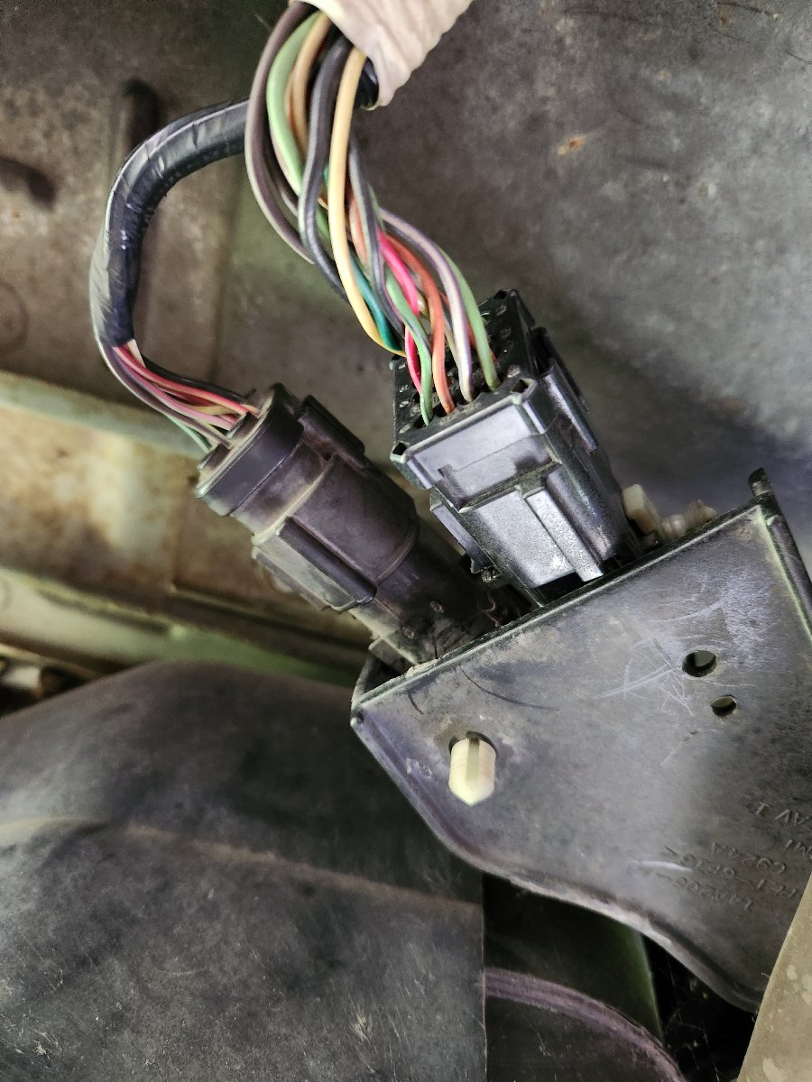

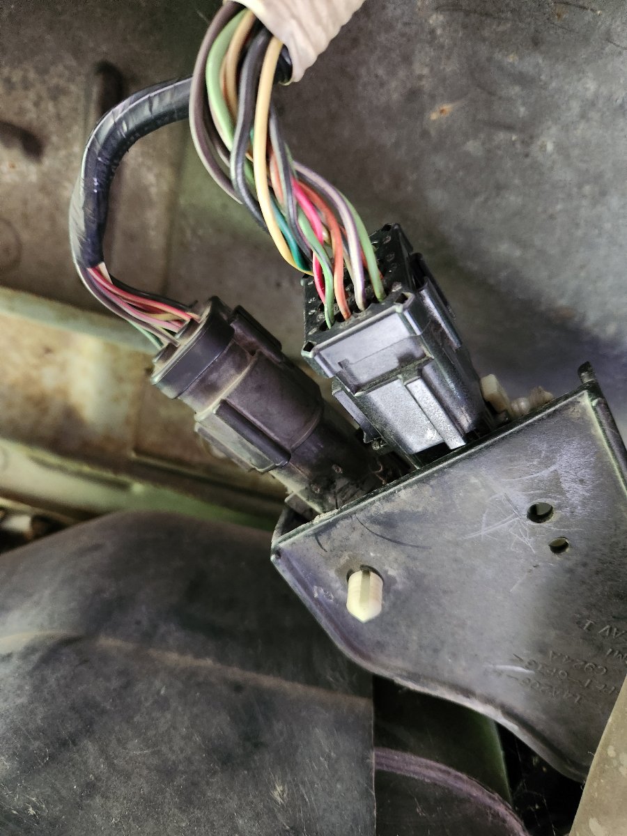

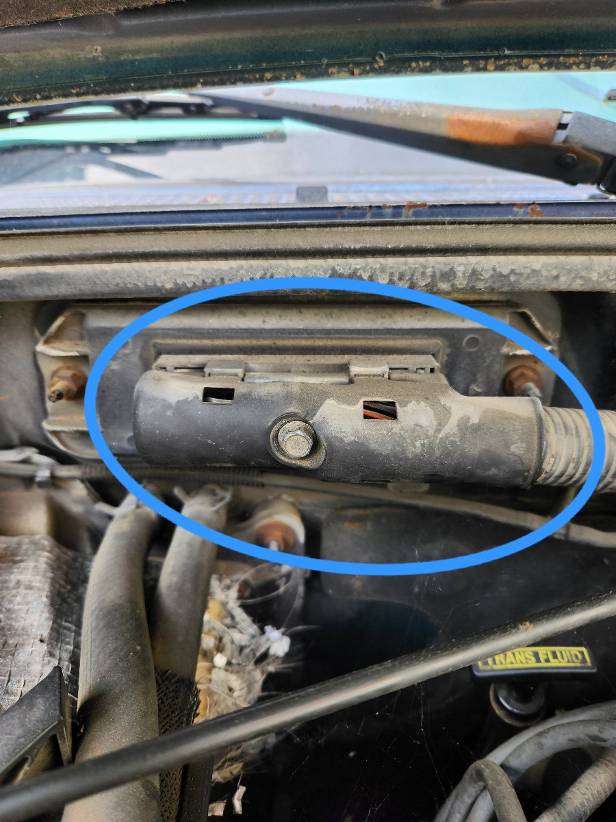

I wasn't sure if I should update the OP or reply so I chose the latter. I have been tending to another issue and was only able to get back to the truck over the weekend. The first continuity test from the vss dongle to the gem failed. Assuming an issue with the wiring I tried following the vss wire forward but it tucks up into the frame and I can't get my hand up in there. Tracing forward I found a two block junction located approximately beneath the driver's seat. Disconnecting and spraying well with contact cleaner, I allowed time to dry. I identified the two vss wires by color at this location. I disconnected the dongle from the vss, connected the two terminals together and took a continuity reading at the junction mentioned above. Having success here, I then connected those two terminals together and checked continuity at the gem, again having success. Reconnecting the vss I now have continuity at the gem. Apparently it was my first connection of the two vss dongle wires together and not a fault in the wire itself. Hoping, but not expecting the problem solved simply by disconnecting, spraying, cleaning and reassembling, I went for a drive around the block. The problem remains. It will not shift out of first gear, speedo not working, etc. So am I looking at replacing the gem or is there something else to try first? The weather will be favorable here for a day or two and I hope to get this solved. Thanks for your assistance, All the best.
  • Help needed to diagnose an electrical problem
Do you have a sensor on the top of the rear dif? If so that's also a speed sensor and another connector to look at or inspect the sensor
I do, as indicated in my post above from June 3rd. That's the first thing I replaced. Actually replaced twice due to a local mechanic's suggestion that I may have received a defective unit. If there are more, then I am unaware of the locations and would appreciate any tips. I also disconnected and used contact cleaner on both of these locations. Each time I try something I go for a test drive but always end up back home disappointed.

Anyone here know how much info the trans control module (on a 99) will give up with a good scanner? Flashing O/D indicates general transmission fault doesn't it? As in, something (it thinks is) important, probably setting a code?
I'm no expert on these automatics - will the 4r44e shift out of first if it thinks (electrically) that first is selected on the column?
I'm just brainstorming here but given the other symptoms, I think I'd be digging into the column and inspecting every single wire and contact in there. It has the vibe of "something(s) rubbed through and is grounding out"

Now the good news. There is no transmission wiring in the steering column. The column shifter moves a flexible mechanical cable that goes down to the shift lever on the side of the transmission. The electrical switch assembly for PRND21 is mounted at the shift lever on the transmission case.
I believe the transmission is supposed to stay in first if first is manually selected.
Would it be one of these two? I don't think I disconnected and sprayed them.
