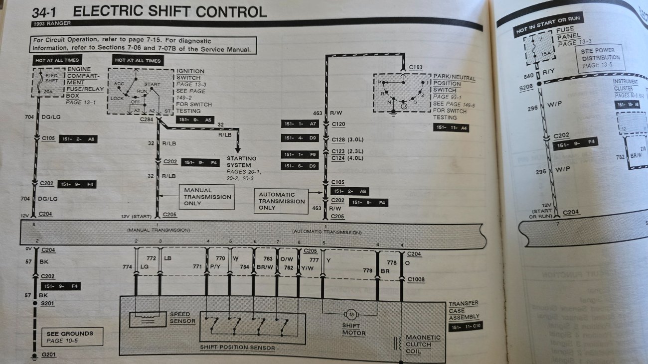

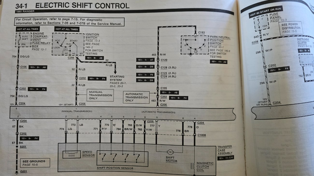

Here are the wiring diagrams ('93). In '93, that wire did pass through the plug. However, I can confirm that in my transfer case, that wire is brown. My orange wire actually goes to the motor windings.
View attachment 143897View attachment 143898

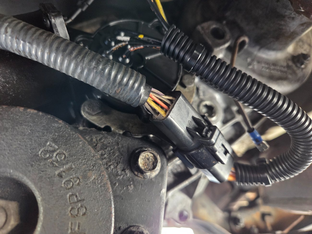

Can you get a picture showing your transfer case, shift motor and plug/plugs? It would be helpful to see exactly what your setup looks like presently.
It's probably fine. It may not have cycled fully into 4-hi or 4-lo. It is best to shift it quarterly or monthly to keep the lubrication stirred up and clean the position contacts in the motor gearbox. If that is done, these things are very reliable.

Best pic I can get. You can see some wires from the plug, and the extra wire hanging from the transfer case itself...
