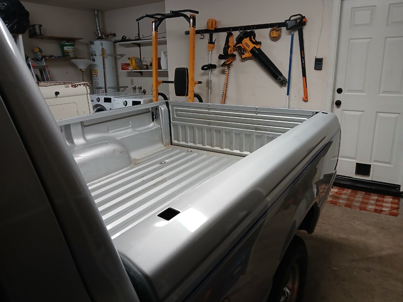

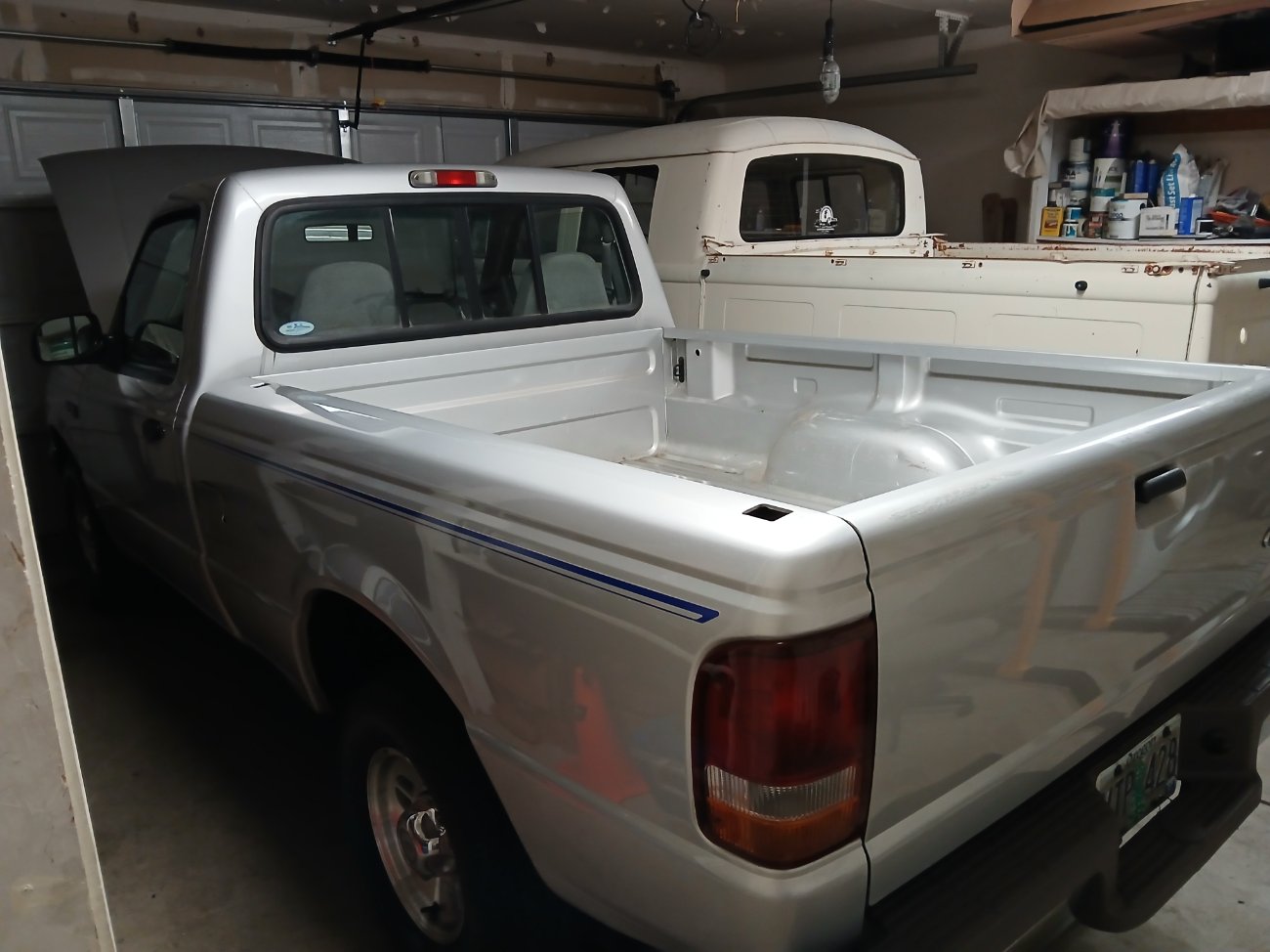

Sold the camper today and also had it removed. Cleaned all the dirt and grime off the top of both sides of the bed and tailgate. Looks better all around. Applied some touch up paint in a few areas.

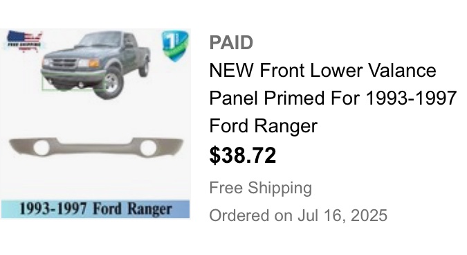

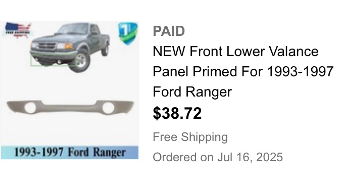

I broke down and ordered the driving light/fog light valence for the Road Ranger. I think I’ve looked at every 93 to 97 Ranger they’ve had at the pull-a-part (they post pictures) for the last three years, and the only one I saw was broken and missing a piece, and I never found the lights. I hate buying stuff at retail.
I have some new in the box Amber halogen driving lamps I bought for a Mercedes probably 35-40 years ago that I think will work. I have two sets, but I’m sure I’ll use the other set in the next 30 or 45 years.

$38 is hardly “paying retail”. The last one I bought was back when you could only get them from Ford and they were almost $200. Within hours of buying it, I heated it with a heat gun and propane torch to reform it for my 2nd Gen bumper.
If I bought a new one at retail, and then I had to heat it and reform it, I’d be really pissed off! It’s the principle of the thing
