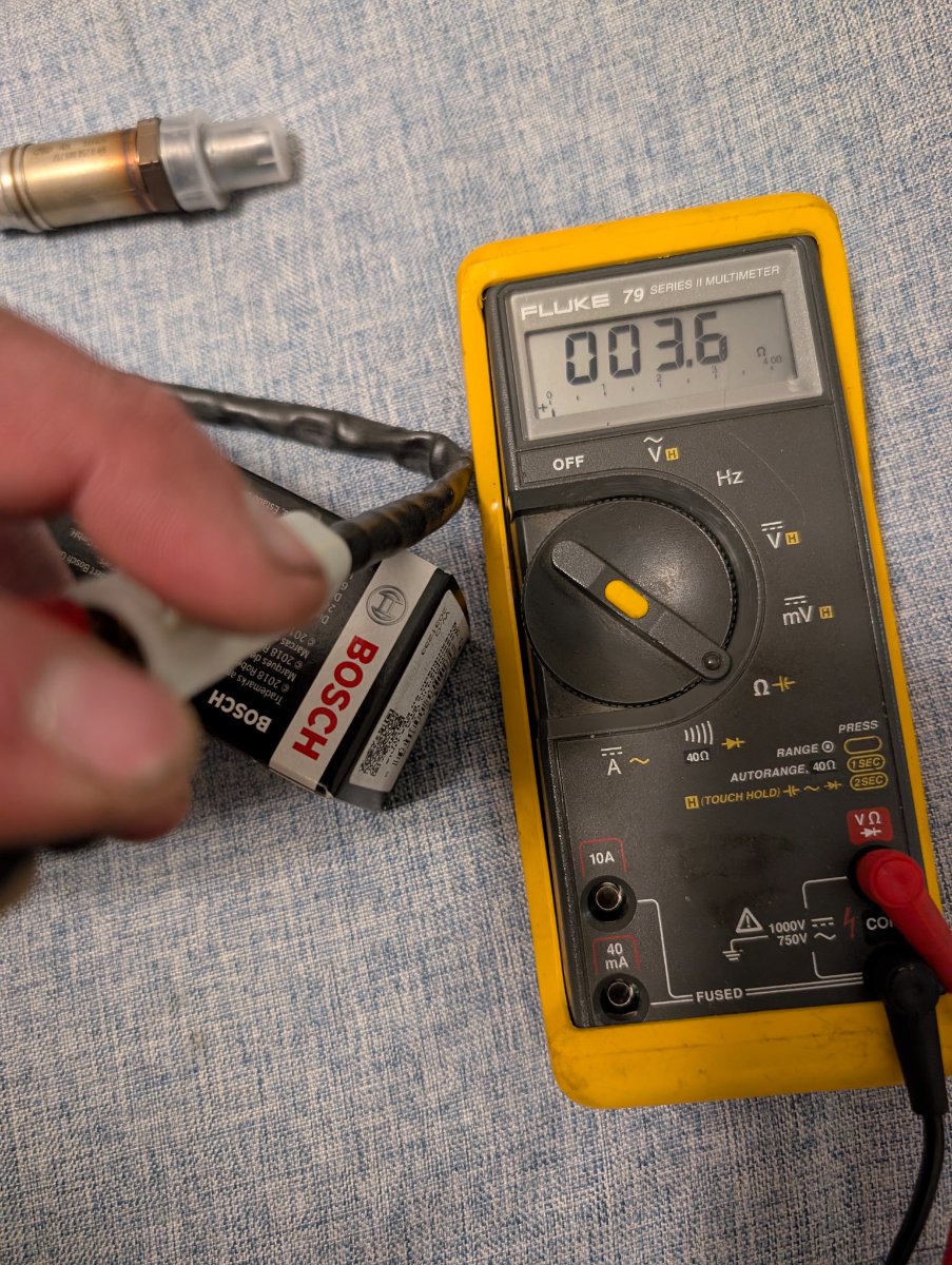

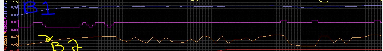

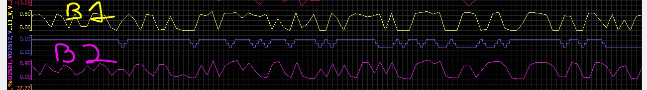

Last week the Money light came on for a P0133, bank 1 O2 switching too slow. Logged with ForScan and sure enough bank 1 sensor 1 was flat.
3 days ago the light went off right after I bought a Bosch 15717 to replace it. Logged with ForScan today again and sure enough it's working again.

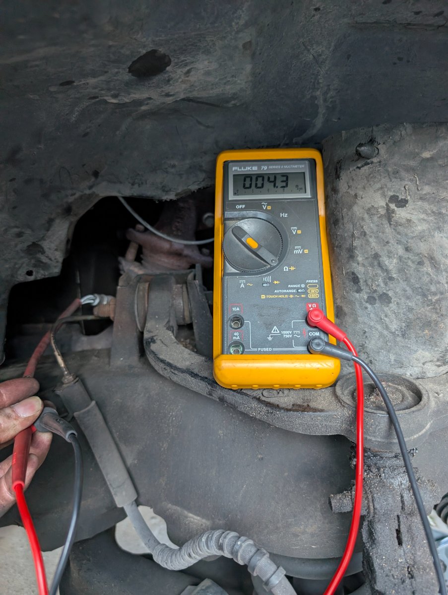

Resistance of new O2 is 3.6 and the original one is 4.3
Going to run it till it stops because it's probably going to get destroyed coming out based on how it felt today while I tried to remove it.
Does the resistance difference indicate an issue?
