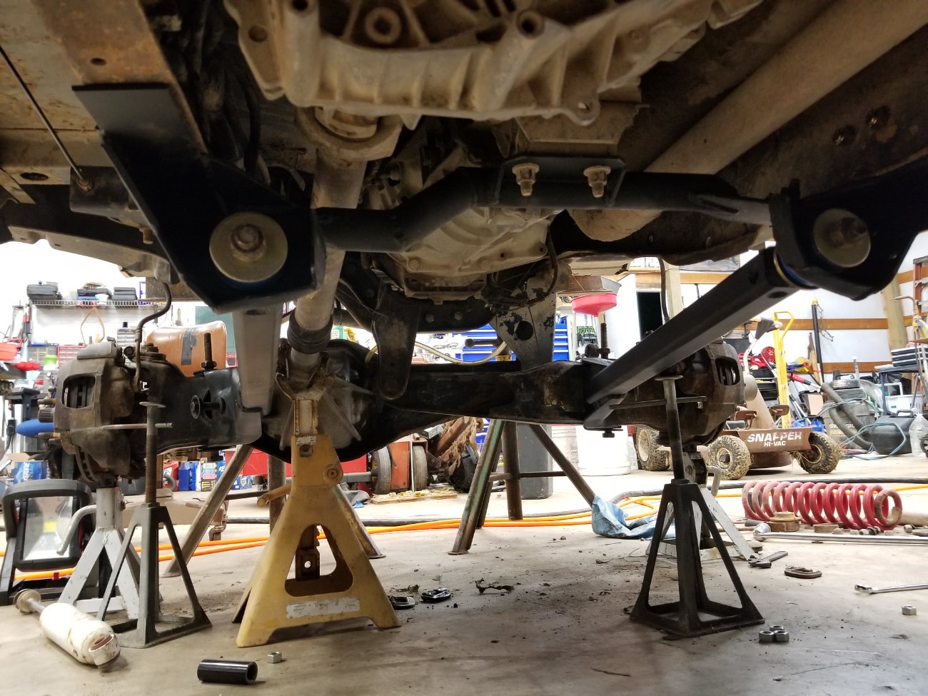

If it helps any this is what I did, of course the radius arm pivots aren't necessary and would definitely make it simpler without incorporating those into the setup...

Yeah, I have different radius arm mounts and they are right where the crossmember goes. I’ve been trying to decide if I want to get the crossmember to sit on the frame rails and bolt to the mounts or just bolt to the mounts or a bit of both… I’ll have to get a pic I guess. Probably gonna make it out of 3” C-channel, I just need to figure out how I want the ends to work

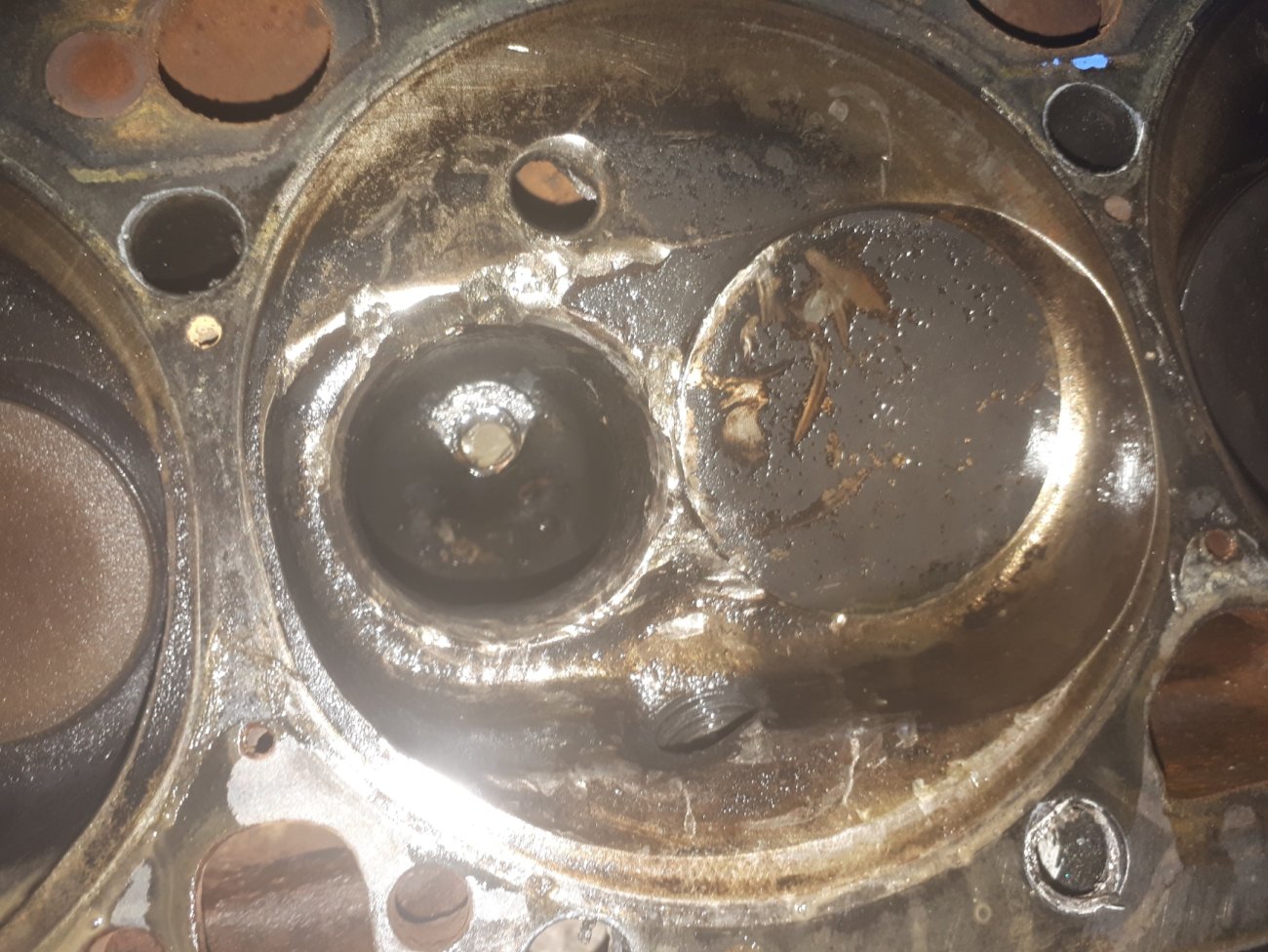

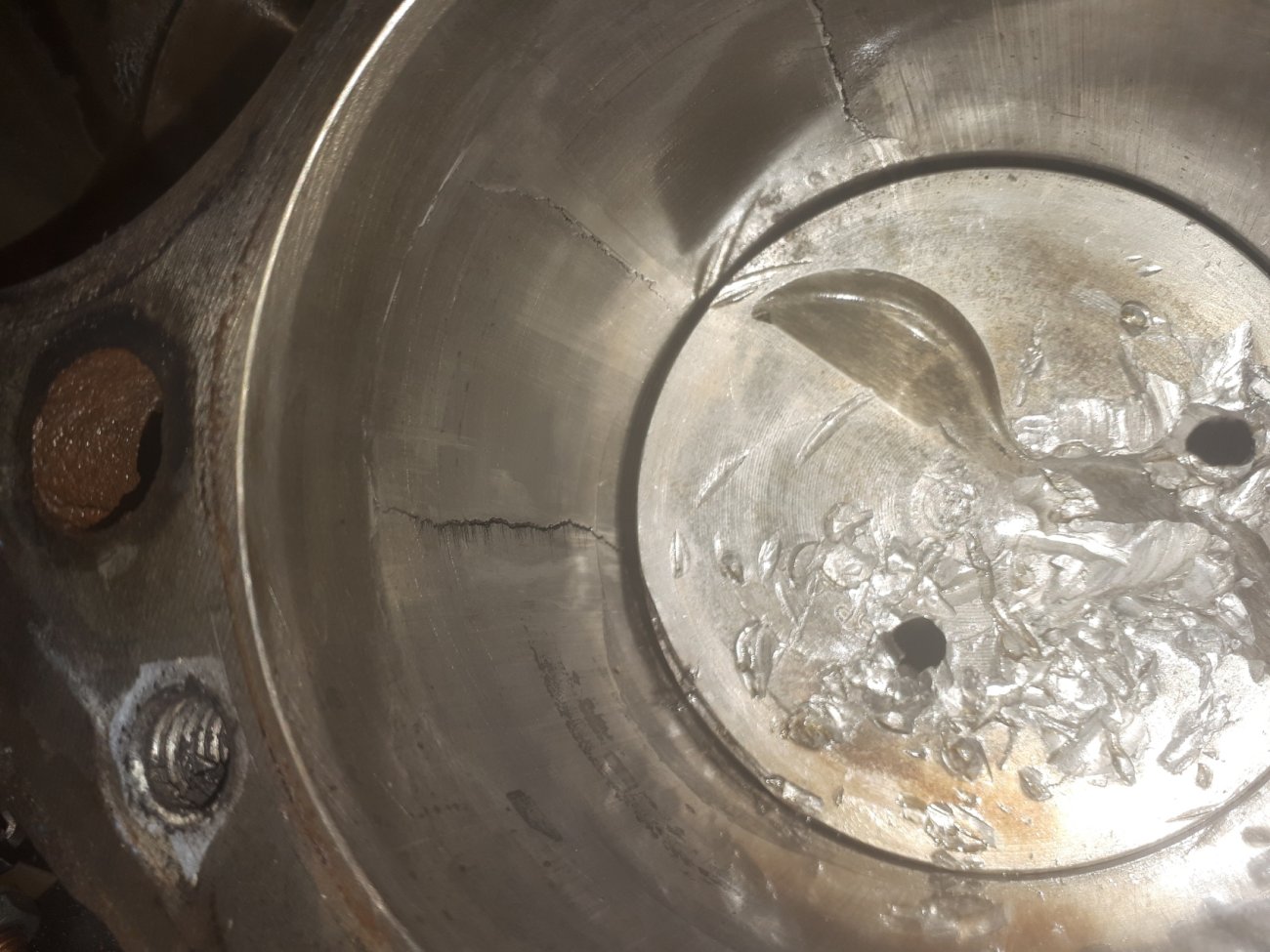

Last race day we had CATASTROPHIC FAILURE of our Ranger's engine....... Happened right as I took my foot out of it at the finish line. No sign of the missing part of the exhaust valve so it probably went out through the port.
