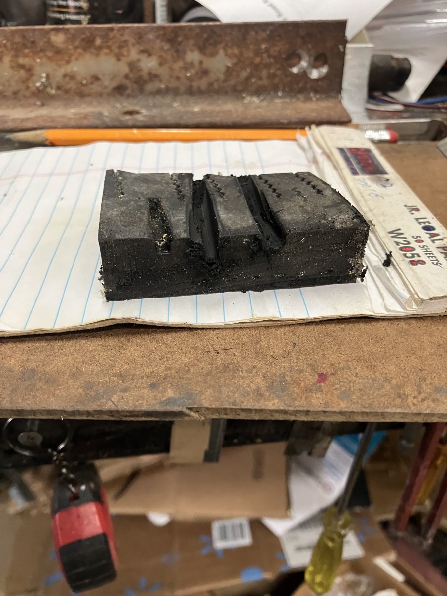

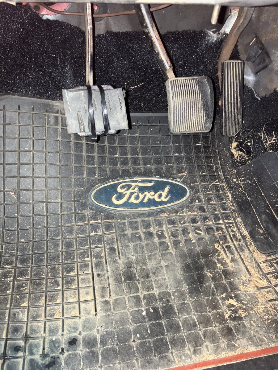

I also took a piece of a tire that I cut apart to make a push bar for my 73 F350 wrecker way back in the day, to make a pad for my clutch pedal to extend it out a little bit. No, I didn’t tow anything, it was just another big toy. The tread was about 7/8 of an inch thick, so I cut a piece the right size, and I put a couple of grooves on it so I could attach it with zip ties to my clutch pedal without my foot wearing out the zip ties.
I’ve only driven it a couple miles, but it’s working perfectly. That thing has a stage 3 clutch in it, and I have to touch it to the floor if I don’t want to grind some gears. That meant I had to have the seat up too far or I have to grow longer a longer leg. Between the added grip, and that almost added inch, it seems much more comfortable. This is just a temp, and if it works OK, I’ll figure a way to mount it more permanent than relying on the zip ties.

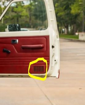

@Rick W , the vents that are supposed to let air escape are in the doors. There’s a little flapper piece behind the door trim
