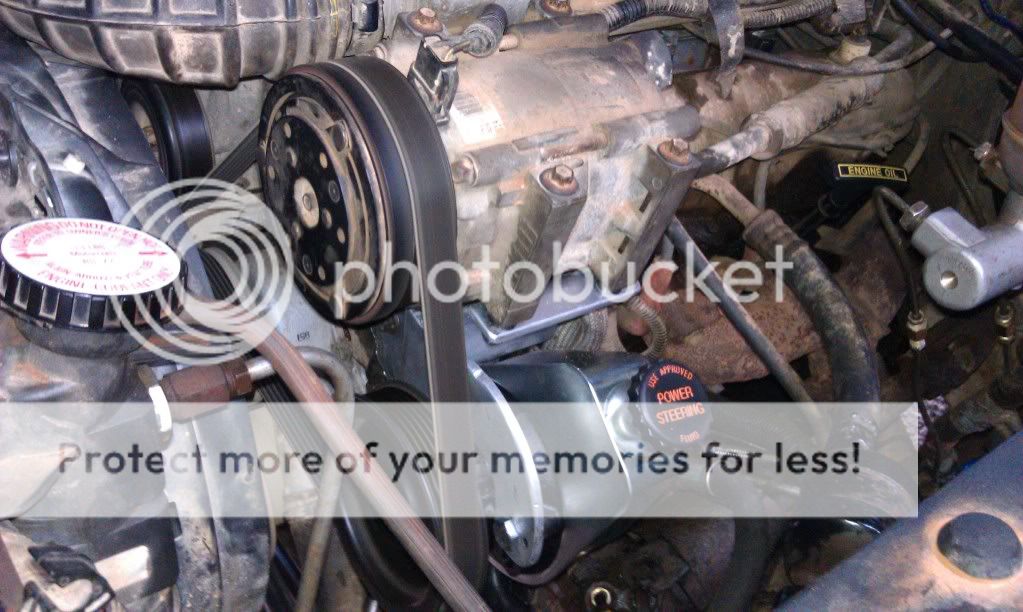

Just wanted to update my progress also. I've swapped to a working pump, got the A/C compressor shimmed and the stock belt back on. I've been driving it for a few weeks now and what an improvement! Silence is golden (and duct tape is silver)
Pic is with the motor running.
