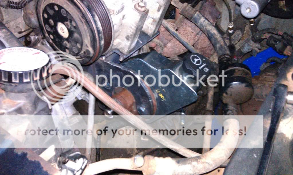

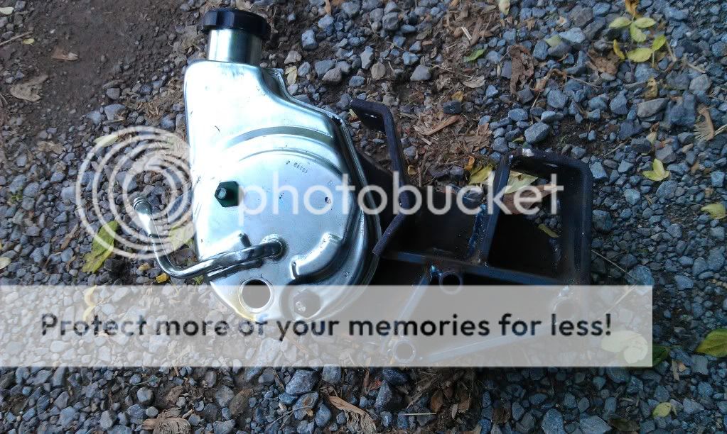

New thing I was working on was to just swap the whole thing for an easier to find pump.
Built a new bracket that will hold the readily available GM style Saginaw pump. The pump I have mocked up is a PSC pump that is sold for a Saginaw conversion on an early bronco.
Even added the mount for the A/C compressor. Fits perfectly.
I've got to press the pulley on and swap the line over.

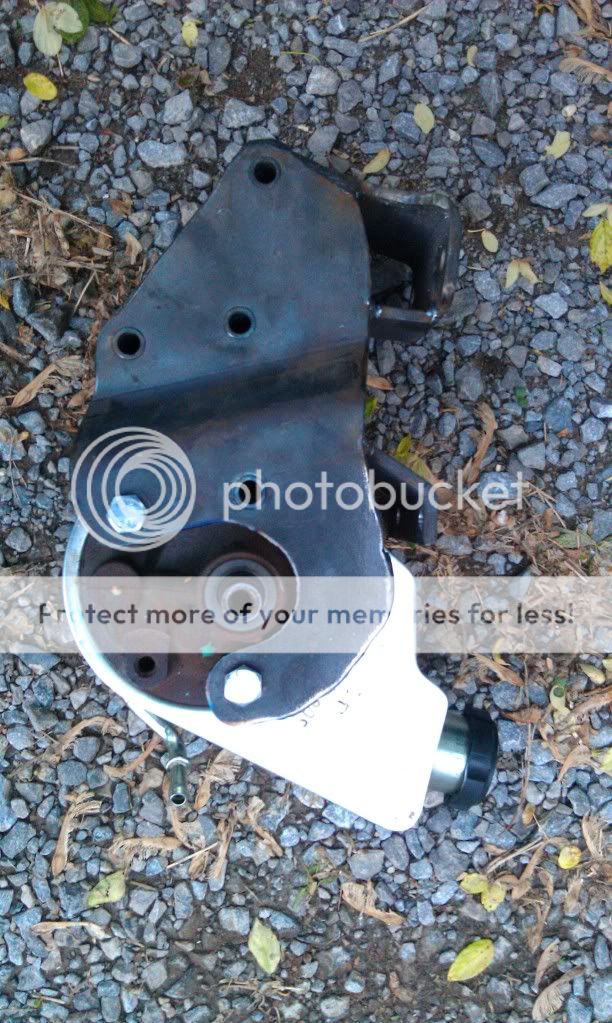

Sounds good. Is the bracket in the pics the first prototype you are basically testing?
Yes. I cut the pieces out with a plasma cutter and welded it all together. I used the factory bracket to make the jig so all holes and mounts line up. I made flat patterns and gave them to the laser cutter so all future brackets will have a better finish. The center of the pulleys have a difference of 1/16". I'm sure the belt tensioner can handle such a small difference but I will change the bolt holes to fix this. I should have my pulley on and a new hose by this weekend. As soon as laser cutter gives me my quotes I will be able to nail down pricing.

Had to pull it back off to put a new pump on and clean the bracket up. Took a couple more pix of the bracket.

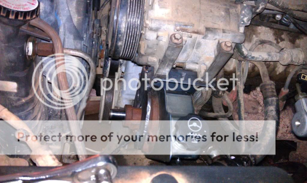

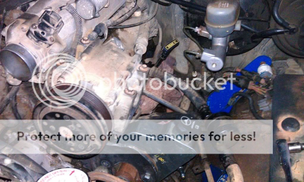

Got it in and hooked up. Need to shim one side of the A/C compressor to get the belt to tighten all the way up. Luckily I had a standby A/C delete belt laying around so I put it on. Had a new pressure hose made with the Ford fitting on one end and the Saginaw fitting on the other. I ran it for a few seconds without the return line hooked up to get all the old fluid out. Then filled it and got the bubbles out. Steering is noticeably different.
Let you know more after I drive it tomorrow.
