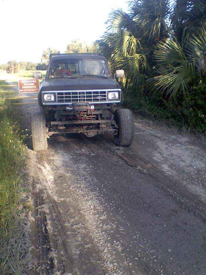

this is fullwidth and the one with the tube doors and swampers is with a d35...the tires stick out the same due to wheels....and of course with the big 42's they stick way the fawk out but can be 4 inches narrower with different wheels...that comes at a cost of potential turning radius loss and tire rub though.

good luck running 42's on an eb axle.:D
this is my b2 with eb axles, its 351rangers old b2. of course my daughter stole it. but i did manage to get it back after she left for the airforce. so i regularly drive and own both and plan to build a fullwidth d44 ranger ttb....well...d60 ttb....as well. so its from experience.
it drives good and i have standard 150 wheels on it too so the wheels are way in, and i destroyed one of my street radials because of it. so custom inboarding of the radius arms or custom radius arms are needed. this happens when you just do a bolt in job with it....it is one of the compromises, but it is a cake walk few hour deal so it is easy to live with.
in direct comparison, fullwidth axles are leaps ahead in handling to my taste.
