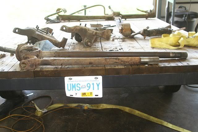

And looky what showed up in the mail this afternoon!
Big thanks goes to Andrew Wahlstrom for this kind donation!

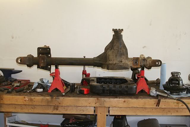

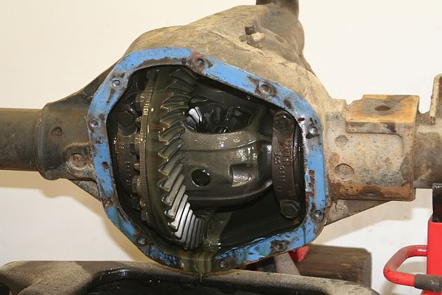

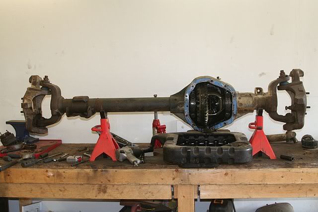

All stripped down...just need to bring home my 1 1/8" socket to get the pinion nut off from work tomorrow, then everything will get steam cleaned and ready for narrowing.

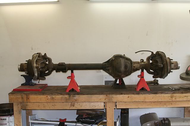

Well as I was already egging out D35 shafts constantly, I didn't see the point of going to the D44. Plus the D35 in my ranger is at that point where it needs all new steering linkage and bushings throughout. Instead of dumping anymore money into it I'm going this route.
So far I'm at a grand total of $123.00 for this D60.
$100.00 for the entire complete 1993 D60 hub to hub
$23.00 for shipping from Alberta for the shortened and resplined axle shaft from Andrew.

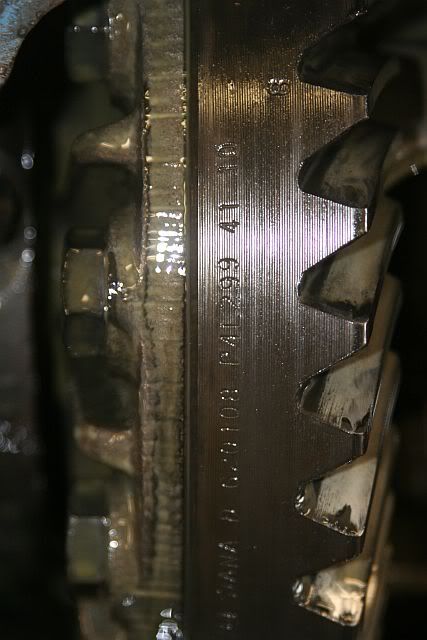

Nice, you did pretty well on gearing too. Do you have any ideas what suspension setup you will use?

I'm going to be converting it to 5x5.5" bolt pattern and running a Superior gear and axle Super 88 kit in my explorer 8.8.
Going to be regearing both axles to 5.13
