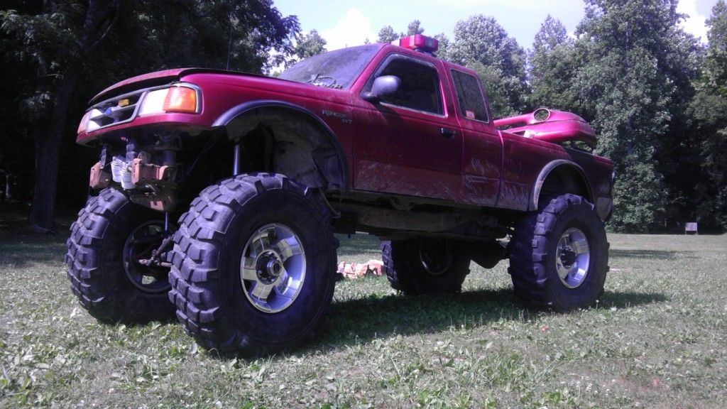

Once I graduate in June and find a nice job gonna convert my ranger over to a trail only rig and def run some air shocks. For the price u can't best it
