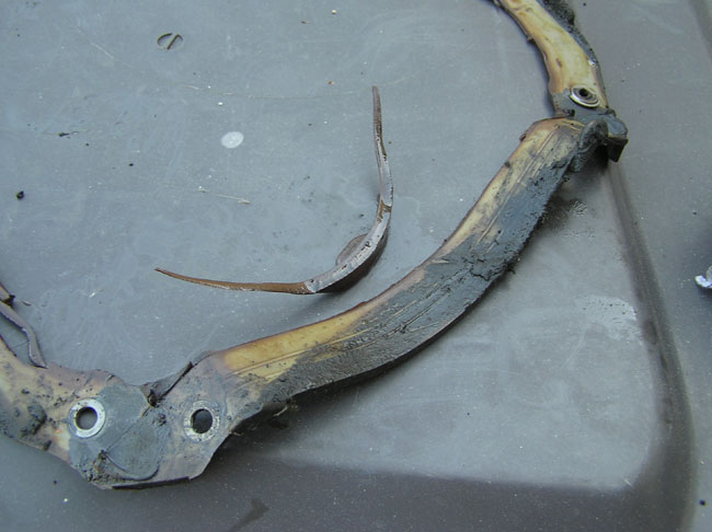

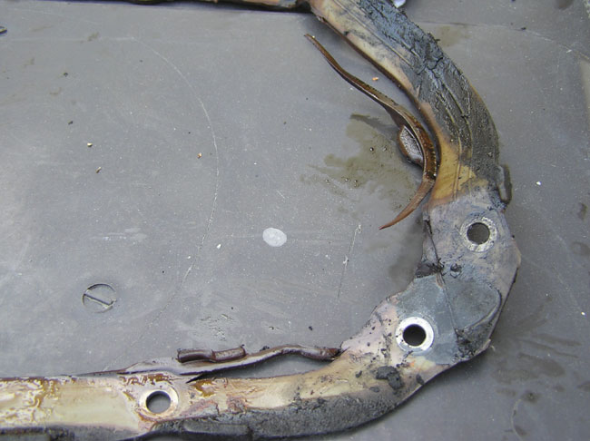

Here are some pictures of the old gasket. It's very much a materials failure. The rubber just couldn't hack the heat. The the inner edge that is exposed to the hot oil is stiff and brittle. You can see the black band on the front of the gasket where it was sticking out. The gasket originally had a tab molded into it to help prevent it from working out in that area. That tab and the surrounding material completely peeled off and was in the bottom of the pan. There are other broken tabs and the areas where they are missing were pushing out as well. I assume that the revised Ford gasket was changed to a more heat resistant material.
With that in mind, using the OE type gasket, you probably could stretch it around the outside of the pan to get it in place without removing the pan completely. The down side of this trick, is you don't get to clean the debris from the gasket failing from inside the pan. The pickup screen on the oil pump is pretty coarce so there is some danger of that crap getting sucked into the pump.

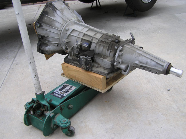

As a side note, I make a quick and dirty trans adapter for my floor jack. It worked a lot better than it looks. It's a piece of 3/4" plywood with some 2X4s screwed to it. I made a collar to adapt it to the jack so it would swivel. It made taking the trans out a one man job.
