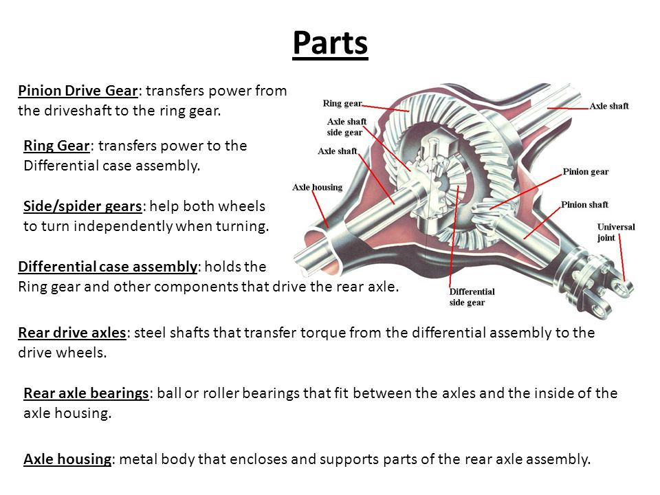

In the picture below, over toward the right side, the label “u joint” is pointing to the yoke that holds the u joint on the drive shaft. The yoke in this picture is bolted to a flange that is held on the pinion shaft by a big nut.

Best idea, don't remove the yoke or flange unless you have to because the size is different. Get your new axle in place and see if everything bolts up. Sometimes, you don't have to touch the yoke or flange. Or, if the yoke is bolted to the flange like the picture I posted, just replace the yoke but leave the flange in place.
