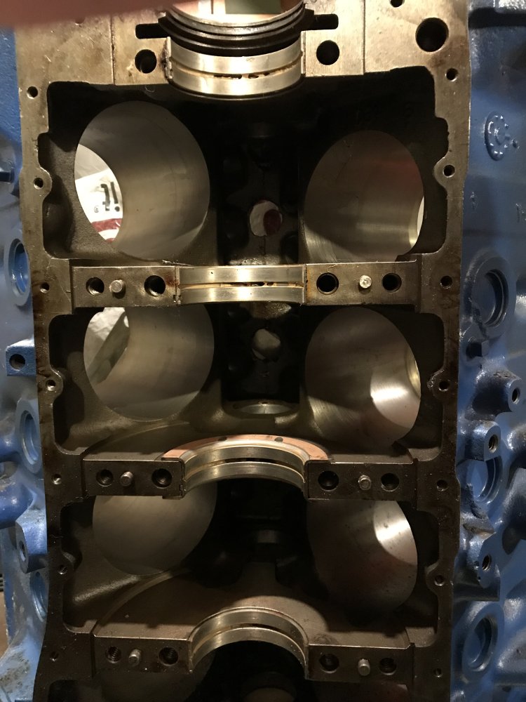

nothing new about 4 bolt mains. I have a '69/'70 460 block that has 4 bolts on #2,3,4. the front & rear are just 2 bolts.

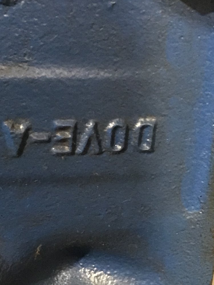

That sounds like a 429 CJ/SCJ block, I've never seen a 460 with 4 bolts. Check your casting numbers, you may be able to sell it for big bucks.

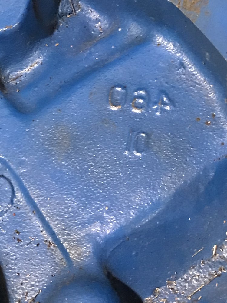

@19Walt93 the engine was indeed a 429 SCJ, even though the block is marked 460. it's a DOVE-A block.
it was rebuilt with a 460 crank about 35-40 years ago.
the 460 is cast into the bell housing surface behind #4 I have no idea what the 01 is.

Someone restoring a 429 SCJ Mustang or Torino might pay top dollar for that block. Who knows why they cast 460 into it, every 428 CJ/SCJ block has 352 cast into it, too.
