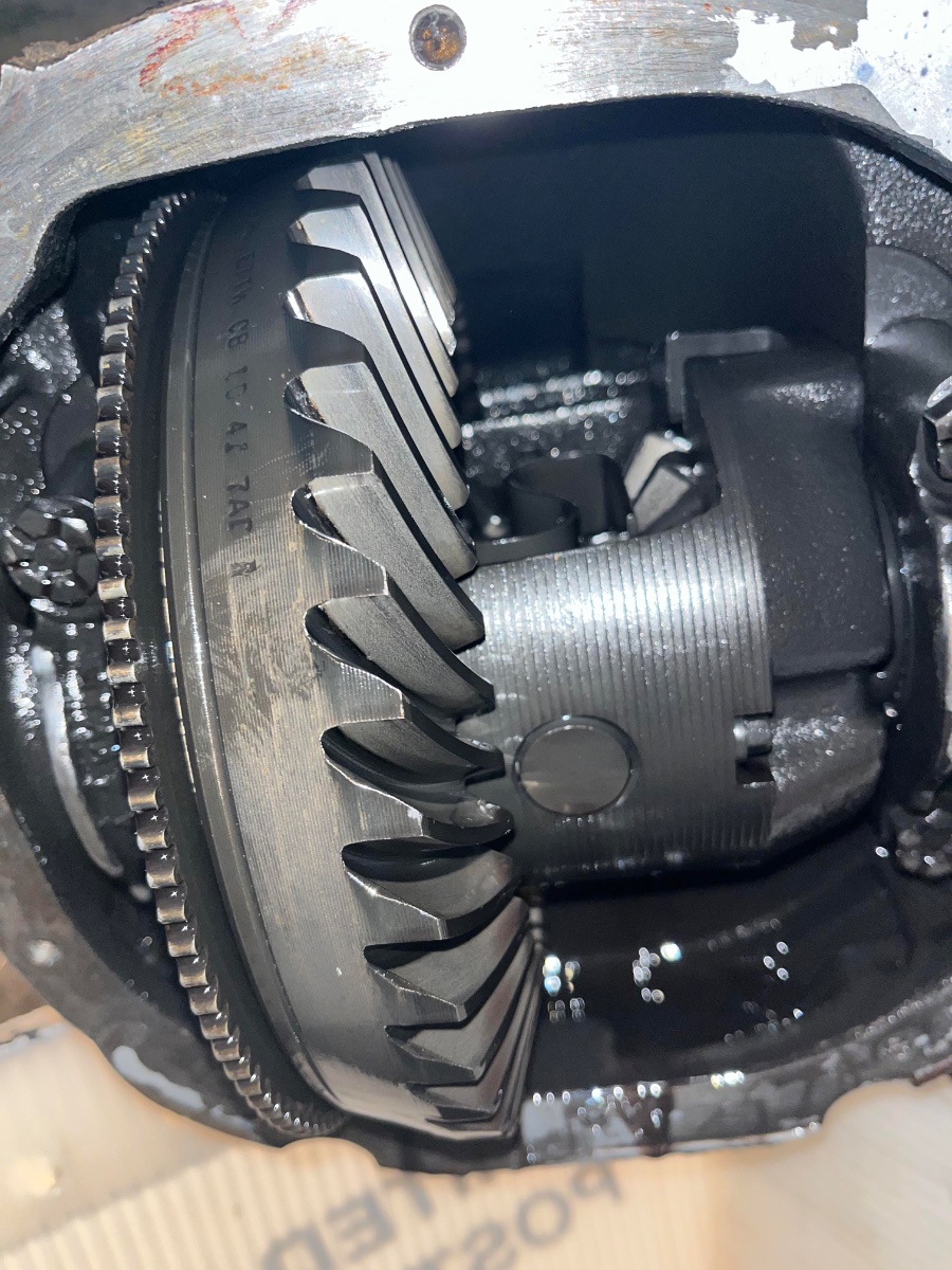

The 108 tooth ring is the one that would mount to the carrier behind the ring gear. The ring gear in an 8.8” differential is 8.8” in diameter. So the tone ring is slightly smaller.
Ideally, you would buy one of those aftermarket setups. Then you would have a tone ring that mounts behind the flange in the pinion shaft outside the differential. Then thr sensor would be mounted close to it. The electronics package that comes with that would then be programmable to calculate the pulses you need to replicate the 108 tooth OEM ring and sensor.
For clarity, here is a view of the inside if the differential. On the left side, you see an edge view of the ring gear. To the left if that is the 108 tooth tone ring. Both are bolted to the carrier using the same bolts.View attachment 131322

I now understand what you guys mean, I thought it needed to be the same o.d. as the tone ring inside the dif.
