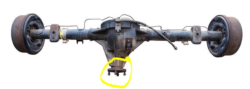

It's not dependent on gear ratio, It's mounted on the carrier so it's measuring axle shaft revolutions, it could care less how fast the pinion gear is spinning.
If you put the tone ring on the pinion flange between the pinion and driveshaft, then you need to account for gear ratio.
32 teeth on the drive shaft vs the 108 ring gear with a 355 gear is really close. you dial it in from there. but if you have a tone ring diff your golden.

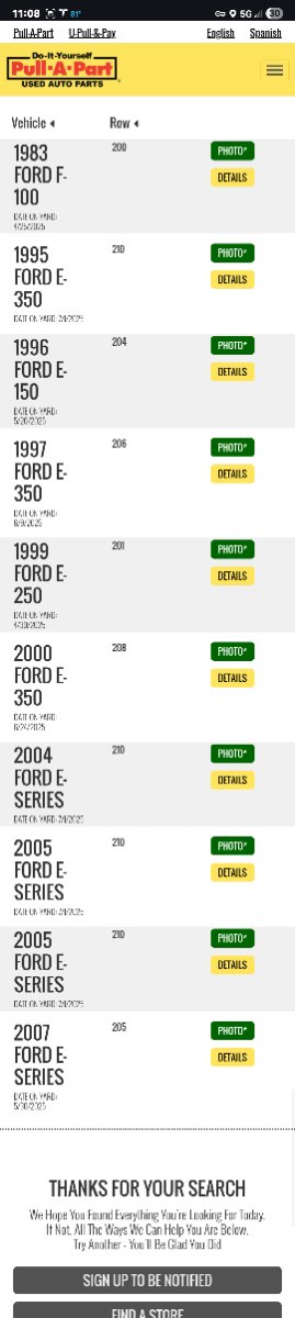

The current wheels on that rear end i jave are 14", i would like to go with 16". Between 3 people we couldn't barely lift the whole thing, its pretty heavy.
I attached a picture of whats available right now in augusta but now i believe i understand the dana 60 have to be from a cab and chassis and not a regular van, it that is the case, i now it will be a pain to find one, most likely.

Thanks alot for the offering. I'm going to check the atl pull a part inventory to see what they have. If for some reason you see something available in the area, please let me know.

Mount the tone ring here/ or at other end of driveshaft between the flanges if possible
