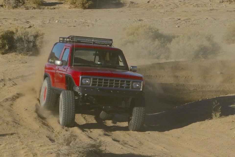

Quarnstrom knows a few things about building Fords. His shop was at the forefront of killer Rangers, and has moved into late model full size Fords and Toyota’s, has owned the little B-II for a long time, and uses the rig for his annual Baja fun run (he and some buddies do the peninsula every year). That’s not a place where you want to be driving a vehicle that isn’t up to the challenge.

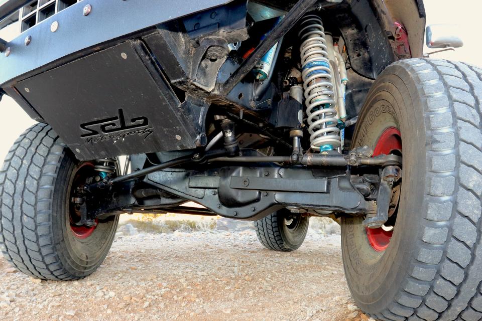

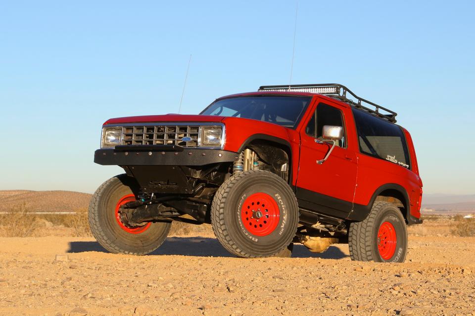

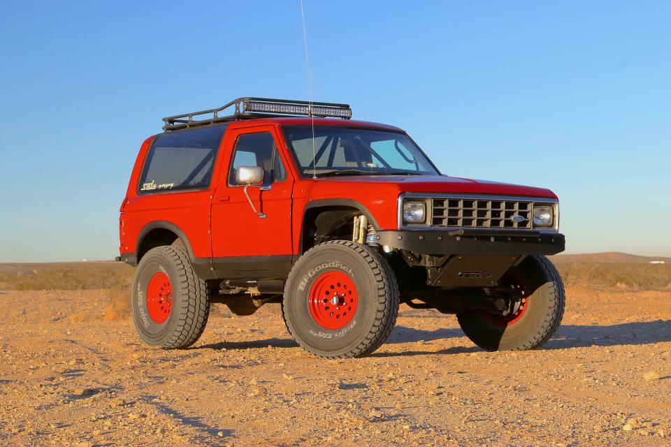

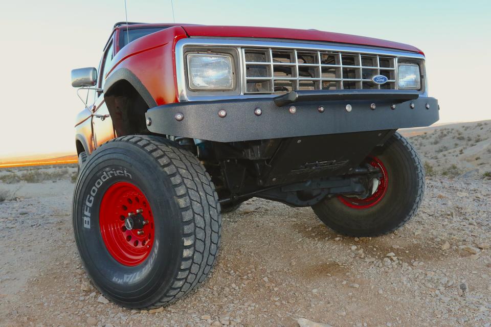

And amazingly, this one is. Quarnstrom used the stock ford frame, but he added a full roll cage to it. Then he installed a Dana 35 front end using 4-inch wider Solo Motorsports I-beams and the Dana front disc brakes. The 4-inch per side wider beams are important to the overall package, as the stock II was way to narrow for its height and even now fits into the tightest sections with ease.
Ford Bronco II Solo Motorsports Axle Beams

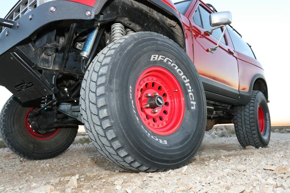

The Solo Motorsports I-beams are 4-inches wider than stock and hold the Dana 35 securely in place. A pair per side of King shocks and a King bumpstop ensures that no rut will be too deep, no rock too tall.
Quarnstrom topped the front end off with a pair of King shocks per side. The King’s in question are 2.5 coil overs & 3-Tube Bypass units that are accompanied with a set of King 2.0 Shorty Bump Stops.

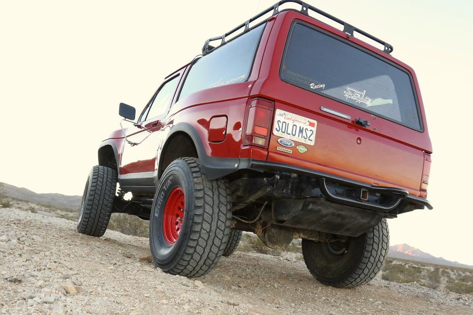

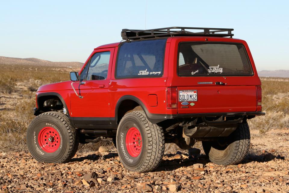

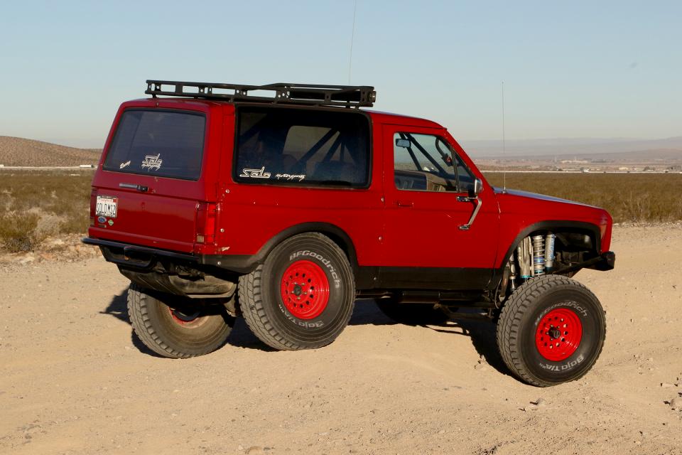

King shocks are also used out back, as 14-inch long, 3-Tube Bypass units connect the 8.8 Ford Explorer rearend to the full cage. The 8.8 has been equipped with a Detroit Locker and 4:56 gears, and Driveshaft Specialties of Azusa, CA. did the driveshaft work. A set of Outlaw II 15×7-inch wheel were powder-coated red to match the body color and equipped with 35-inch BFGoodrich KR Baja T/A tires.

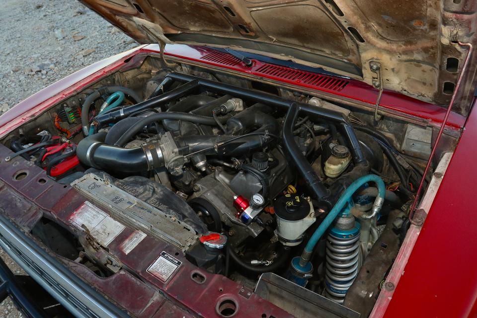

Those are big tires, and since horsepower was something the stock B-II was sorely lacking, Quarnstrom swapped in a 4.0-liter out of a 2005 Ford Explorer. For reliability’s sake, the inside of the V6 is stock, but a K&N air cleaner has been installed.
The exhaust needed some fabbing though, so Solo Motorsports built custom fender wheel-well headers that actually run outside the frame. A fan-equipped CBR trans cooler keeps the C4 automatic transmission cool and happy even in the hottest Mexico temps.

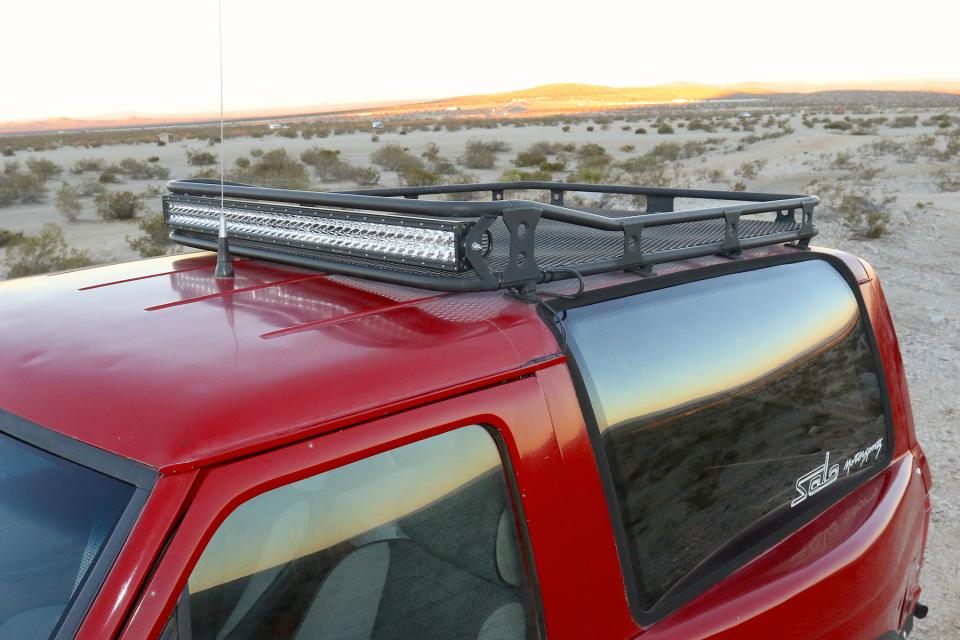

A set of 4-inch wider Fiberwerx fiberglass front and rear fenders give the BFG’s somewhere to go while the red paint job ensures that everyone know the B-II is around. A Rigid Industries LED light bar fronts the Solo Motorsports roof rack, and it was of course Solo who built the front and rear bumpers.

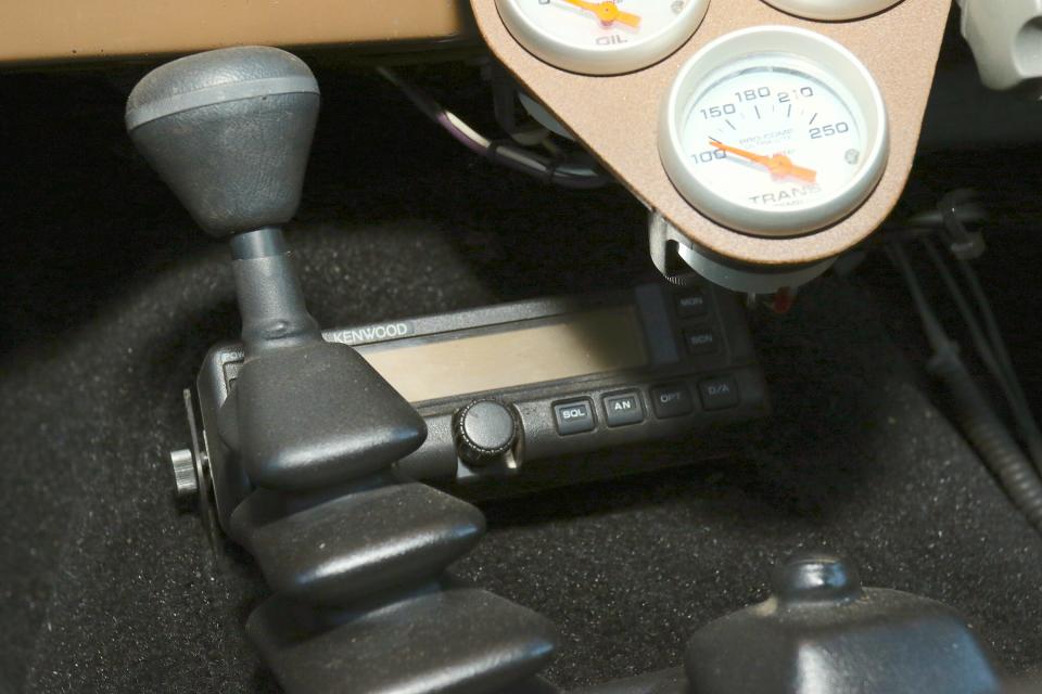

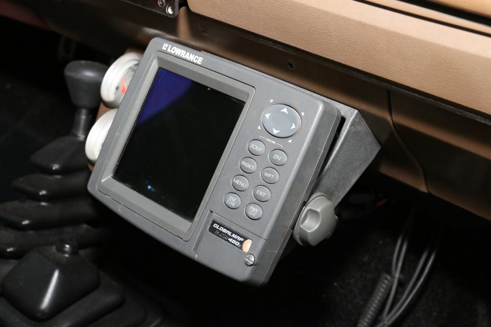

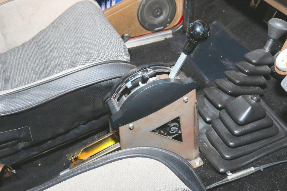

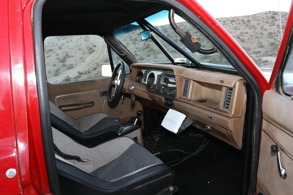

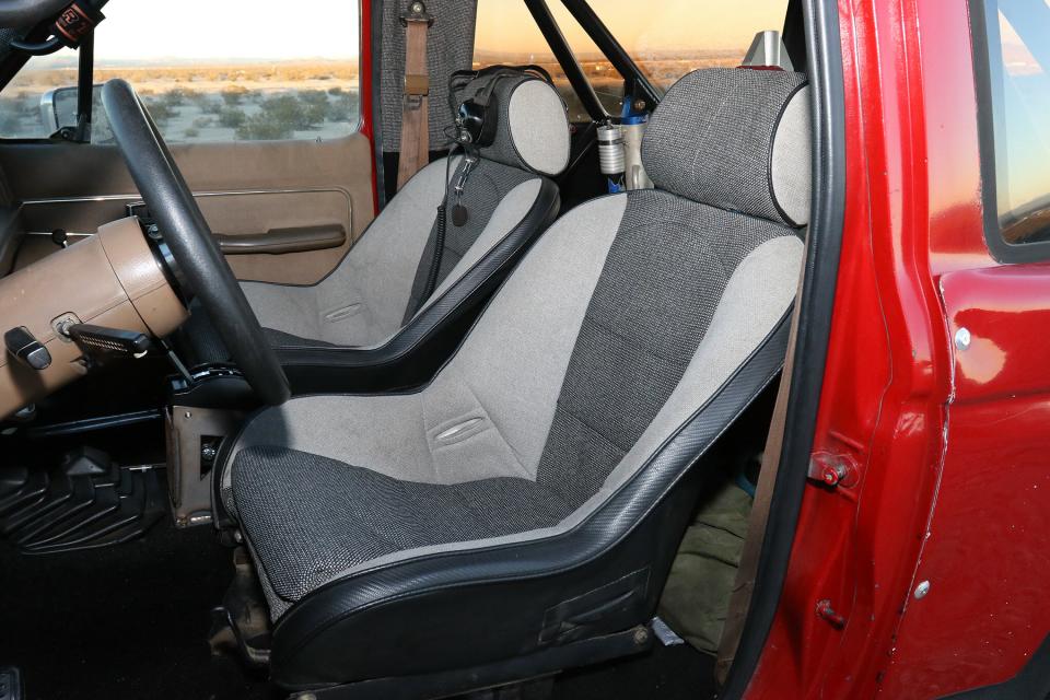

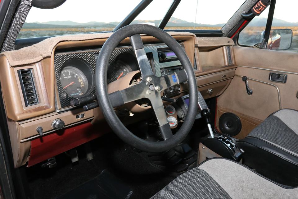

There wasn’t much room inside a stock Bronco-II, but with the full cage, PRP seats and other items, the inside of this Ford is tight. A flat Schroeder steering wheel helps some, and the Art Carr floor shifter tucks in between the seats well, but the Lowrance GPS is just waiting to bash someone’s left knee.

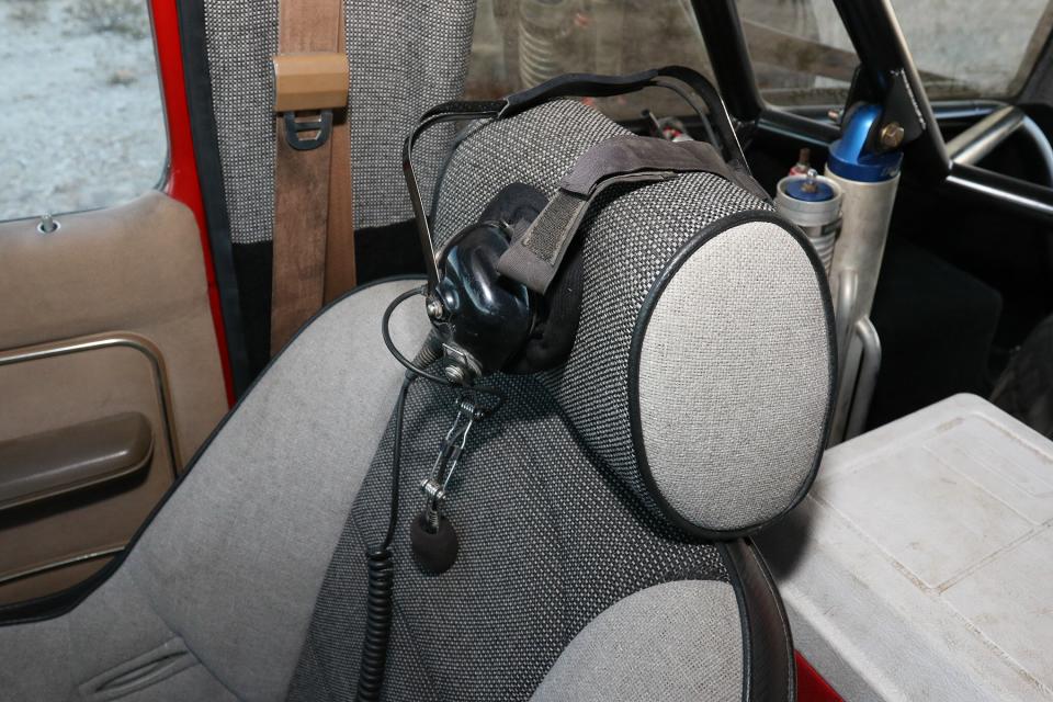

The dash is stock, but Auto Meter gauges replace the idiot lights, and though the stock stereo plays tunes, a 110-watt Kenwood race radio system, complete with intercom and headsets, is the frequency of choice when on the trail. Quarnstrom credits Mike’s Upholstery for being a big help with the interior.
