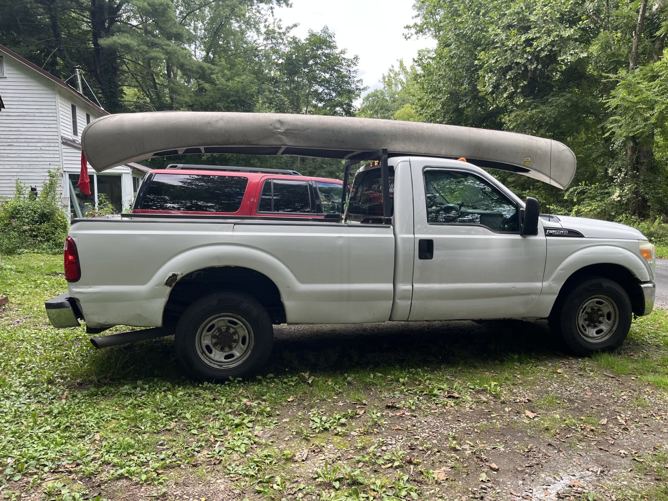

Looking for some suggestions on mounting my canoe for longer highway trips. Trying to see if anyone has suggestions or tips.
I have a 17’ Grumman I normally carry it like this, but I’m usually only going a few miles to the river or lake. It works well, but the front is pointed up some and catches a lot of wind.
Canoes
It seems better on the F250 then the Ranger due to the longer bed.
I’m considering trying to get it more level because a have a trip planned for September that will take us on the highway for 2 or 3 hours.

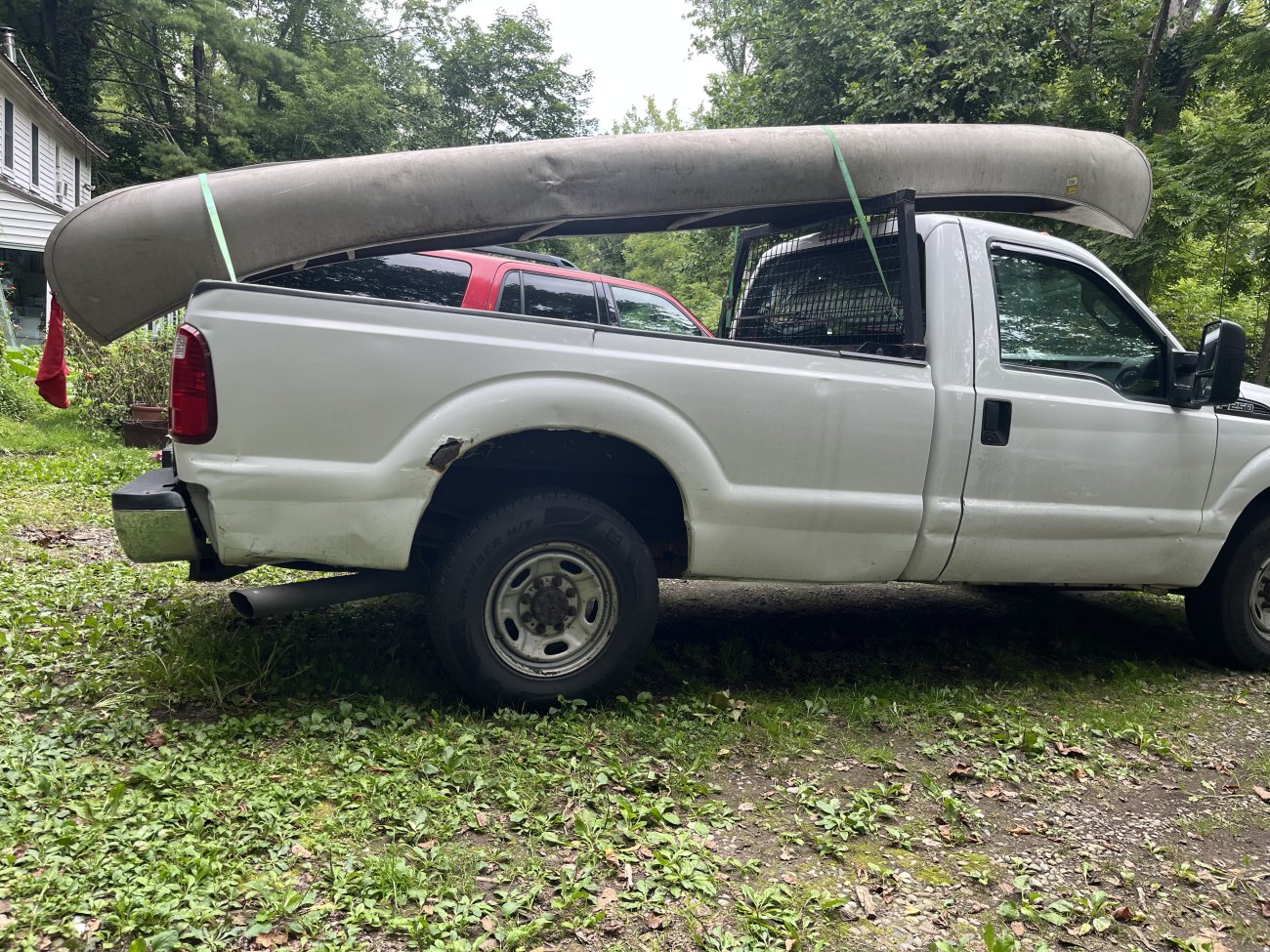

This picture is of the canoe balanced on its center.

Its not too hard to cut 2x4 to fit in the stake pockets, a 2x4 across, and triangle plywood to stiffen side to side movement. You won't have to worry about front to back as the tied down canoe will prevent that. Use ratchet straps to tie it down anchored in/to the bed.
The only suggestion I have is a rear rack the same height or slightly taller than you have on the front.

Mostly I wanted to know if anyone had experienced that it was better to carry it one way or the other.
Level, pointing uphill, pointing downhill?
The headache rack has mounting holes for a light bar, so I'll probably bolt a 2X to the top just to pad the Canoe.
I was actually considering suggesting something like that as well for a little more clearance between the canoe and roof.
As for the level, uphill, downhill thing... Given the way air flows around the cab while driving down the road, I could be wrong, but I don't think it's going to make that much difference.

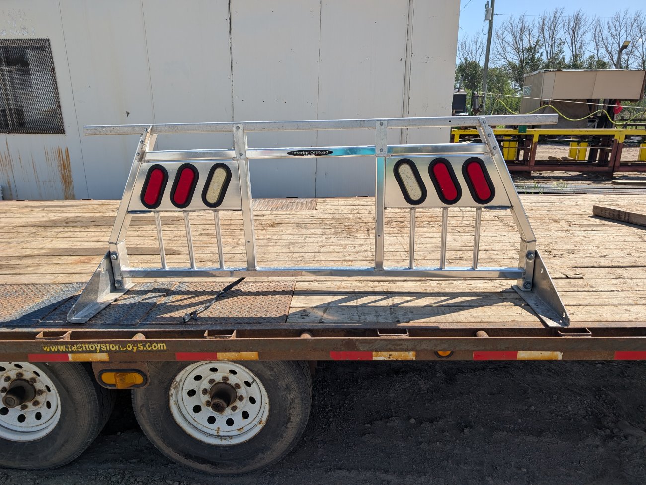

Not necessarily for carrying the canoe, I added about 3" extension to the top of my headache rack. That way I didn't worry about scraping the roof when I loaded stuff. The rear rack I had a few inches lower so it was easier to push stuff up and onto the front rack. With a canoe I would probably make the front 6 or 8" taller so you could load from the side of the truck, front of canoe first then walk to the back an lift the back of the canoe up. That way your not liable to ding the cab top. With ratchet straps you don't have to worry about wind shifting the canoe sideways, compared to ropes. This is speculative for canoes. But I've made a living doing siding and have 40 years experience loading all major of stuff onto my roof racks. Unfortunately I just sold them.
Canoes
Here you can see the extension I put on top. I hate the way they make headache racks follow the cab, that loses too much area for ladders and lumber. So I make mine wider...
