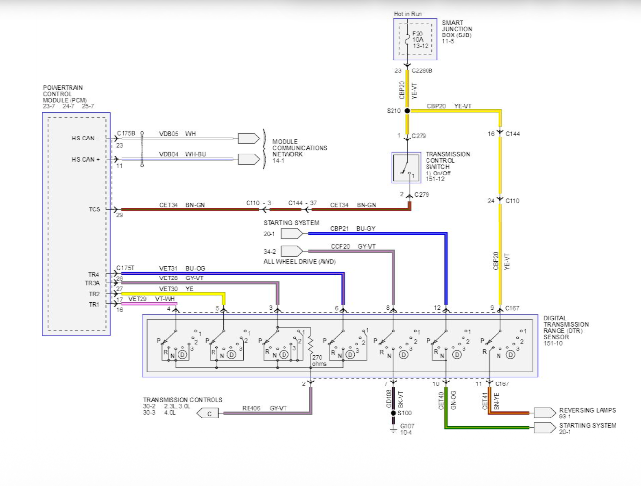

One thing I've been thinking about, if I wire the drive position sensor to the clutch switch, it will have the 3k limit when I push clutch in, making rev matching a lot harder. I may just wire it to a manual switch I can flip for starting/driving.
Found them.
First one is the pin out on the connector, second one is a diagram of the automatic transmission wiring harness.

I thought about the switch/ clutch thing in relation to the rpm’s.
It hasn’t caused me any real issues. I’ve got about a 1000 miles on it since the swap. Maybe I’m just not noticing it.
Did you happen to record which wires were necessary for neutral/drive? Based off the wiring diagram it looks like pin 10 (GN-OG) to pin 12 (BU-GY) would enable starting (i assume this means it's either in neutral or park) and one of pins 3 (GY-VT), 4 (VT-WT), 5 (YE), or 6 (BU-OG) connected to pin 2 would be Drive. Unfortunately my grand idea of multi-metering the DTR did not go as planned. This is what I've been referencing.

I believe I wired the GY-VT and BLK-VT wires to the clutch pedal, when it’s pressed in it connects the two wires.
I cut them off the connection.
Left the DTRS plugged into the harness with the dial rotated to the Drive position.
I’ll have to check later to confirm, but I know for sure I still have the DTRS connected and set to drive all the time.
Holy cow that was unpleasent. But I have it figured out. If anyone else is reading this, here's how I did it:
Clip every wire from the DTR sensor, but make note of the three Purple-Grey wires and their pin location (on the DTR plug, but it's not critical if you don't).
Strip the BU-GY and GN-OG wires. Connect these together with a single pole single throw (on/off) switch. This is enables you to crank.
Next, measure the voltage between every single Grey/Violet (GY-VT) wire and ground (you just need the ignition on for this).
Next, strip the 0V and 5V wire - you will need to wire in a 270 ohm resistor here, alternatively you could wire back in your DTR. The 12V GY-VT wire does something, I'm sure, but I haven't figured that out yet - most likely something tied to the 4x4.

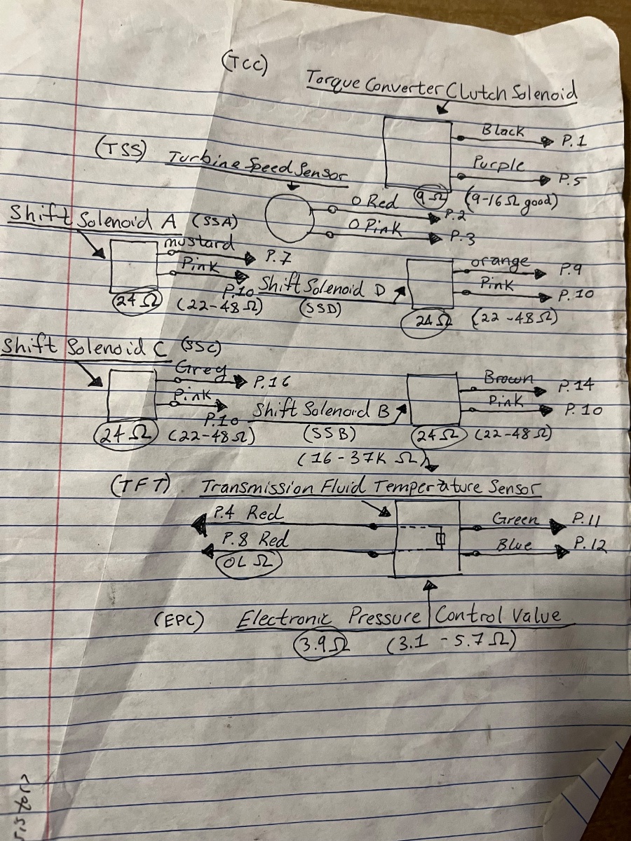

@Roert42 A few questions when you have the chance - I'm ordering resistors to now deal with the transmission codes - I assume the circled resistances are the "valid" values for the PCM?
Just hoping to double check I'm reading it all right:
TCC: 9 Ohms, P1 -> P5
TSS: (a problem for later) P2 -> P3
SSA: 24 Ohms, P7 -> P10
SSB: 24 Ohms, P14 -> P10
SSC: 24 Ohms, P16 -> P10
SSD: 24 Ohms, P9 -> P10
TFT: Not sure here, there's a resistor between P4 and P8, but then a "0 Ohms" next to it, is the EPC also a part of this?
EPC: 3.9 Ohms - not sure what pins, part of TFT?

The resistances that are circled are what I measured. The resistances that are in brackets are what the computer will recognize as an acceptable range.
The TFT is inside the EPC, that’s why they are combined in the drawing. The wires for the EPC go to pins 11-12.
The TFT read Open Line (OL) when I measured it. The acceptable range is between 16 ohms and 37k ohms.
