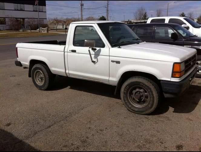

Forum member BlackBII’s 1989 Ford Ranger 4×4 has been a fascinating build to follow in our forum. To the unobservant eye, it probably looks like a Ford Ranger with nothing more than a lift and larger tires. But there’s so much more to it…
The Dana 28 front axle was replaced with a Dana 35 that now has 4.56 gears and an Aussie locker. BlackBII also came up with a Spindle Lock Nut Modification that you should check out HERE. BlackBII built a custom K-link steering setup, and upgraded to 1-ton tie rod ends. This setup is a beefier than the system Superlift use to offer.
