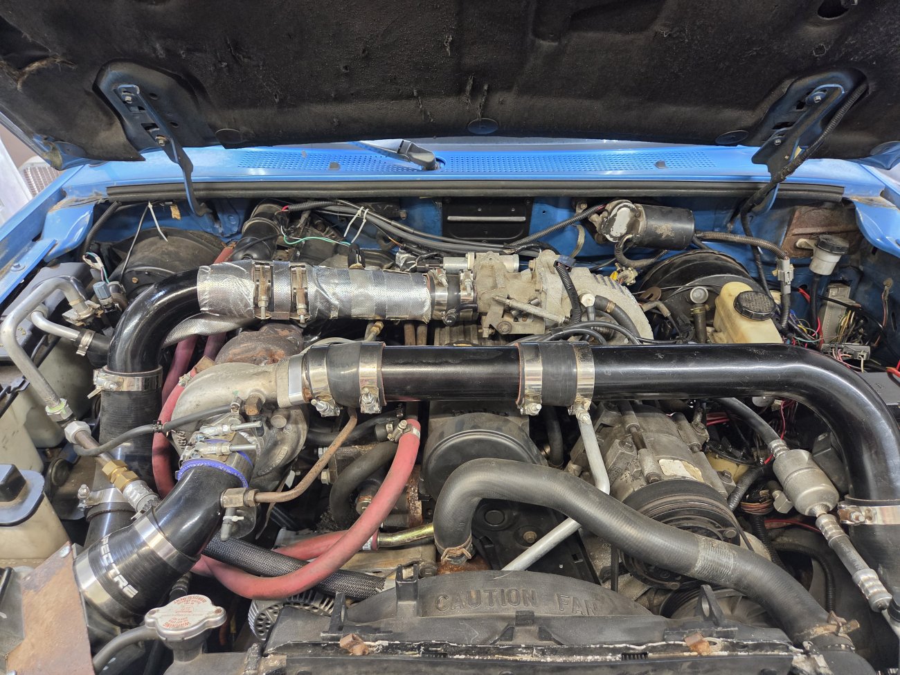

88 thunderbird ECM, and ranger runs sluggish. Get codes 22 and 54 KOEO and then 22 34 54 KOER. Replaced BP, TFI and it doesn't want to build boost but when it does it builds fast. I have the BIG VAm. Im lost
Well code 22 is the baro sensor, did you add one to your system? 54 is intake temp which I think is in the VAM but I don't remember
If all that's there I would verify you have those particular wires in the right spot

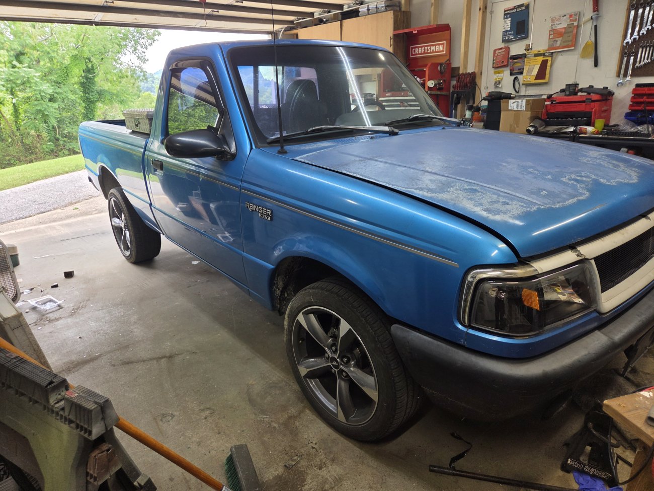

Hey uh... while we're figuring this out... where can we get some photos of this truck?

Scott you was right. Got the wiring redone. But it still is sluggish. 1 thing I have to replace clutch. I can't seem to get timing right. It doesn't want to run at 10. It likes it between 1-5.
When I use the old scanner with KOER before trying to reset timing it would die after WOT

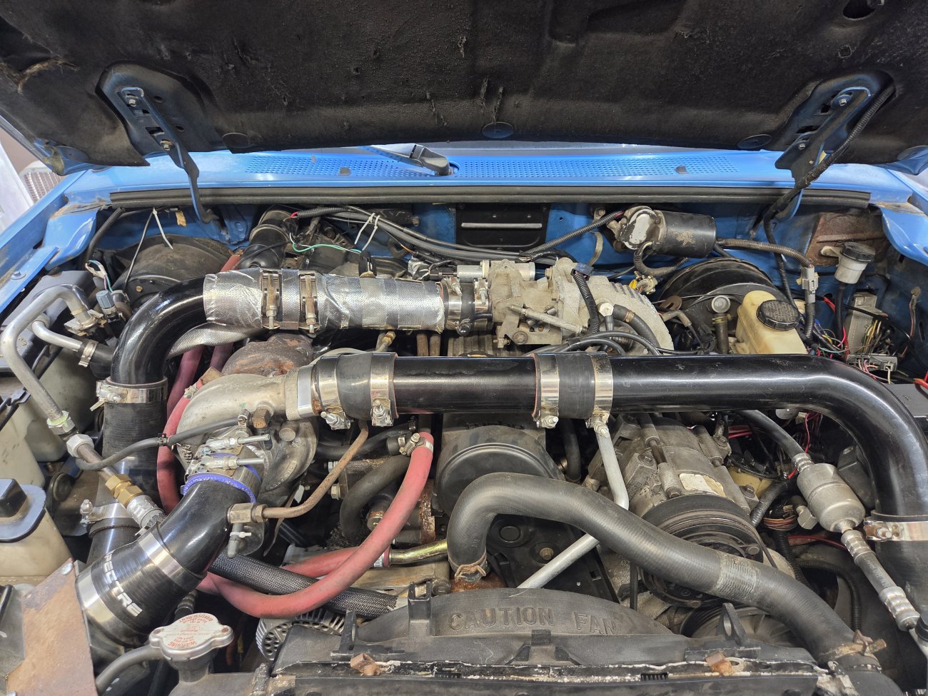

Engine compartment is jammed cause I have AC. LOL too hot in south without it
New codes. KOEO. 54, 81, 82, 83, 84 I blocked egr so it doesn't have one. So 54 ACT out of range high, 81 air management cicuit 2 failure.

Bruh I want your truck.
