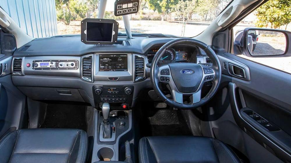

Interior:
The full interior cage was installed to maximize the safety of the crew during the offroad adventures. Steel tubes were nicely fitted along with the original interior, which allowed to maintain comfortable conditions for the drive and the passengers. Sport seats and 4-point Crow Harnesses are installed on the front and the back. Among other enhancements are iPad GPS mount intercoms, race radios from Rugged radios, SPOD switch panel and built-in 2-pound fire extinguisher from SafeCraft.
