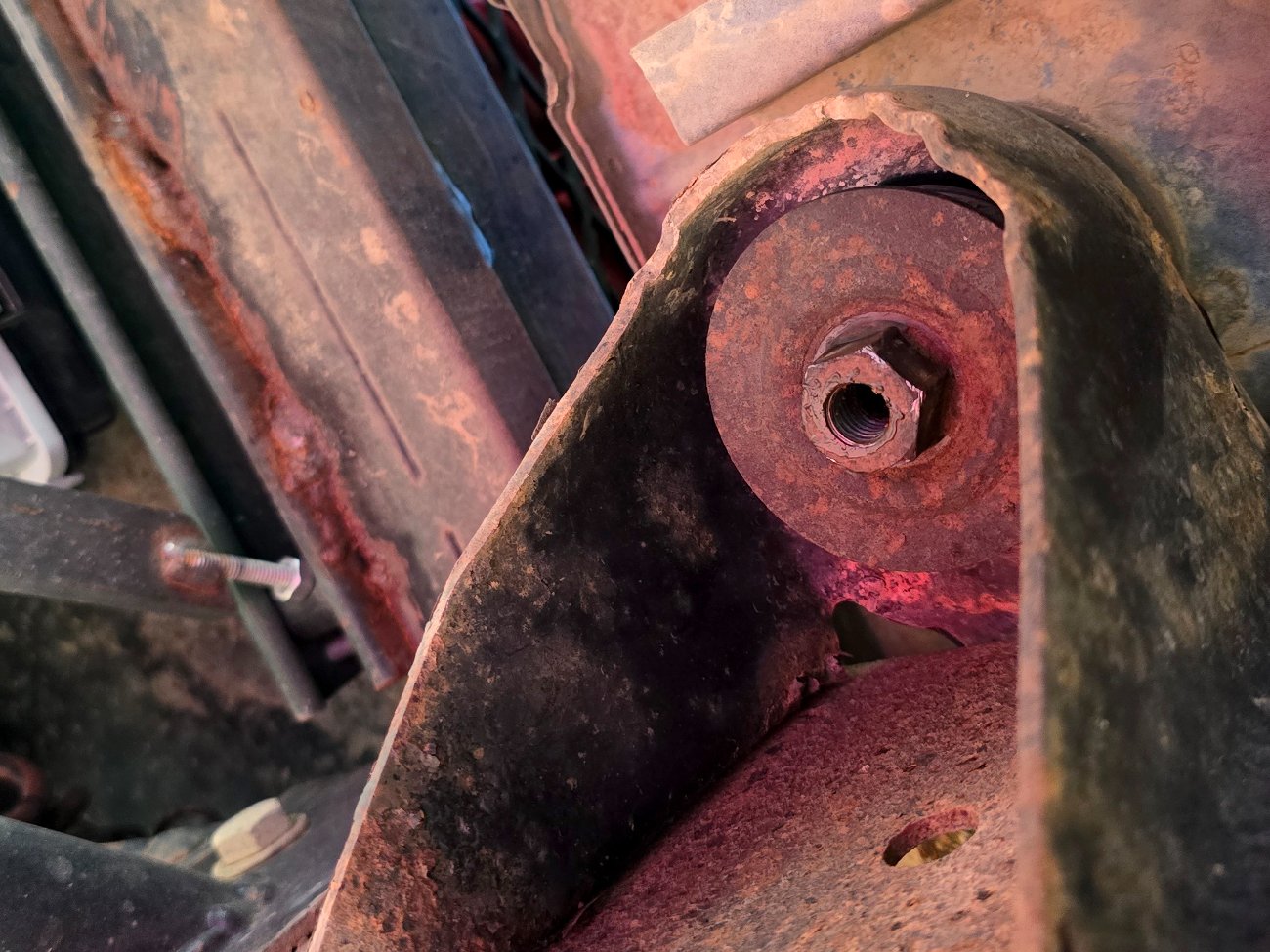

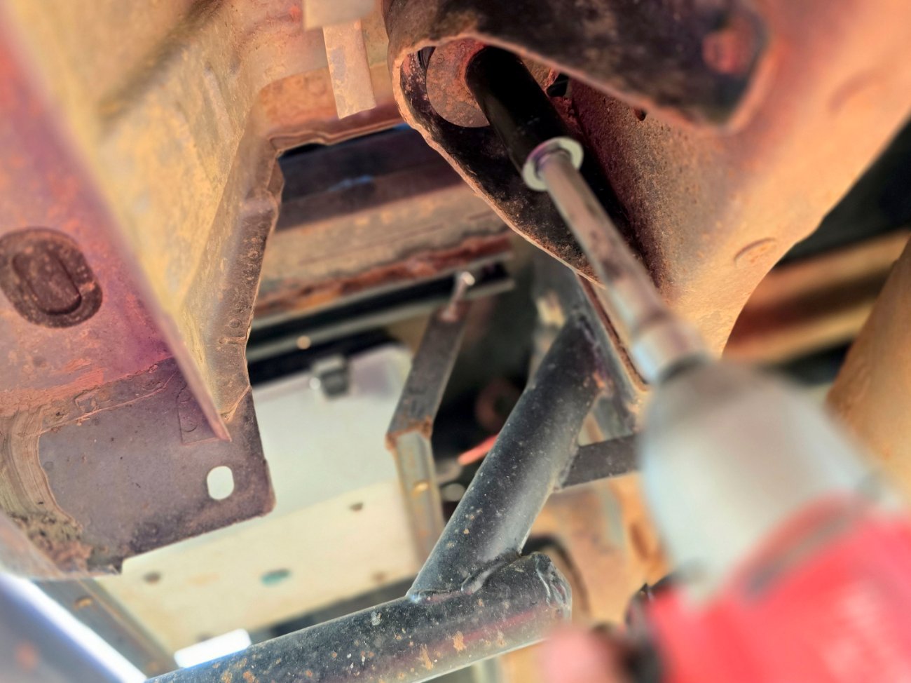

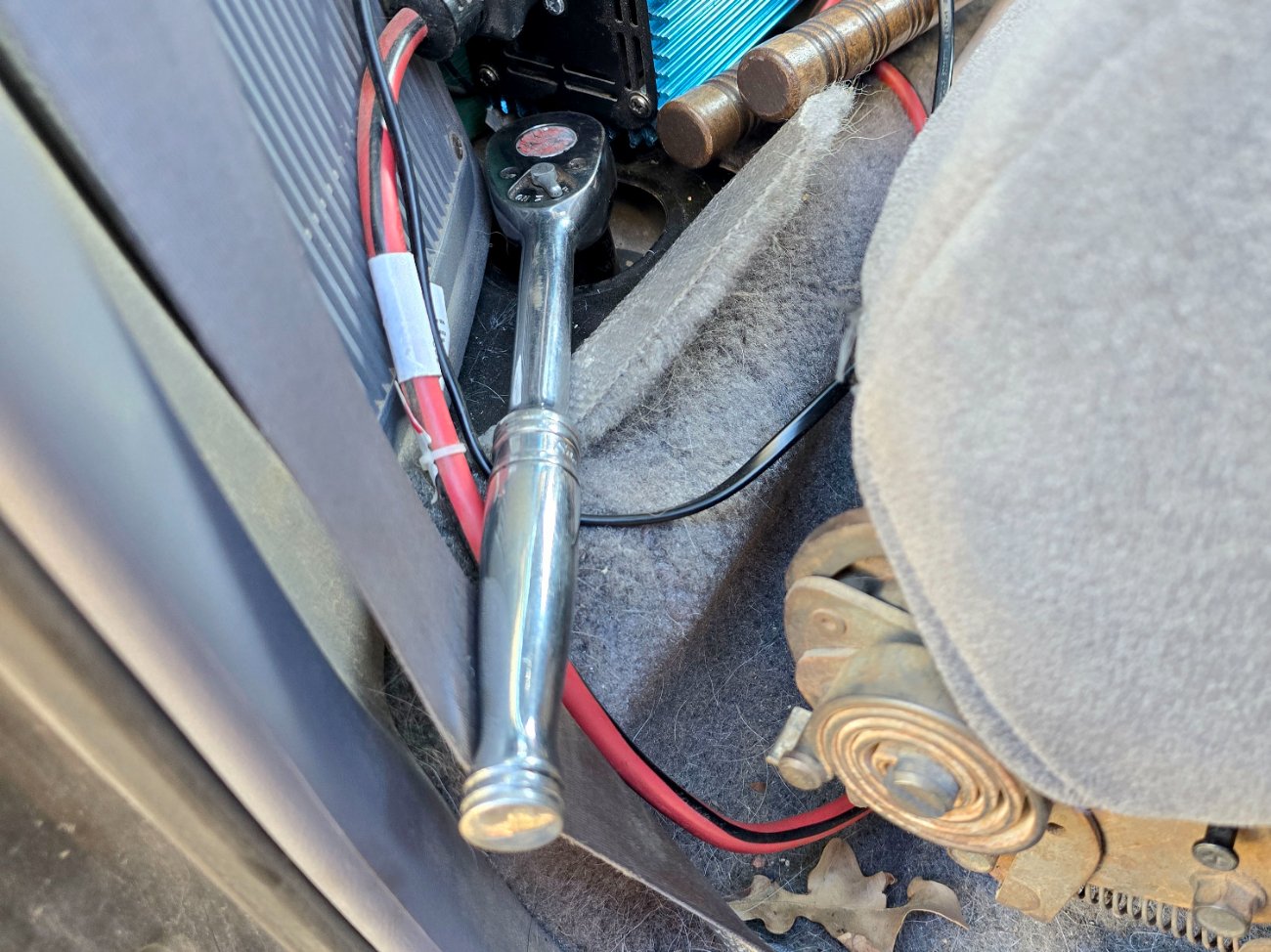

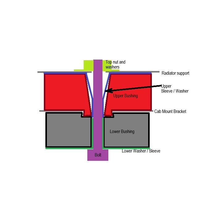

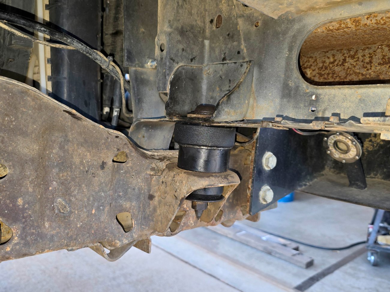

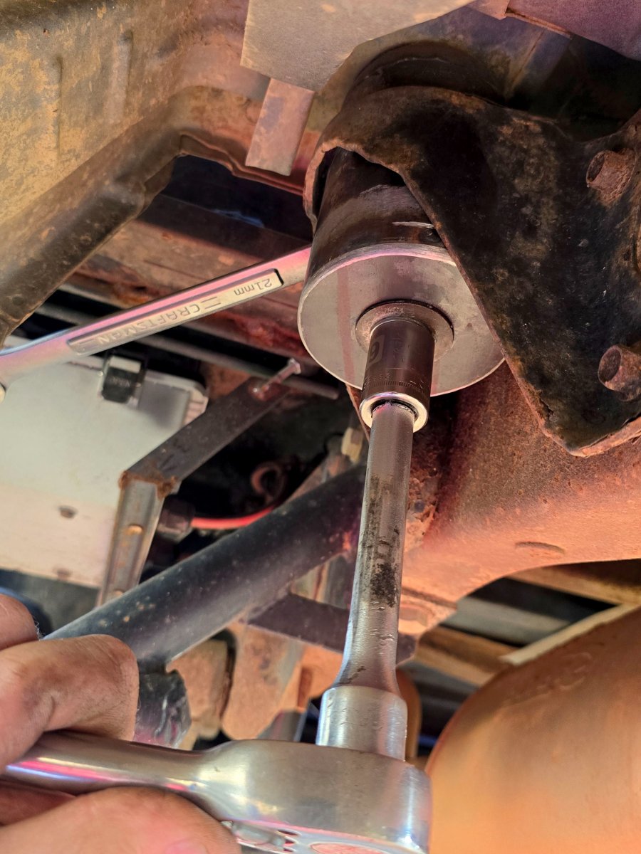

  6. For the middle and rear mounts, use the 18mm socket on the bolt head in the cab and the 21mm socket on the nut at the bottom. Loosen and remove the bolts. The nut on the bottom is attached to a washer and a sleeve that is pressed into another sleeve at the top of the bushing assembly. So, it will not fall out easily. See cutaway drawing of the assembly.

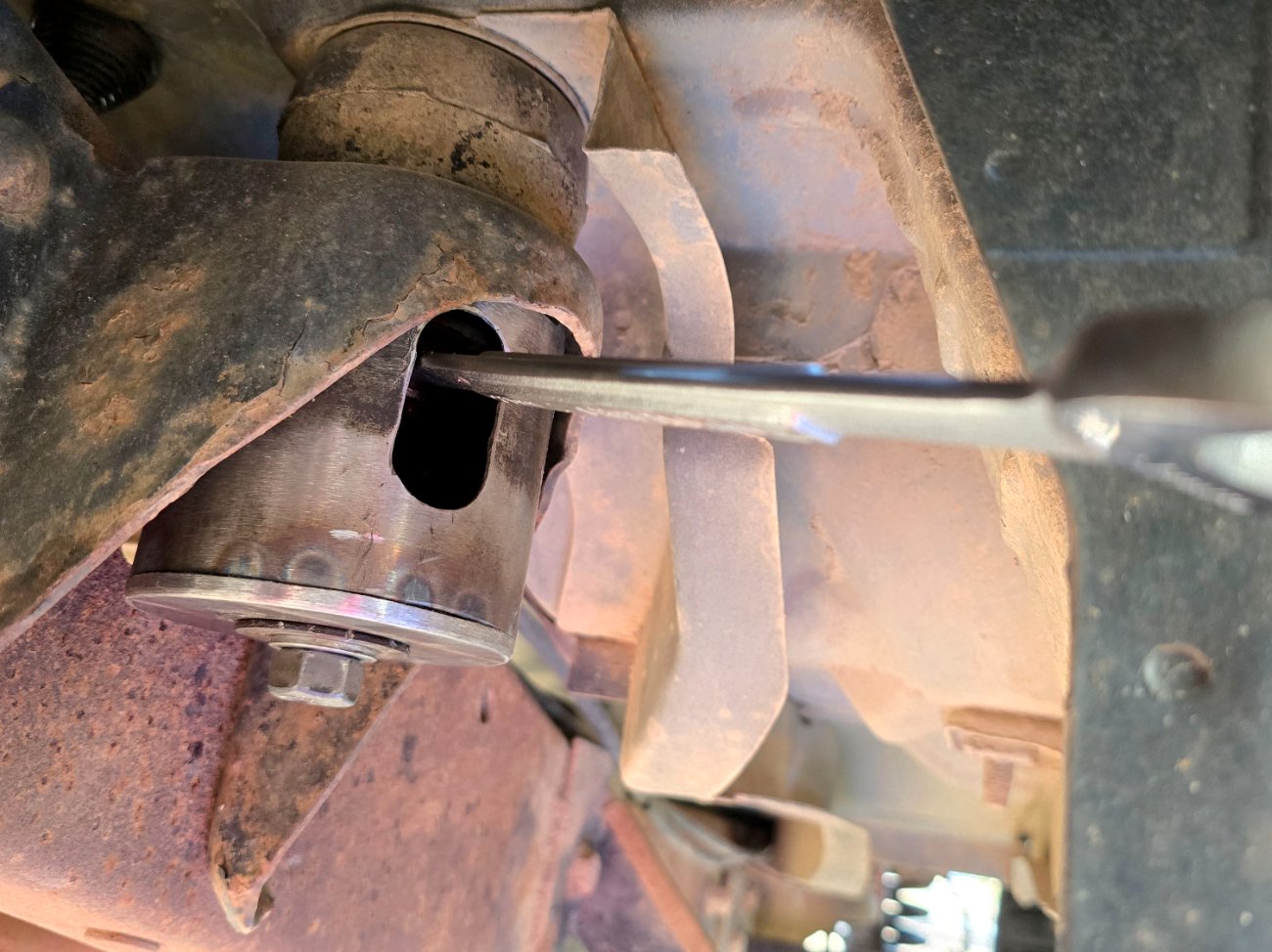

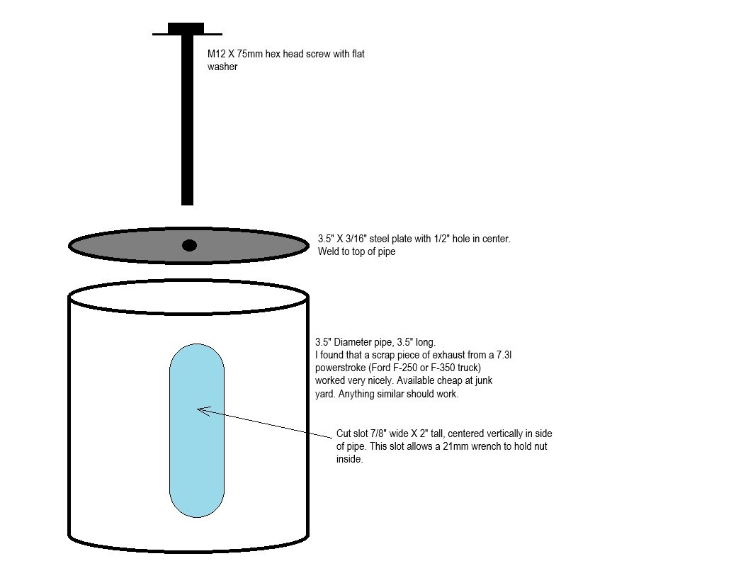

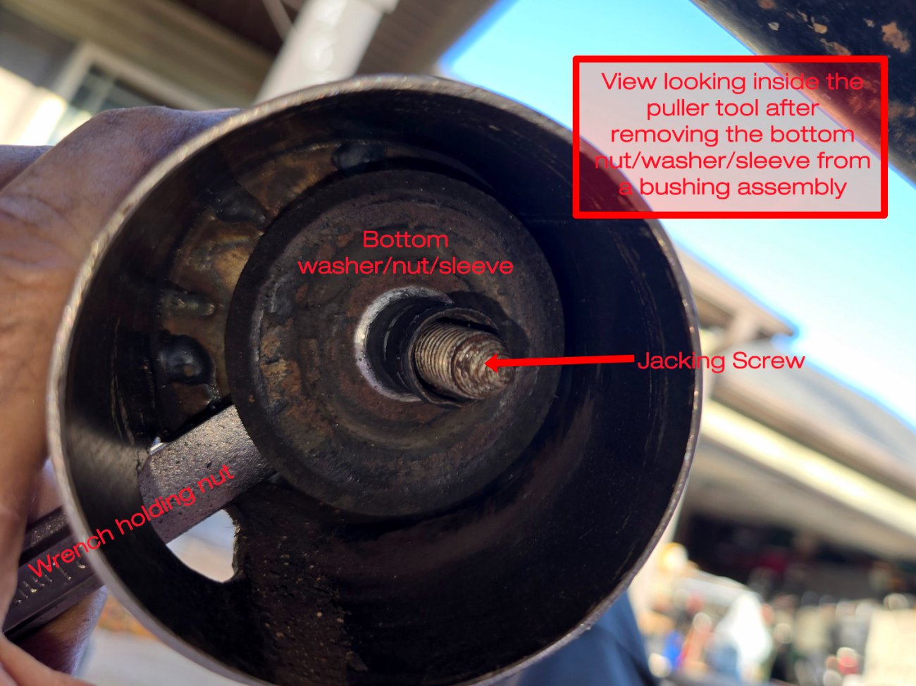

  7. Separate the lower and upper portions of the bushing and sleeve assembly from each other. This is a challenge. You may be able to pry them apart with pry bars. I found that to be very difficult and time consuming. I also tried beating them apart with hammer and punch with no success. So, I made a special puller to separate these pieces. Drawing and photos are in the “Special Puller” section at the end of this article. , TAKE NOTE OF WHICH PIECES GO IN EACH LOCATION. They are all different and fit in different locations – front / middle / rear.

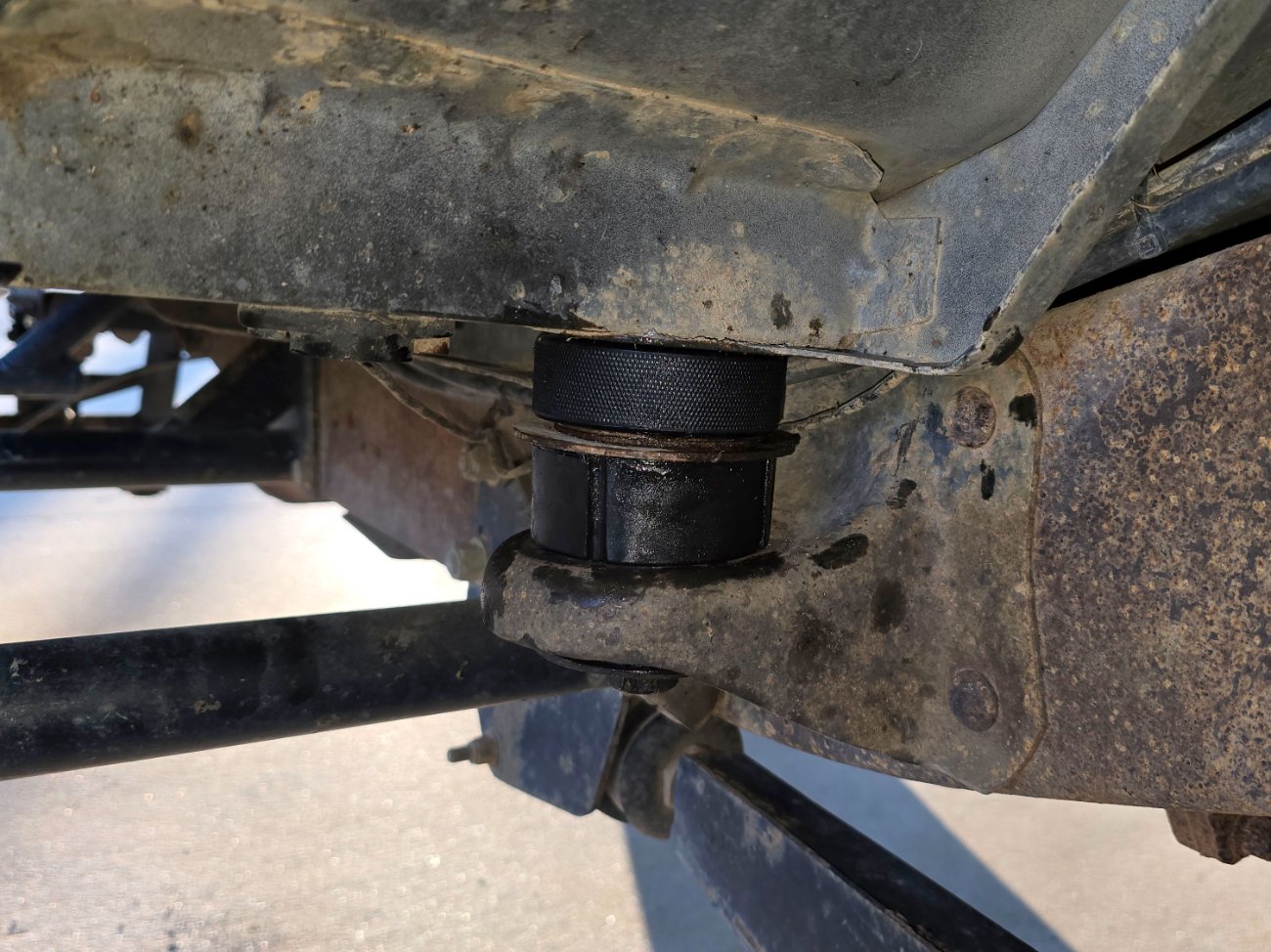

  11. Now, comes the "fun" part. I recommend having a friendly helper. It is well worth the price of buying his lunch. Again, there is an upper sleeve and a lower sleeve. This time, the upper sleeve has internal threads. The bolt is threaded into the upper sleeve.
  12. Use the pipe wrench to hold the flat washer attached to the upper sleeve. Then use the 15mm socket to remove the bolt. Sounds easy on paper. Doesn’t it?

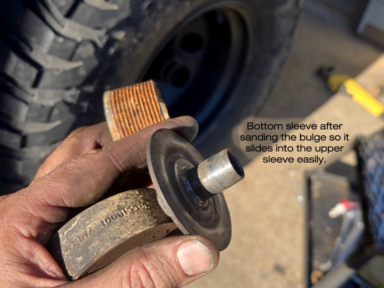

  15. To make things easier in the future, I drilled the threads out of the front upper sleeves. I will re-assemble with the bolt entering from the top, just like the middle and rear assemblies. The lower sleeves for the middle and rear seemed to have a bulge that made them fit tightly in their upper sleeves. I sanded that bulge away so the sleeves slid together easily.

Cab Mount Puller Tool;
Here is a simple sketch of the puller tool I made and showed up above. This is very useful for the middle and rear mounts. You have some leeway on what pipe to make it from. The key details are that the Inside Diameter must be large enough to fit over the bushings and metal washers. The Outside Diameter must be small enough to fit inside the cab mount brackets. The top plate must be large enough that it cannot slip inside the pipe. The plate doesn't even need to be round and you don't have to weld it together. It will just be more cumbersome to use if it is not welded.​

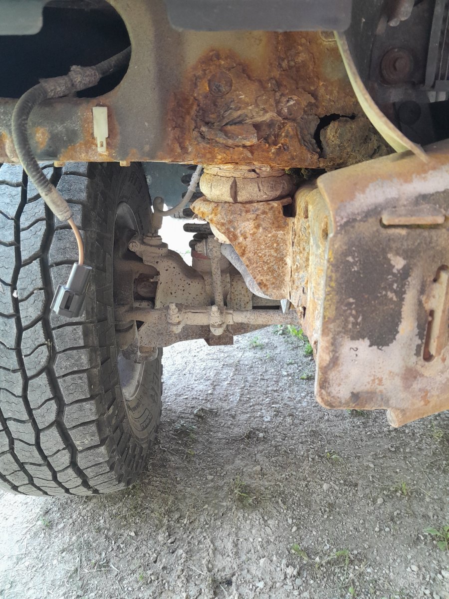

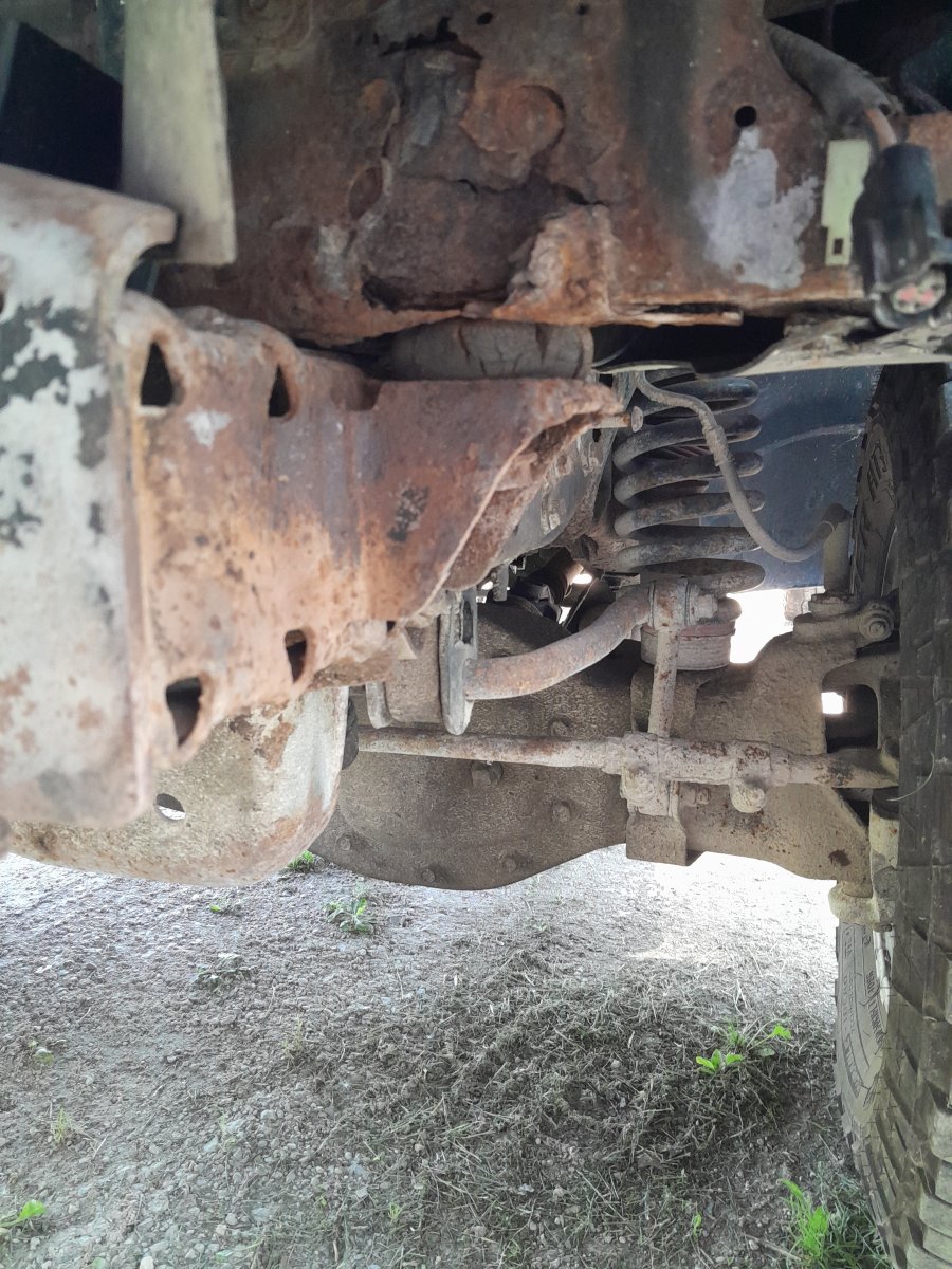

I have to replace the two front radiator core support bushings (i guess that's what you call 'em - images below. I already have the front bumper off and can access the bushings, but do I have to remove the core support or can I finagle the replacements in without that? I know it can't be that simple.
You need to loosen or remove the bolts from all the cab mounts so you can lift the cab high enough to get the bushings out. Check out the tech artical referenced earlier in this thread.
