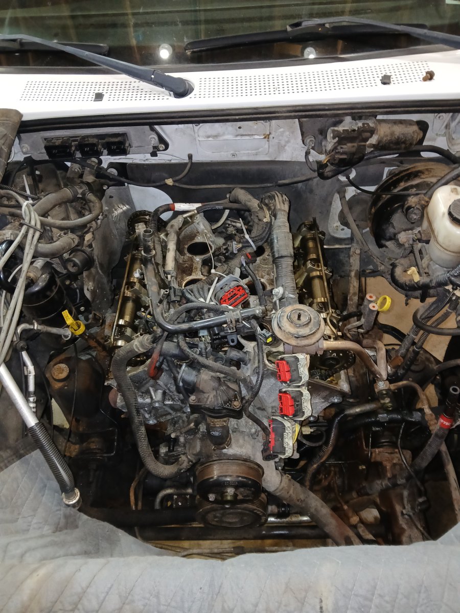

2007 4x4 king cab 4.0 removal for timing cassette replacement.
I cant determine how many bell housing bolts there are on this engine. Evidently there are 3 on the starter (I was able to get only one), I also was able to get the 2 bottom bolts as well as 2 of the side bolts. I am at a complete standstill and have NO IDEA how to proceed. I figured this would be a "no brainer" as I have removed engines in the past with no real issues. Both exhaust manifolds are now off too.
Thanks SenorNoob!
I now know exactly where the other 4 bolts are that have been hiding!
I am trying to get this out without removing the transmission too and I hope that with the exhaust manifolds and intake manifold out of the way I can reach them from the engine compartment. Its been 20 years since I've removed an engine from a vehicle and i KNOW it wasnt like this :ROFLMAO::ROFLMAO::ROFLMAO::ROFLMAO::ROFLMAO: I would love to NOT remove the heads in the truck cuz that looks like a bugger with with timing chains.
If I cant get to those bolts I am going to admit defeat.

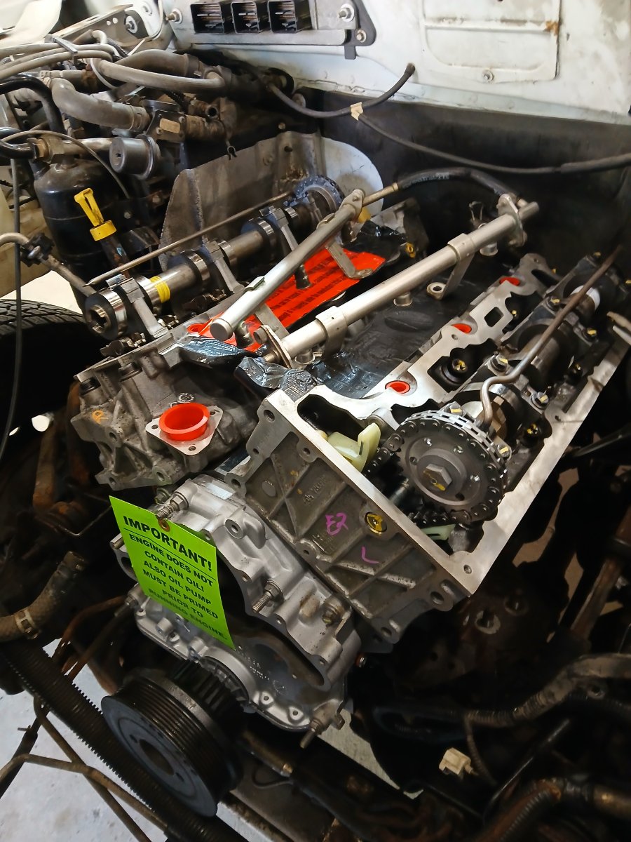

I gave up and took it to a local shop for a swap with a reman. When the new is installed I will put it back together, get the frame fluid filmed and drive it. I paid 800 for it and it's well worth a new engine.
Just too much of a ball buster for me
Some days, the best thing is being smart enough to know when you need help. I hope it goes well.
That's exactly what I thought when I started repeating attempts that had already frustrated me...
Not a battle I was gonna see thru to the end LOL!

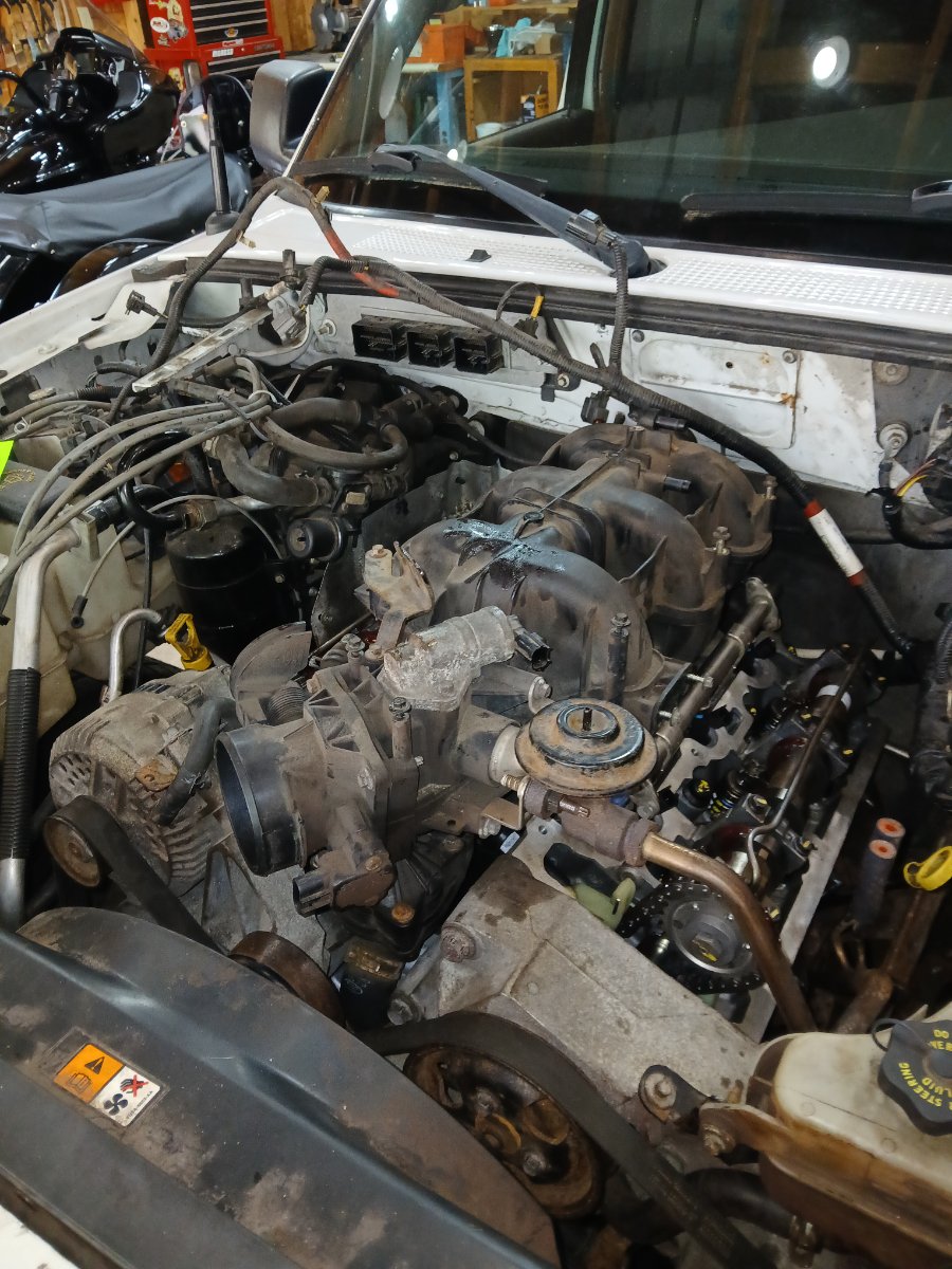

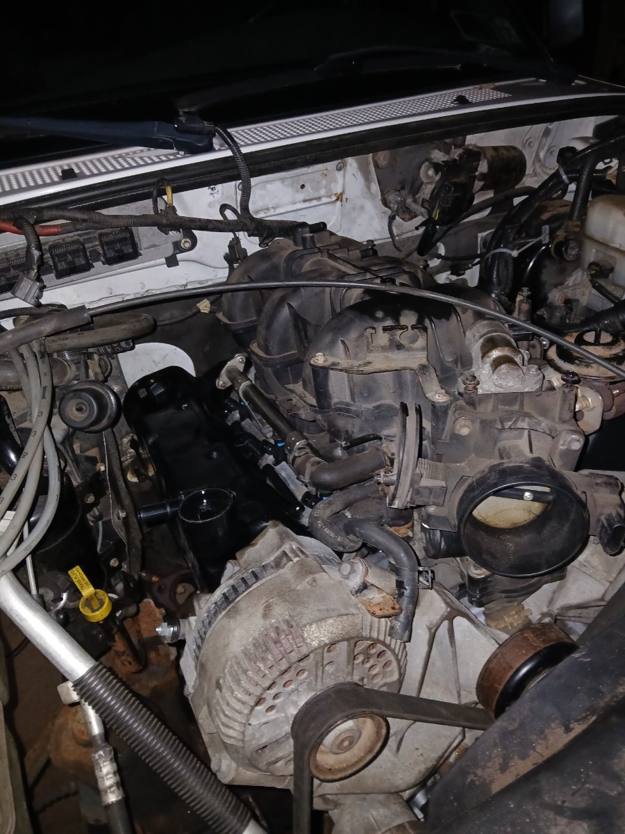

I will post pics of the progress when I get it back
Thanks!
Awesome can't wait to see you get it back together!
Engine was delivered Wednesday and will be going in very soon. Will.post some pics of the progress.
