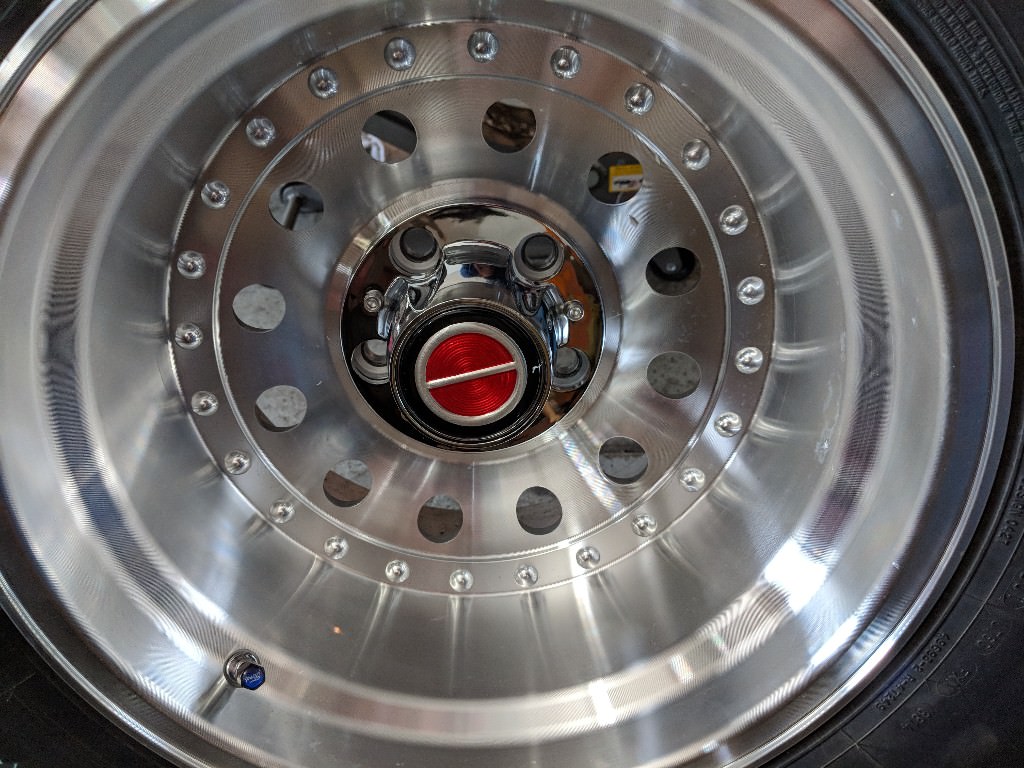

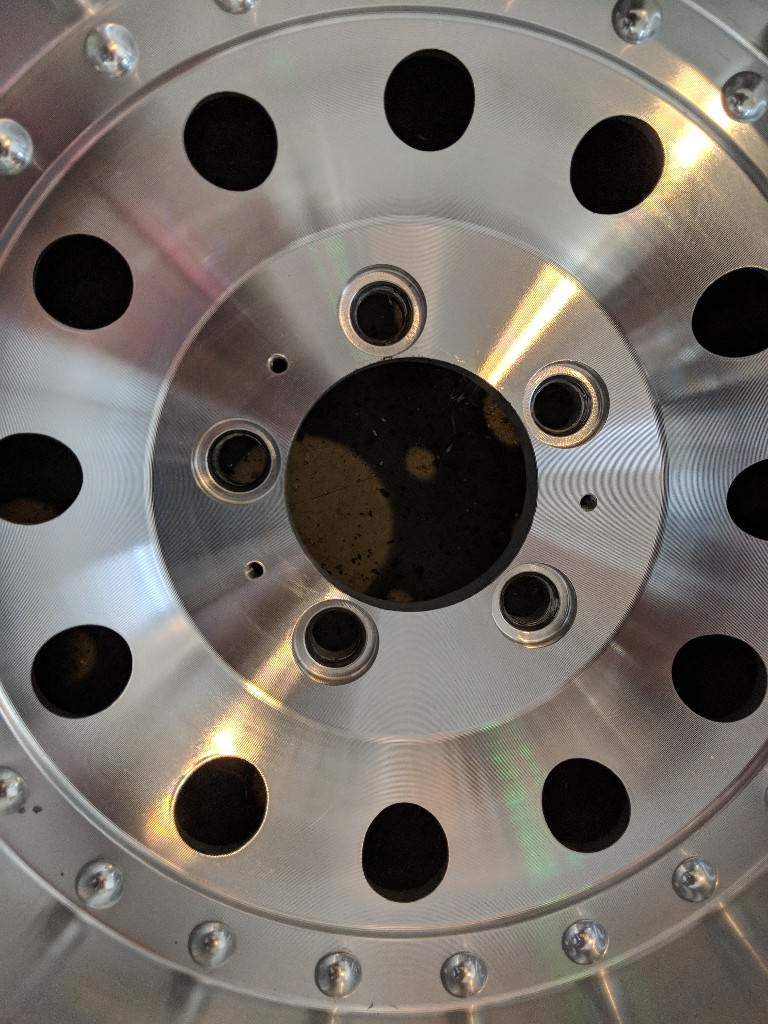

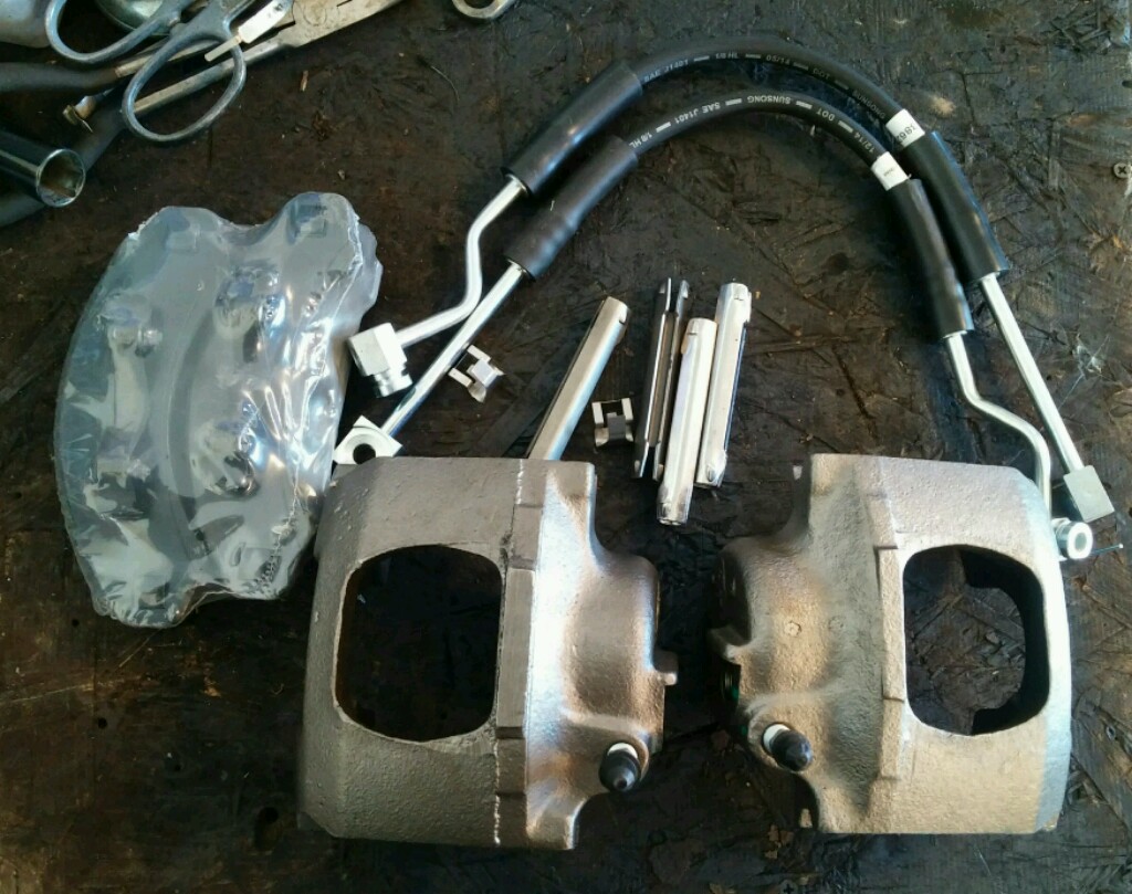

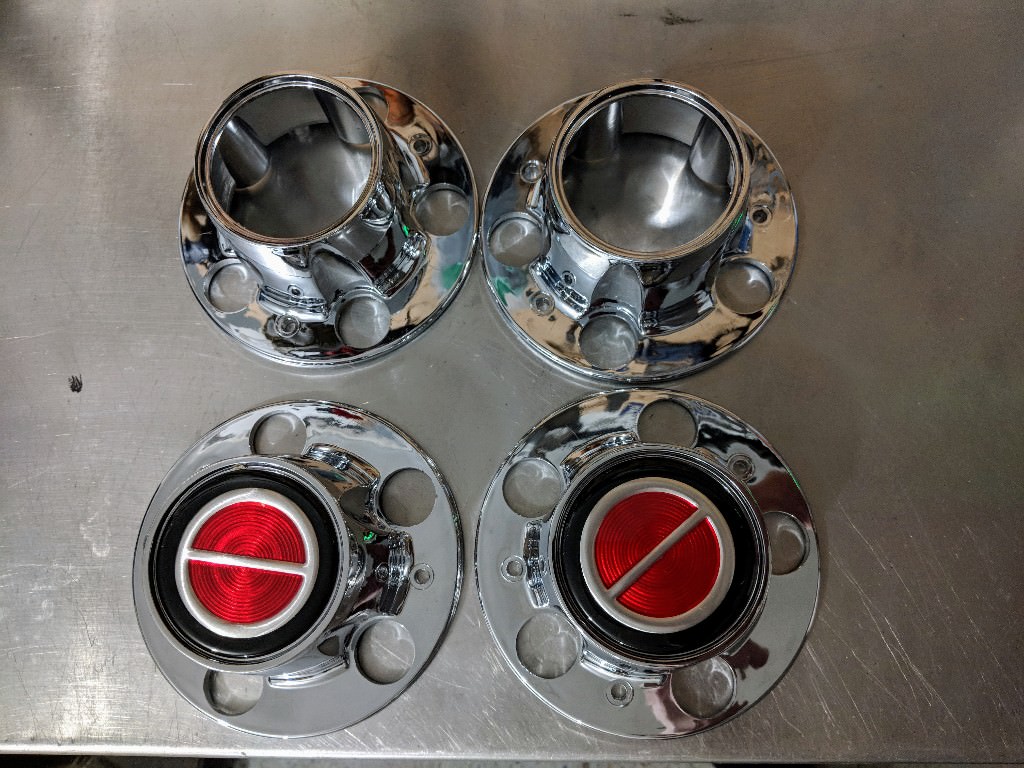

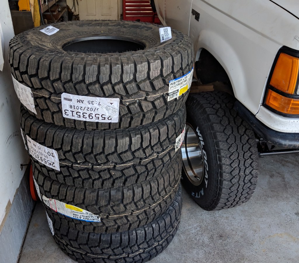

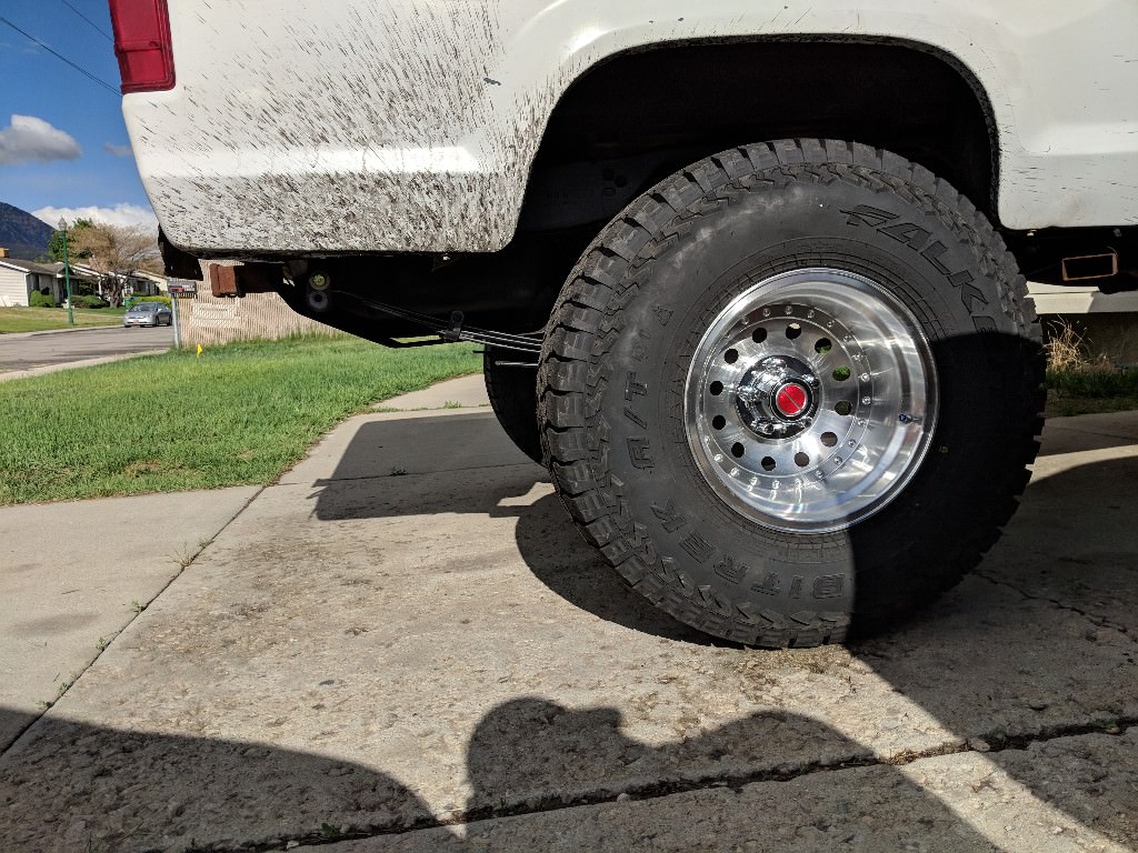

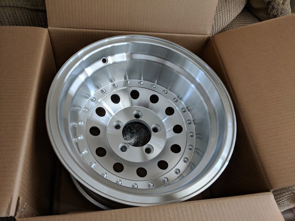

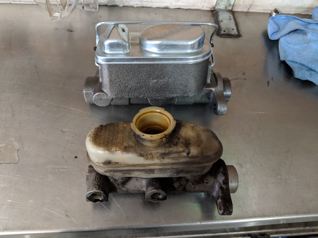

The power of the 4.0L combined with the 4.56 gears provides more than enough power to turn the 33-inch Falken Rubitrek tires on 15×10 American Racing Outlaw II wheels. The wheels use replica factory hub caps to give the truck a stock STX look. A 1985 F-350 Brake master cylinder upgrade helps bring the tires to a stop.

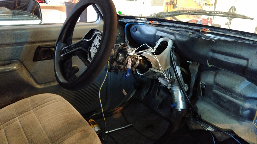

The steering has been upgraded to GM electric power steering. No annoying power steering pump whine here. To learn more about his steering set up, check out GM Electric Power Steering Upgrade.

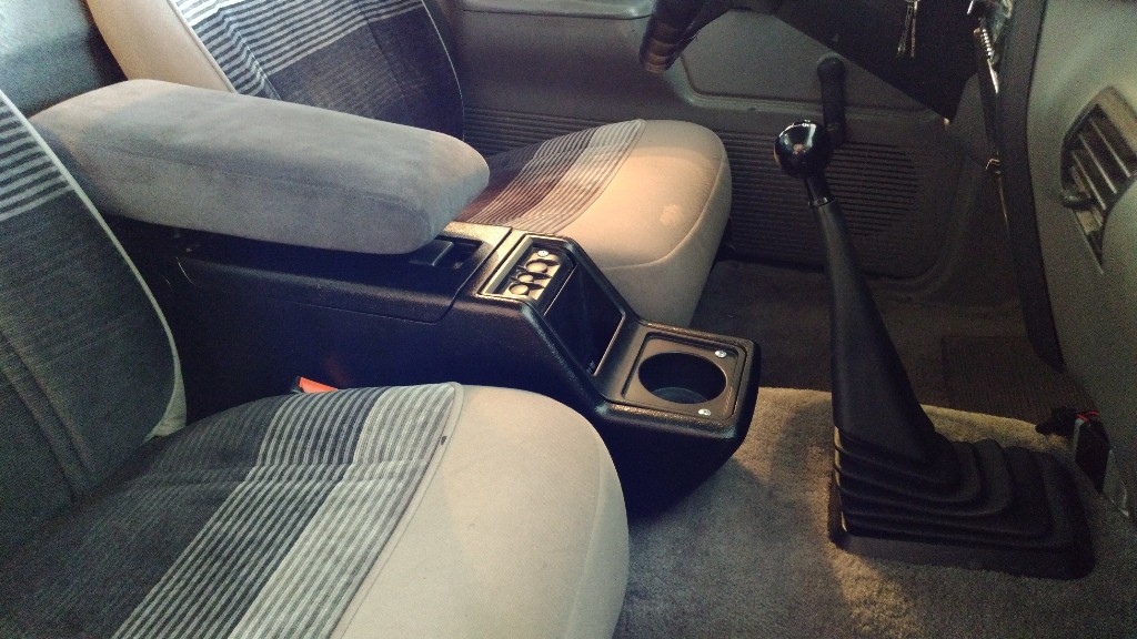

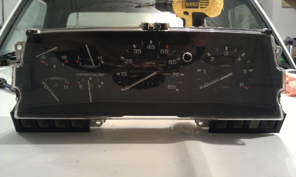

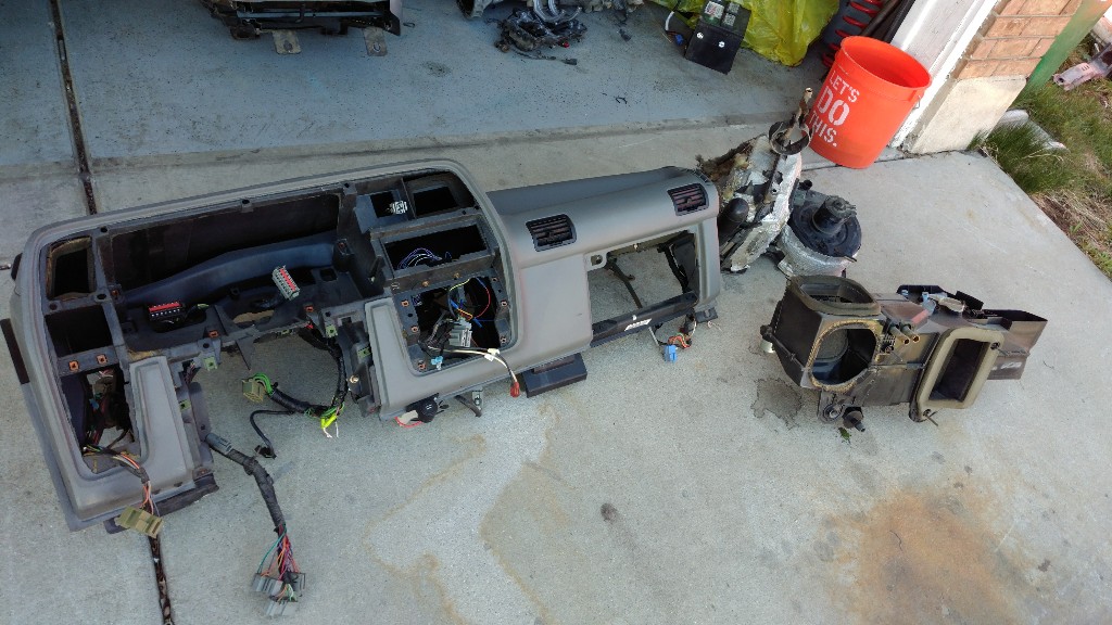

The interior received the bucket seats, center console, and dash from the Ford Explorer that donated the engine.
