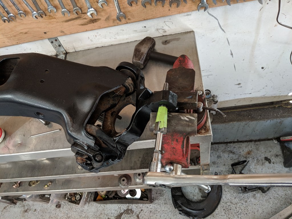

The Dana 28 front axle was replaced with a Dana 35 that now has 4.56 gears and an Aussie locker. BlackBII also came up with a Spindle Lock Nut Modification that you should check out HERE. BlackBII built a custom K-link steering setup, and upgraded to 1-ton tie rod ends. This setup is a beefier than the system Superlift use to offer.

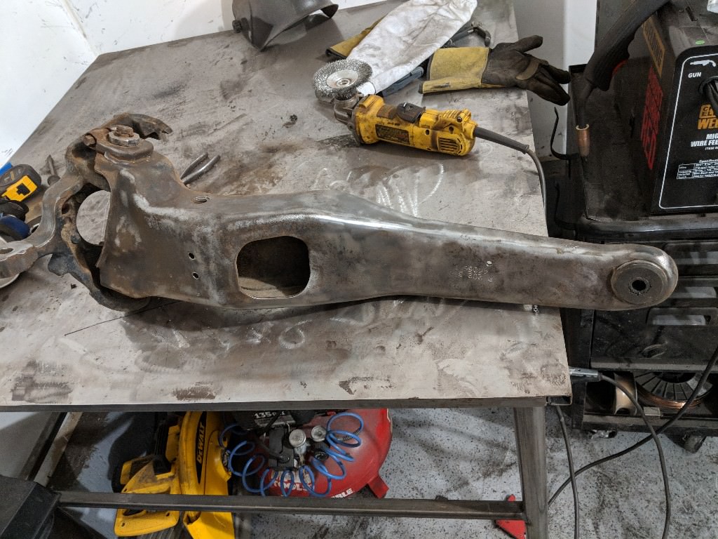

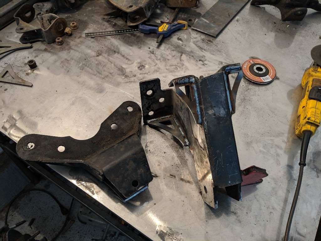

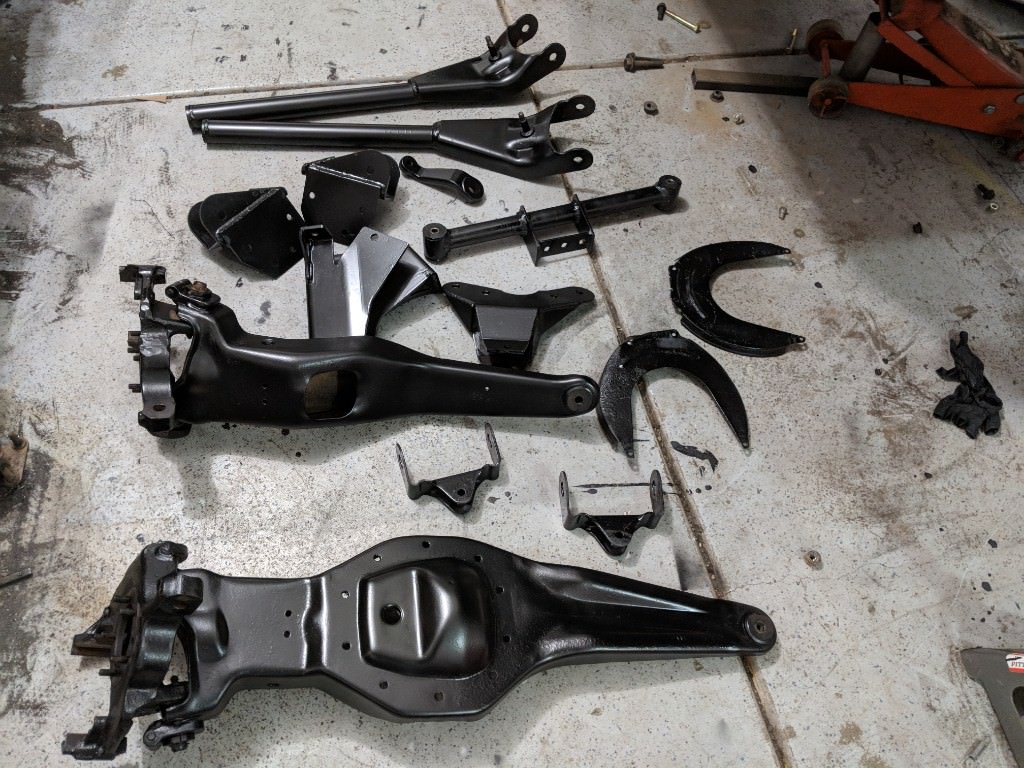

The radius arms were lengthened and feature SPC X-Axis joints. They secure to the frame with custom radius arm mounting brackets attached to a custom transmission crossmember. The ride is smoothed out by a set of Skyjacker M95 shocks (with Motorcraft stickers on them).

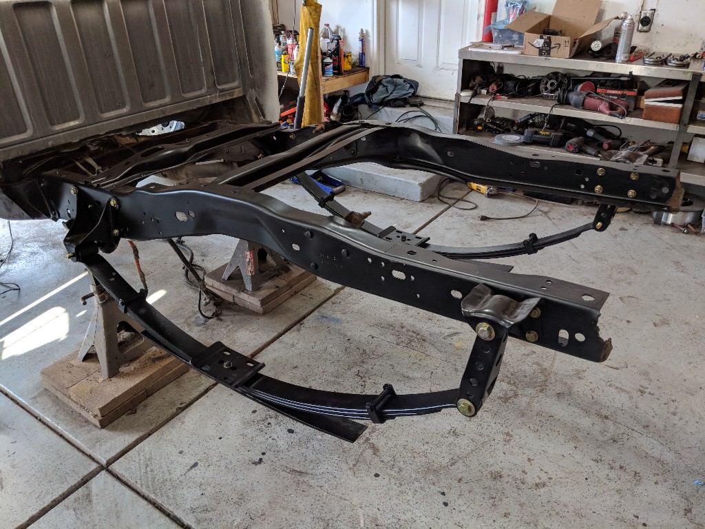

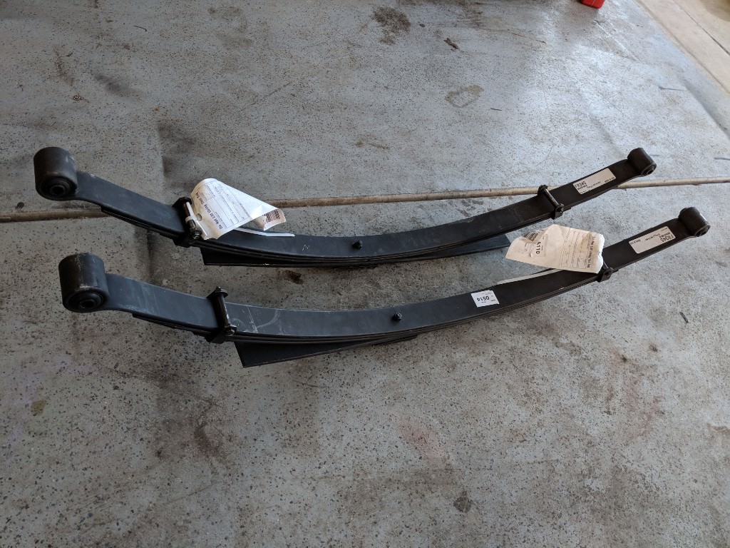

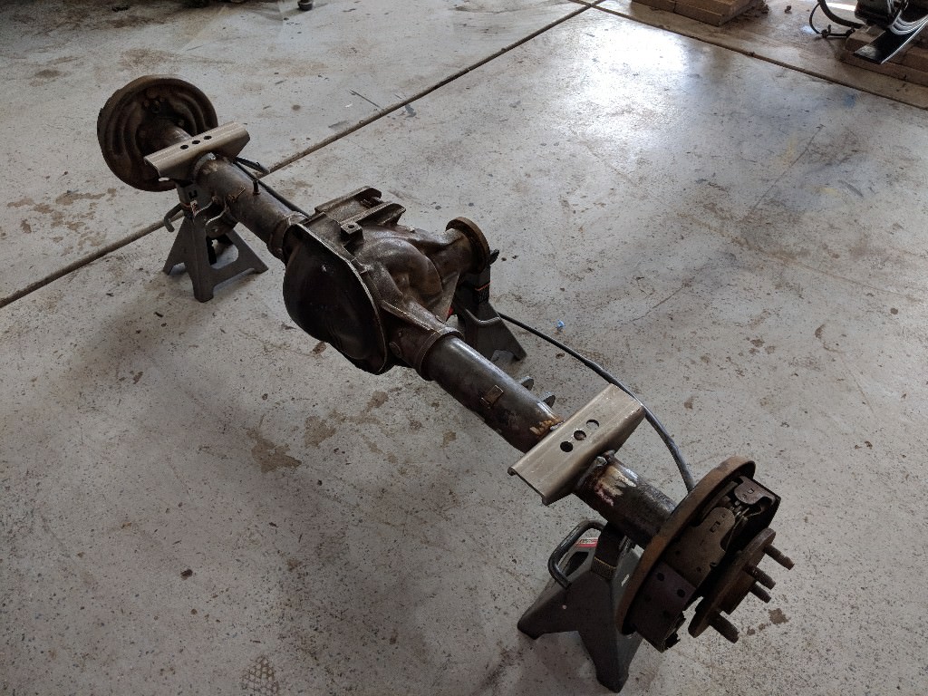

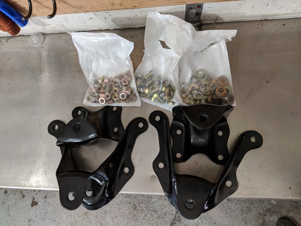

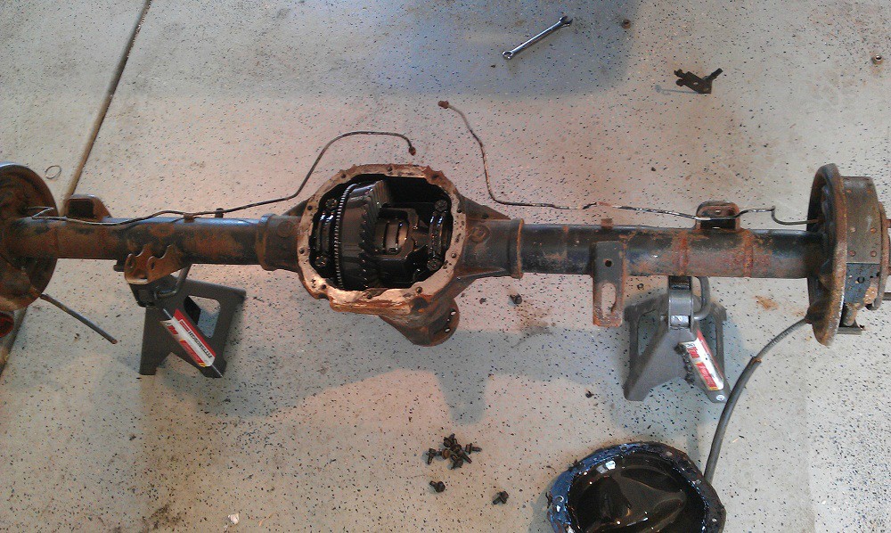

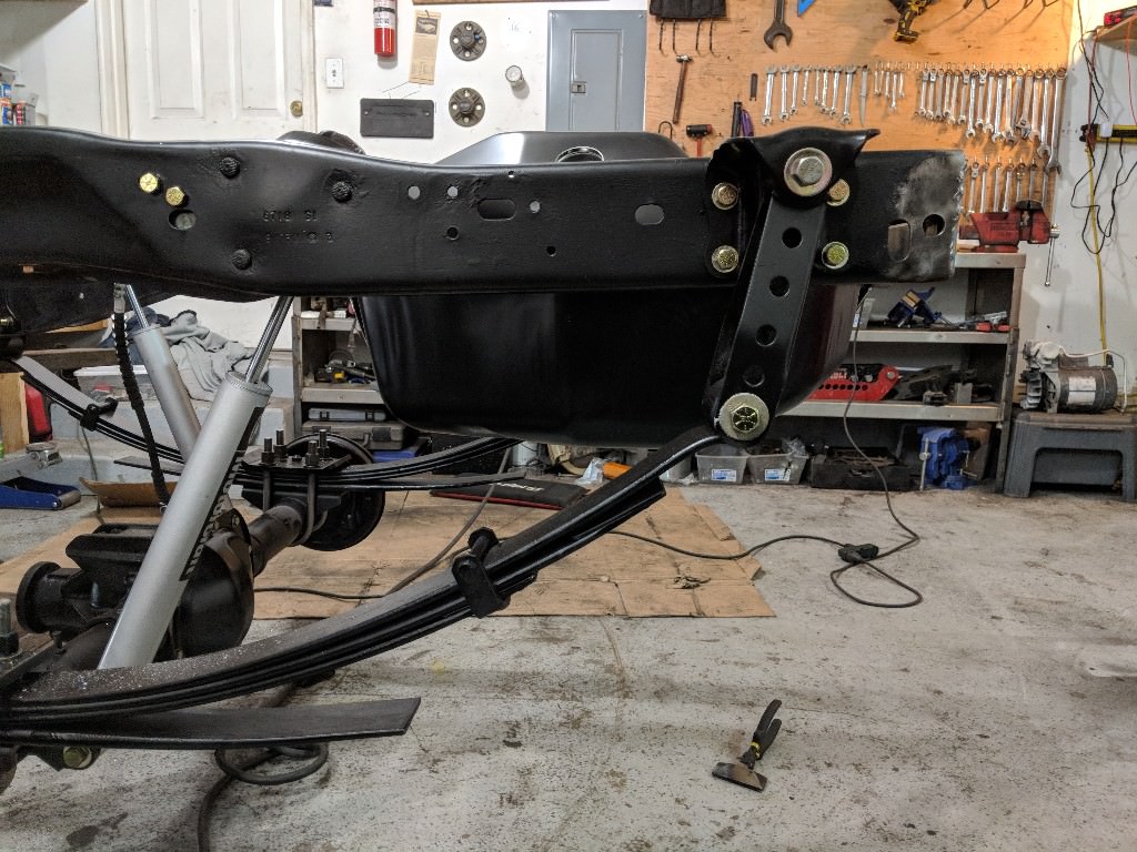

The Ford 7.5-inch rear axle features 4.56 gears and a Powertrax Lockright locker. The axle is mounted to a pair of 4-inch Skyjacker FR34S leaf springs, and uses a custom axle wrap bar to eliminate wheel hop. The gas tank was replaced with a Bronco II gas tank mounted between the rear frame rails. It’s protected by a stock Bronco II gas tank skid plate.

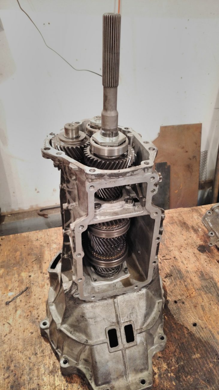

The original 2.3L was replaced with a 4.0L from a Ford Explorer. The 4.0L is backed by a M5OD ‘Hybrid’ (2.3 M5OD gears in a 4.0 M5OD) 5-speed transmission, and BW1354 transfer case.

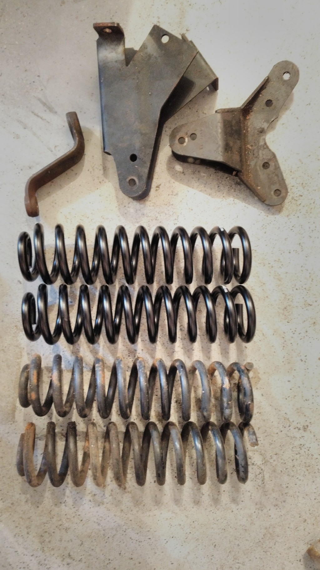

  • 6-inch Skyjacker Coils
  • 4-inch Superlift Axle Pivot brackets
  • Custom extended Radius arms with SPC X-Axis joints

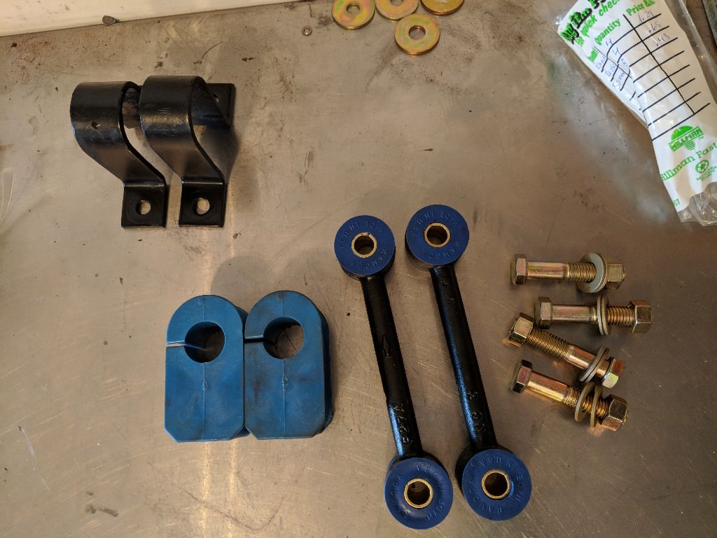

  • Polyurethane body mounts, leaf spring bushings, axle pivot bushings, sway bar bushings etc
