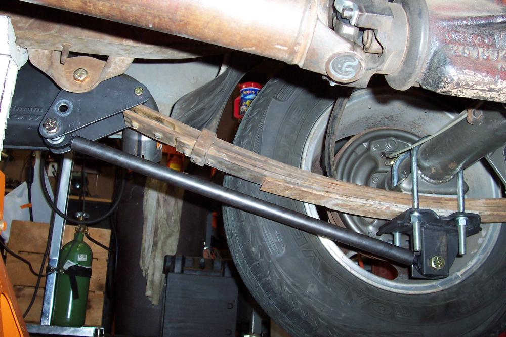

The power is sent through a Ford C6 automatic to a Mopar 8-3/4-inch differential housing. The differential uses 3.55 gears with a Sure Grip and Yukon axle shafts. He went with the Mopar differential over a Ford 9-inch or an 8.8-inch simply because he had several center sections, gears and specialty tools for those differentials already. He says that the 8-3/4-inch housing is just about the perfect width for a Ranger. Axle wrap is controlled by custom traction bars.
