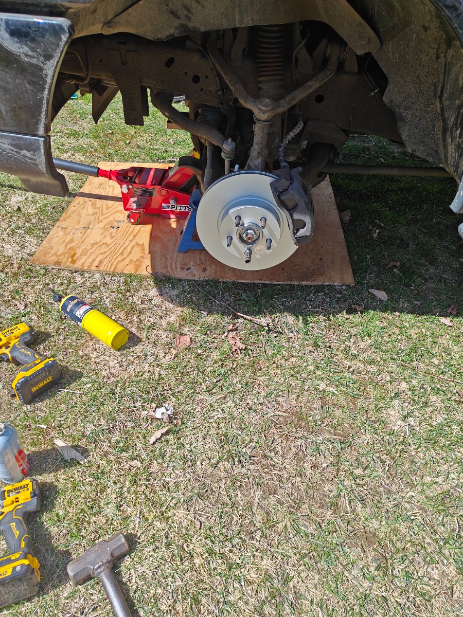

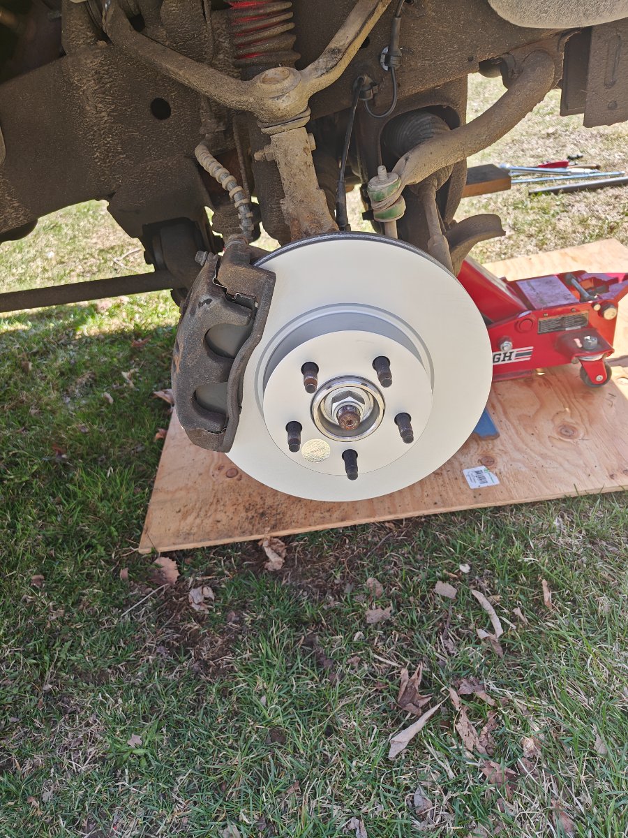

Bazinga! Fresh hubs and brakes on the front. I'm the near future I need to do back brakes and bleed all the brakes with fresh fluid and she should be good to go this year.
My old hubs were made in China replacements anyway so I didn't downgrade by swapping to MevoTech "made in Taiwan" hubs. Should last a month or two.🫪
