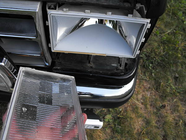

Okay, so we must separate the Refractor from the reflector.
Some may have done this by baking in the oven, however, on the gen 2 the entire headlamp assembly is constructed of plastic for the reflector and polycarbonate for the refractor. Not feeling the need to end up with a bubbled shapeless mass, I simply used and infinite (or infinite small) amount of patience, and pried the components apart.
Well, There’s your problem!
