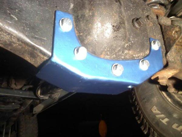

He also built a custom skid plate to protect the front Dana 35 differential.
