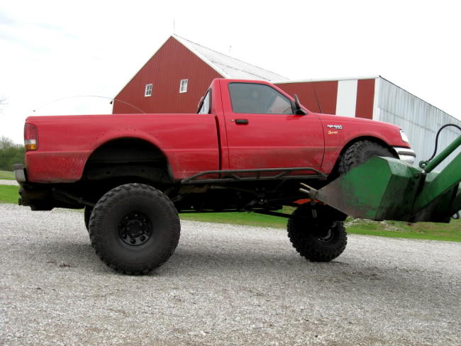

Bray Dierker and his brother/co-driver Brandon from north-central Illinois were the smooth operators of UA. Bray’s Ranger wasn’t extraordinary at rest sitting low on 37-inch BFGoodrich tires and packing a high-pinion Dana 44 front and Ford 8.8 rear, but when needed this truck tiptoed over obstacles with more grace and skill than the child of a ninja and ballerina. The Ranger flat-out works, and Bray drives it well. No trailer queen, this truck is Bray’s daily driver and weekend wheeler, requiring simple tough components and a smooth operator who can drive to keep it alive all week long.
So what makes this Ford Ranger so unique? Here’s the specifications:
Drivetrain:
- Engine: 1997 Ford Explorer 4.0L V-6 (truck originally had a 3.0L V6)
- Transmission: M5OD manual transmission
- Transfer Case: BW1350/1354 doubler
- Front Axle: Narrowed 1979 Ford Bronco HP Dana 44, Yukon 4340 Yukon shafts, 4.56 gears, spool
- Rear Axle: 1999 31-spline Ford Explorer 8.8, disc brakes, Dutchman 1541 alloy shafts, 4.56 gears, welded
- Steering: Ford power steering with custom Branik Hi-steer
Suspension:
- Springs & Such: Wildhorses 3-1/2 inch Early Bronco springs up front, Chevy 63-inch leaf springs in rear with 6400 shackles, custom radius arms, approximately 5-inches of lift
- Tires & Wheels: 37×12.50R17 BFGoodrich KM2s on 17×8.5 Trail Read HD Beadlocks with Slim Rings
- Other: Internal cage, Bronco II gas tank, fabricated sliders and tube doors
All the custom parts (steering, extended radius arms, sliders, tube doors, etc) were built by Bray.

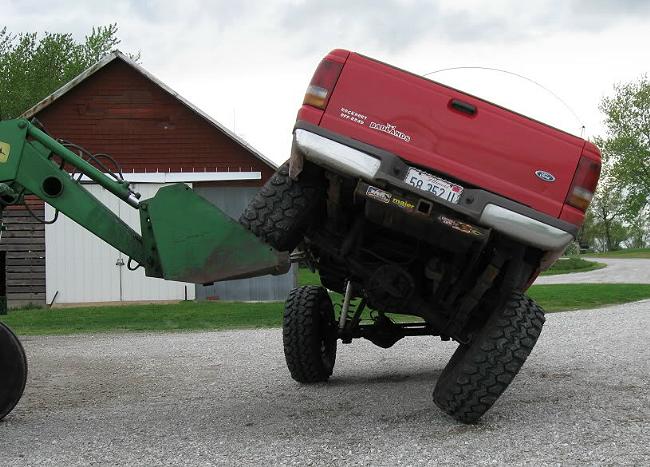

BW1350/1354 doubler
Why the extra gas cap at the rear of the bed? When Bray added the dual transfer case setup, the stock gas tank was in the way. Bray ditched it and replaced it with a Bronco II gas tank mounted behind the rear axle.
