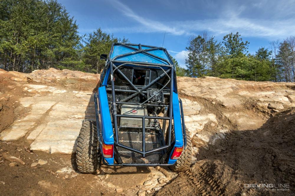

A triangulated four-link using 2.00 x 3/8-inch DOM lowers and 1.5 x ¼-inch wall uppers secure the rear axle in place. A Currie Antirock sway bar adds a touch of stability, while 14-inch-travel 2.5 Fox air shocks suspend the rig. Since driveshafts are often at the mercy of the terrain below, Treadway had a custom ¼-inch wall rear ‘shaft built by Oliver’s Driveshafts.

The 115-inch wheelbase and 4,525-pound weight allow the Ranger to stay nimble and stable on the trail. In case the belly does see daylight, a custom 1¾-inch, 0.120-wall DOM exo-cage will keep the occupants safe.
