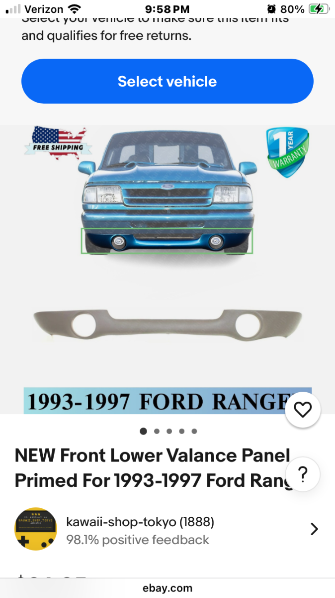

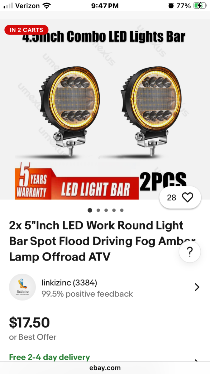

The driving light valence came in for the 97.
The Amber halogen driving lambs I’ve had forever are about a quarter inch too large for the light holes, so I ordered these.
I really don’t like them, but they’re the only thing I can find. I couldn’t even find anything at two or 3 or 4 times the price.
Again, the reason I’m doing this is because the eyes aren’t as sharp at night, and when I drove to nationals, the high beams just weren’t getting it by themselves. So I want some bright driving lamps pointed low to track the lines on the road.
When those lights come in, I’m going to compare the beam at night with my halogens. I’ve got a feeling I’m going to make my Amber halogens work….

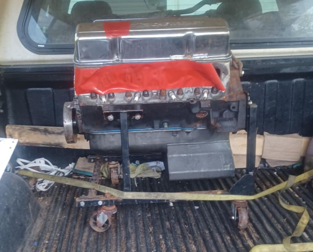

New bullet on the way - actually my brother's spare engine for his Super/Gas Vega. 12:1 385ci, AFR 227 heads, Super Victor intake and a giant solid flat tappet that's gone 9.60 in a 2300 lb Vega. Pretty sure it's got a lot more HP than my blown up 355.

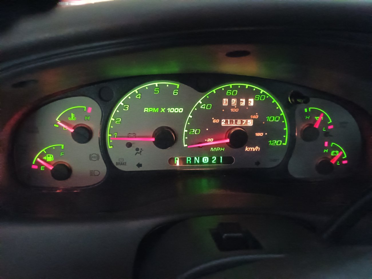

Fixed the two rear suicide doors so they actually pop open now with just the handles. And all new bulbs in the instrument cluster!

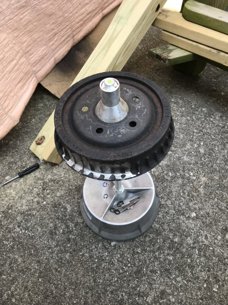

on the 2005 2wd I've been chasing a wheel vibration from about 62+ mph without much luck.
after several wheel balancing's I thought I'd check the drums.
both cheap-O 9" were way out.
Didn't have much to lose so I gave it a whirl.
had to set the drum on numerous times to get a consistent reading, without the leveling ring it's hard to get the drum on properly.
drums alone aren't heavy enough to depress the leveling ring, removed it for this.
seemed to help a little. I kept accelerating thru the vibrations and at 80 everything sort of smoothed out. not completely, but definitely sort-of.
unfortunately, my 2005 with 378,000+ miles probably should not be driven at 80.
surprisingly removing that much metal didn't totally screw things up, I was expecting really bad results.
I was wondering if the balancer was true and accurate. put a known good wheel from the 2019 Edge on and it registered as balanced.
