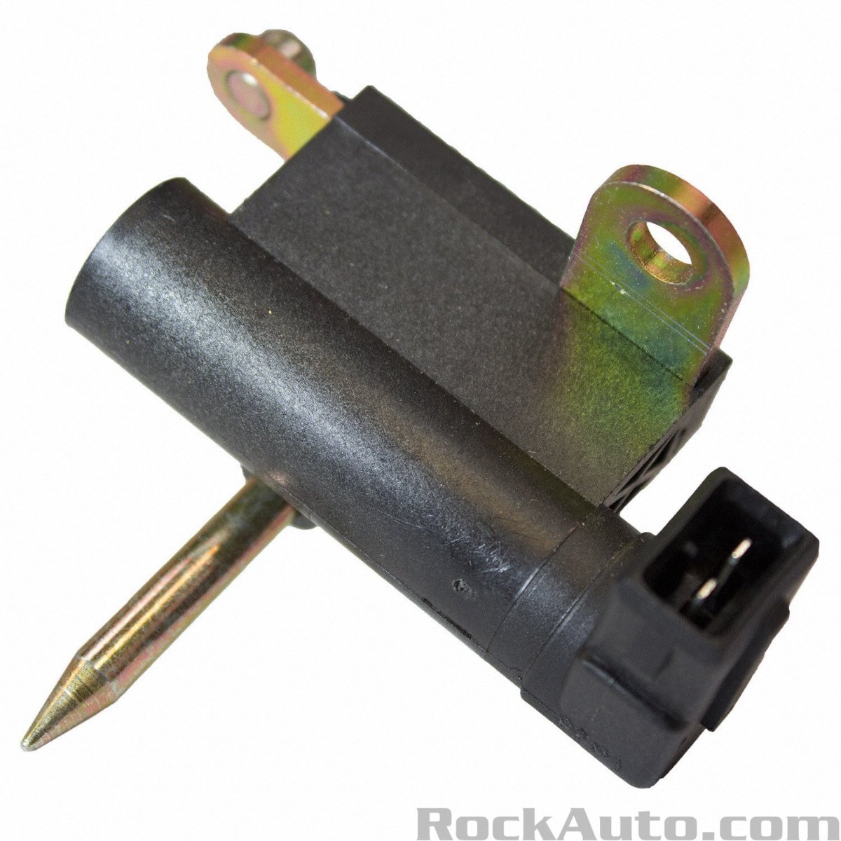

3. You said you replaced the pip, what did you replace? was it this

And yes that is exactly what I replaced.
